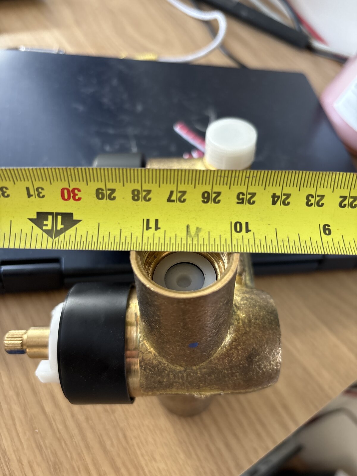

Hi all. What are my options for going from this:
To a 15mm speedfit but turning each pipe 90 degrees? I'm a bit short on space horizontally and asking the plastic pipes to bend through 90 is a bit much
3/4 nipple then 3/4-to-15mm bent tap connector (are they a thing?)
3/4 Compression reducer to a short length of 15mm copper and a speed fit elbow ?
3/4 x 15mm male iron, bit of copper then speedfit elbow or speedfit stem elbow straight into male iron.
