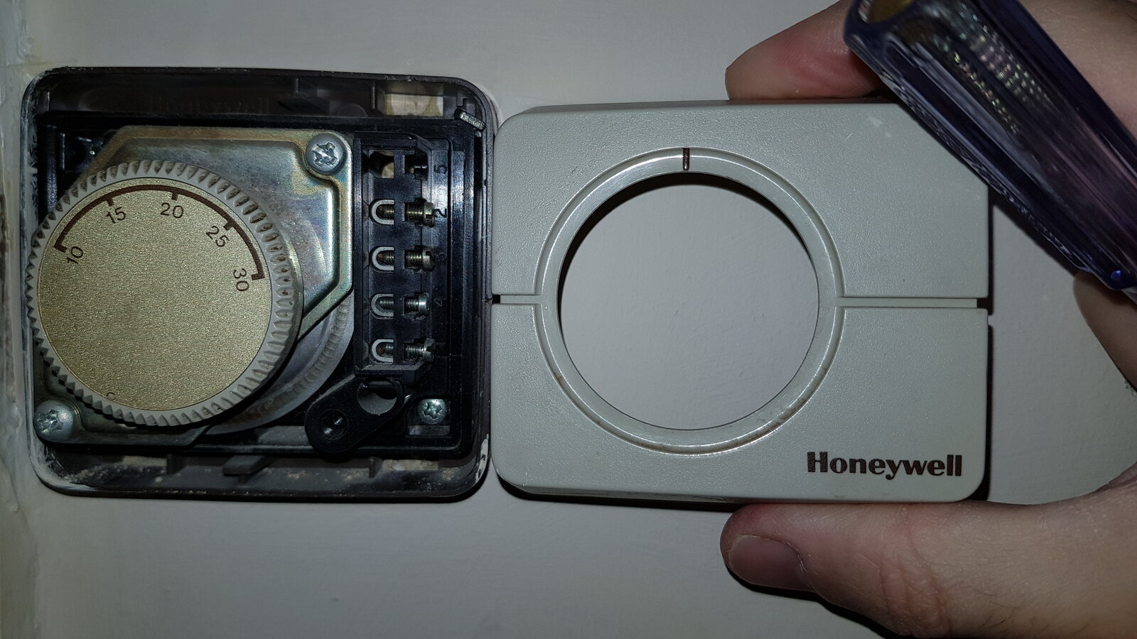

There is an old Honeywell stat fixed in a downstairs hallway (guessing its 1980s). Taking the cover off it reveals that it is connected with 3 wires. When i leave the heating control on the programmer to 'on', the stat does seem to flick the boiler on and off, but seems to be massively innaccurate!

Depending on the 3 wires inside the thermostat, might not have a neutral wire (wider temp swings without). Are you looking just to upgrade the thermostat? If so, plenty of wireless thermostats to choose from. Post photo of wiring at Honeywell to begin with.

Thanks for the reply Chris. Yes, i guess i just want an upgrade to the stat so that i can move it between rooms and have it more accurate.

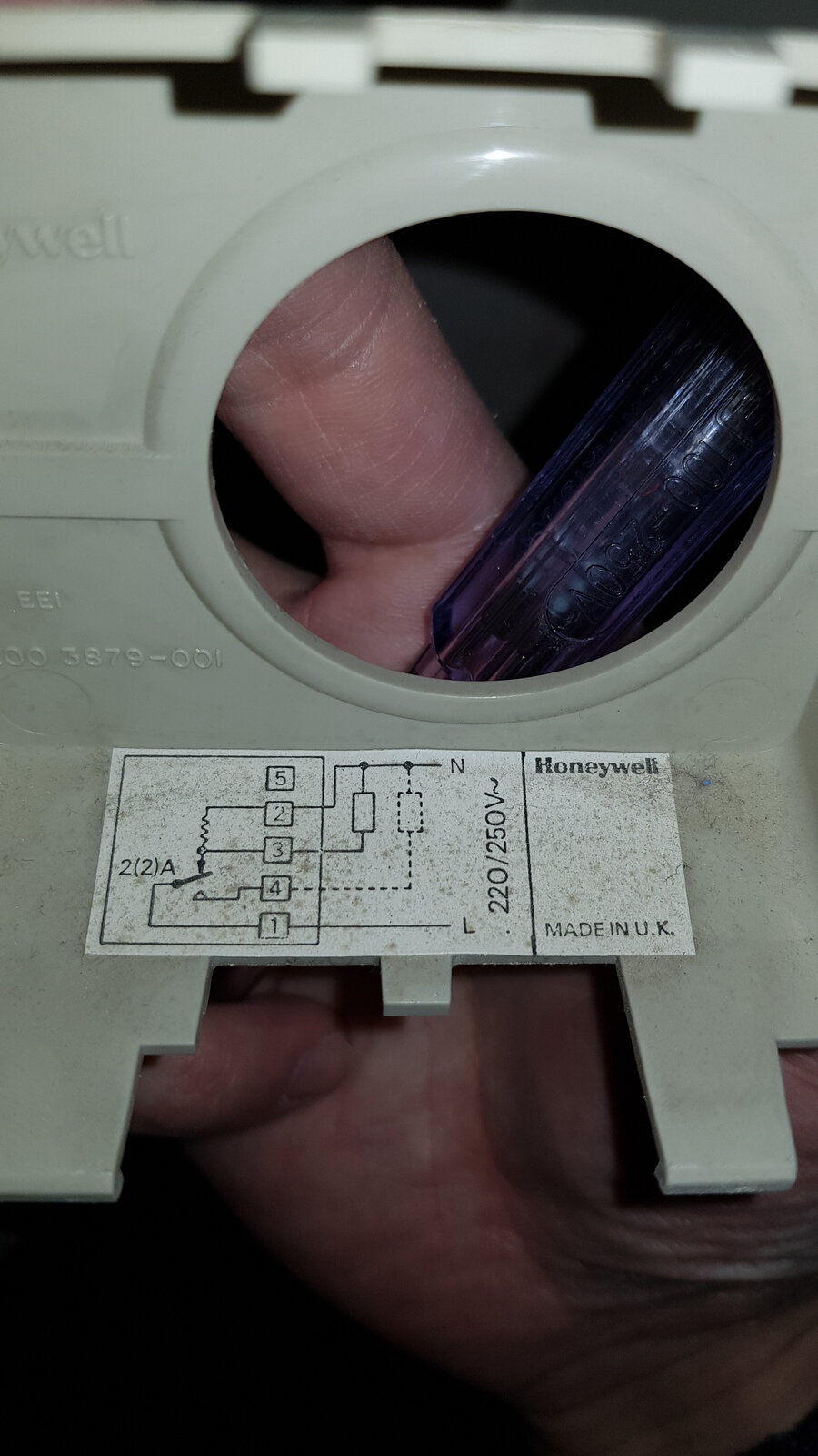

Below is the wiring - i have wires into connectors 1, 3 and 2
read my earlier reply, you cant put the receiver there, easiest place would be next to your programmr then take the thermostst to any room you want

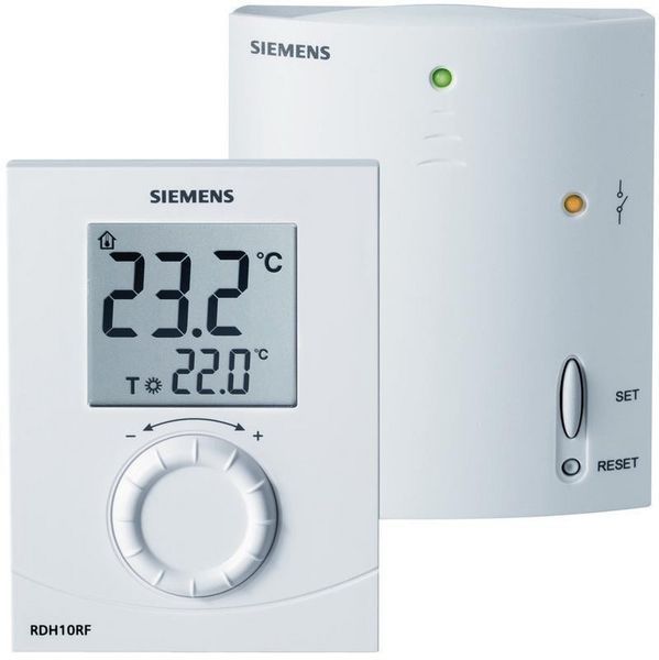

They all wire in exactly the same, sadly most of the wireless RF stats on the market just now are programmable so probably not what you want, but you can set then to constantly on and just use the up and down temp buttons if you want
Ok so the neutral wire is there if it’s as you say, you can place receiver there and place room thermostat wherever you want. The other option is leave existing thermostat wiring, and connect live and switched, safely terminate neutral and use a digital battery operated thermostat.

sorry I misread your post when you just mentioned the two lives, if you also have a neutral that makes it a lot easier, you can just fit the receiver, where the existing thermostat is, although you will have to swap the live at the other end of the cable to a permanent live , the switched live remains the same as does the neutral

So by the sounds of it, should i be able to buy something like this;
(Siemens RDH100RF)
And just fit the receiver part where the old stat is?
If thats the case, is there much advantage to splashing more for a smart one with a phone app (or would one of those actually be any easier the fit?)

Yes that’s fine, but you’d need to place a link wire between L and Lx.
They are all exactly the same to fit, just depends on what you want it to do, the advantage of one that connects to your smart phone is you can see what temp the babies room is, or wherever the stat is placed, on your phone
