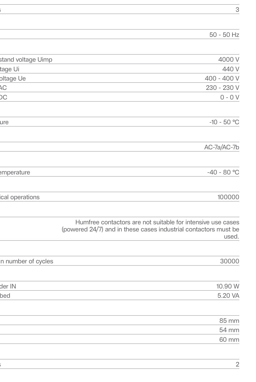

Only just noticed this on a Hager spec sheet
Was about to order one for myself , not sure if applies to all brands

Some "hum free" AC contactors are in fact a DC contactor with a built in bridge rectifier and capacitor to feed the coil with a "smooth" DC This enabled the use of a simple magnetic arrangement.
The bridge rectifier and the capacitor are the weak points which can shorten the life expectancy of a contactor
I supposed I should be looking at what 'hum free' actually means.
To my mind if I opened a control panel and heard anything humming; I'd start looking to see which device had a problem. however any wire wound device has the potential to 'hum' if you get close enough to it -at some stage I'm sure we've all put our ear to something to see if it's powered.

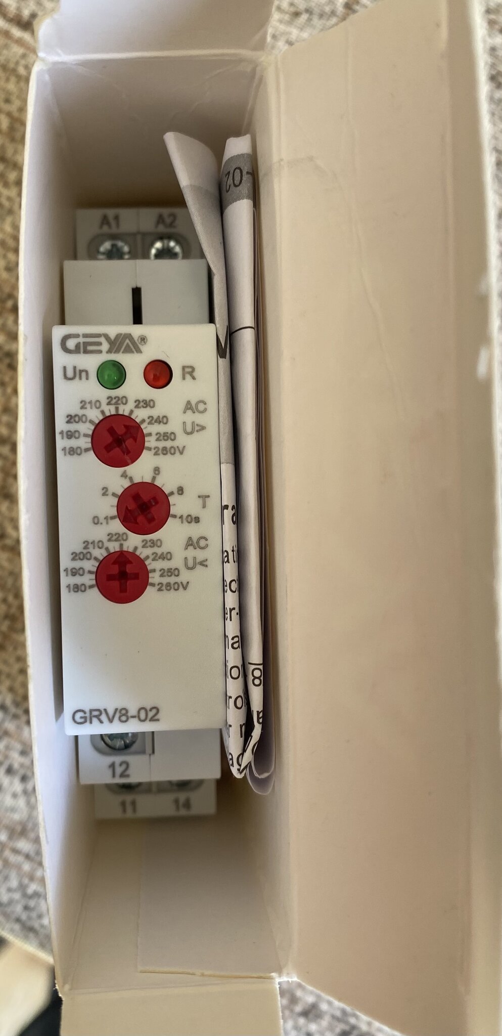

Its for under/overvoltage protection so presumably the main contactor needs to be n/o
Don't think there's any way round it.
Afaik some of the shower controllers use a relay /contactor combination so main contactors aren't energized ,but that wouldn't fail-open I don't think

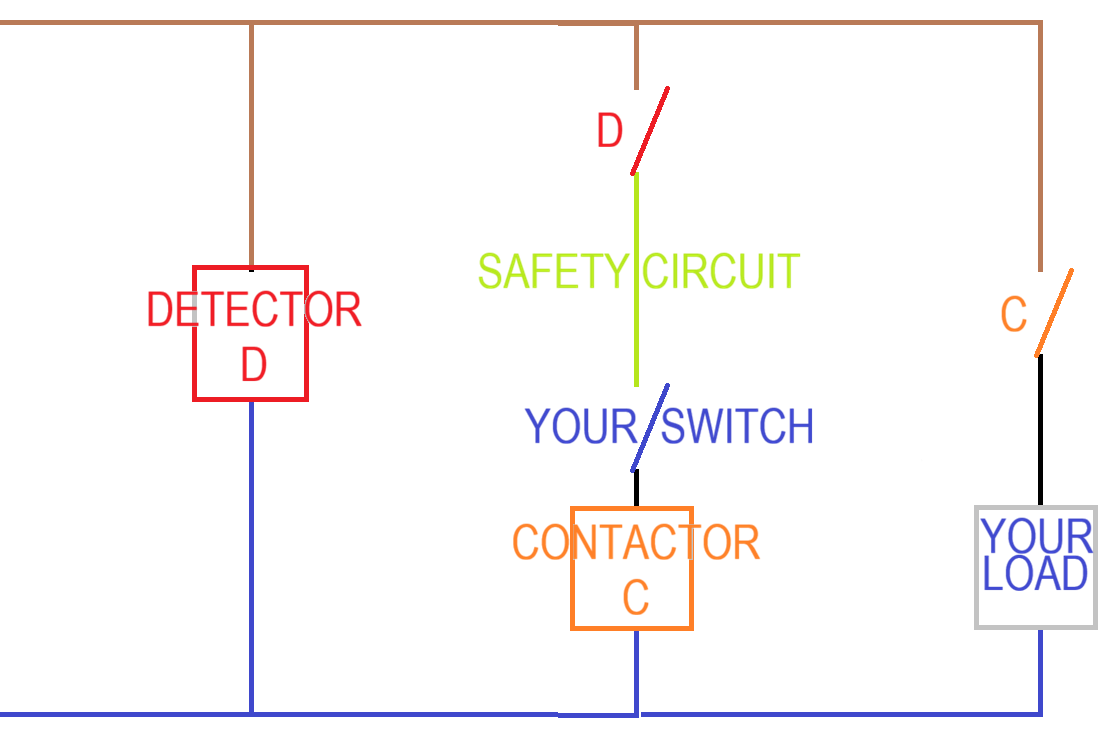

Why not use the detector device as a safety circuit and then use a contactor only when required?
Explain that operation for me ?
The detector needs to de-energize the n/o contactor almost immediately to cut the supply
The DETECTOR only energises the green zone when voltage is within limits.
YOUR SWITCH operates the CONTACTOR which powers YOUR LOAD
