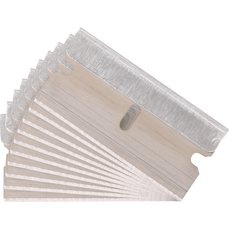

What’s the best way to remove old silicon sealer from around a shower tray?
Tools?
Chemicals?
https://www.toolstation.com/axus-retractable-window-scraper/p93304
Held with your fingers and thumb at the flattest angle you can against the surfaces of the tray AND the tiles and you'll get it all off beautifully without damaging anything. Takes some time to get all the dregs off.
