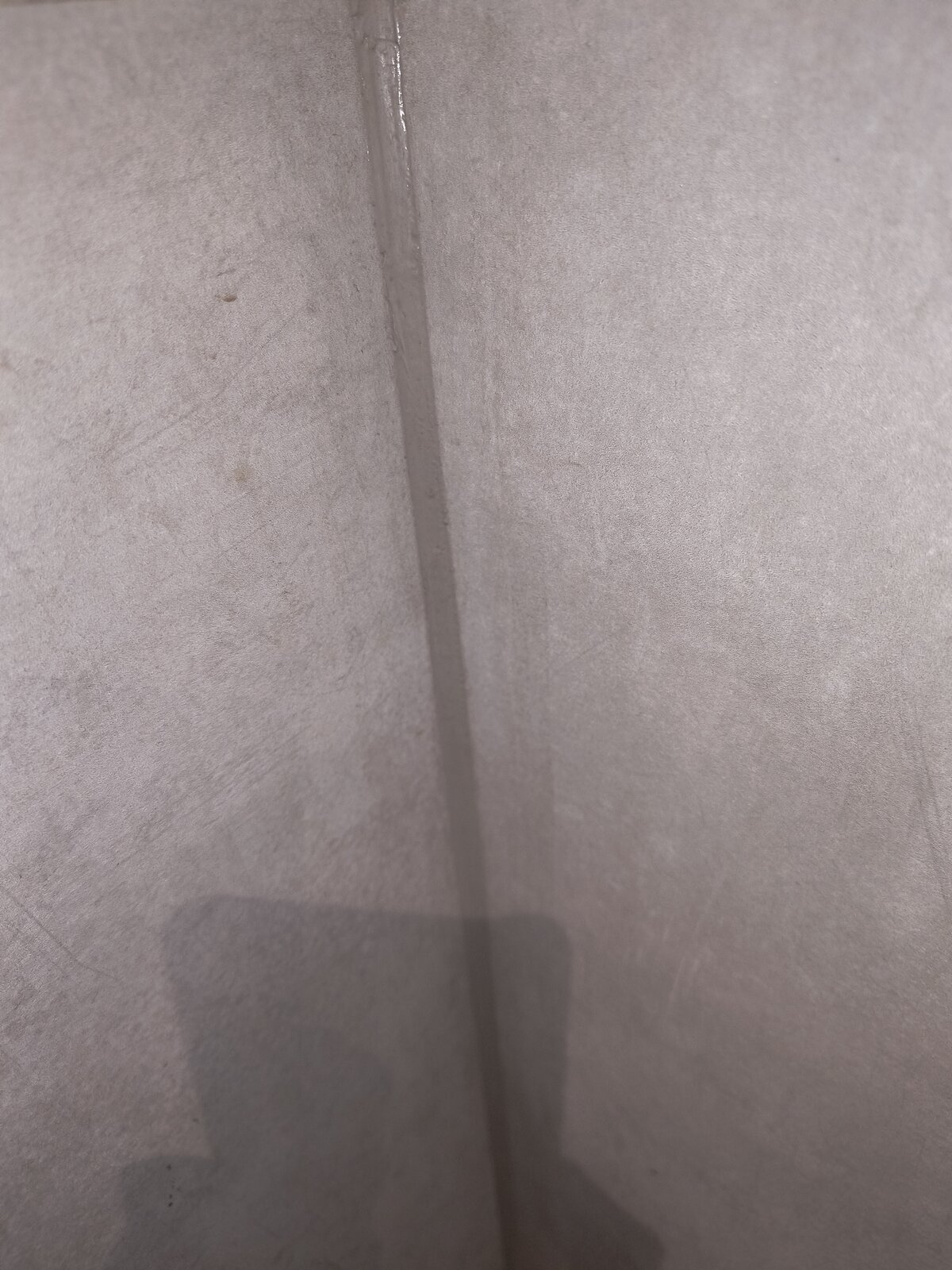

Although I do use silicone profiling tools, the videos over exaggerate how effective they are. If you use too much silicone, it will leave leave residue behind regardless of which brand of tool you use. You might not be able to see it but in time, when cleaning, the super thin film will start to rip off.

I have to say I haven't had that problem, I can put silicone anywhere I want on a tile or bath, and easily remove it all with a Fugi tool, that's how I clean up any that has gone astray, and I've never had it leave residue behind. I don't see how it could leave any residue behind, to be honest.
See 17:15 in Tet's video, for example - I do that all the time with my Fugis and never have a problem getting the surface completely clean with one stroke.

Fugi is one of my prefered brands. Take an offcut of a tile, apply the silicone on the tile, wipe the tool over it (to remove the recently applied silicone). Leave it to cure. Then use a scouring pad to rub the tile... You would have to use an incredible amount of pressure to remove all traces of the silicone when running the tool over it.
Sorry mate, I am not making this up. They are useful tools but massively over sold with regards to their ability to create flawless silicone joints.
Agree, the smear is microscopically thin but there. If you're lucky you can rub it away with your finger without damaging the main bead. I'll forgive it as a fugi has produced the best beads I've ever managed.
You can actually see it it this picture, about an inch wide down each side. Not really noticeable in the flesh - I suppose depending on the tiles.
