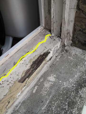

The sill on my sash is totally rotten and needs replacing.
What I am unclear about is whether the sill and the bottom of the window, where the sash comes to rest, are all one piece of wood or whether the sill is separate and the join concealed.
Could anyone advise? I feel I may be able to replace the sill if it is a separate piece

photos would help see what type of sliding window you have, and which pieces are which.
Good point, these pics hopefully help. I have tried to indicate with a yellow line the 'join' point I am thinking of
Its not clear in these photos but there is a difference of about 5mm between the wood top edge at the bottom of the sash and the top of the wood that continues out to be the sill, which suggests that maybe they are 2 pieces?
There are 3 pics in all
Thx
N
no i think that is all one piece.
you will need to determine if there are spiral spring balances or traditional lead weights.
you should be able to see the spring balances at the top.
this may help -
http://books.google.com/books?id=bU...ry consturction&pg=PA397#v=onepage&q=&f=false
if there are spiral balances, then you can screw through the bottom of the stiles to the wall (not into the cavity, if there is one). this will then fix them while you chisel out and replace the sill.
if traditional lead weights you will have more trouble as you could foul the weights with your screws.
i am sure there have been several threads on this or similar subjects. try searching "replace sill" or "replace cill". it will be similar for all door and window sills, the stiles are generally tenoned into mortices in the sill. if the stiles are fixed independently they should be ok.
remember to allow for movement so leave a gap between your new sill and the stiles and use flexible filler (paintable) to fill it.
thanks
lead weights, I can hear them clanking!
I dont see why i need to secure them though, surely removing the sill would not affect them?

the window frame should normally be solidly fixed together at the corners., if the stiles move when you're removing or replacing the sill then the windows will not slide very well amongst other problems.
you might be able to use metal L-brackets for example to keep them secure.
or cut out the rotten parts of the sill and replace with hardwood and epoxy as filler.

I was thinking that the stiles are kept apart by the wood base of the box frame where the lowered window sits. If the sill can be separated away from that wooden runner then the stiles should not move away from the wall as the integrity of the box wont be affected? However a belt and braces L bracket approach does make sense.
Does this sound right?
Unfortunately the rot is too far gone to fill, I can probably remove most of the sill with a teaspoon let alone a chisel!

it depends how the stiles are fixed to the wall.
you want to make sure that they are not moved either in/out the builiding, up or down, or together/apart (i think this is the least likely way they will move)

Yes, I see, I do think the rotten sill should come away without too much effort but I will try and support against movement
The sill to replace, is this a pre made piece from a wood supplier?

also after you have replaced the sill, the stiles will potentially be unsecured unless you joint them to the new sill (which may be difficult)
if you can;t find one in your timber yard, a decent woodworking shop or joiner should be able to make you up a new sill. i would strongly recommend hardwood, or at least well treated softwood.
And finally... Make sure that the bottom of the stiles are sound before embarking on a repair. If they're not you're on a hiding to nowt.
The rot in your picture looks pretty terminal. Ditto the paint at the bottom of the stiles. Brace yourself for a nasty shock if you start prodding
