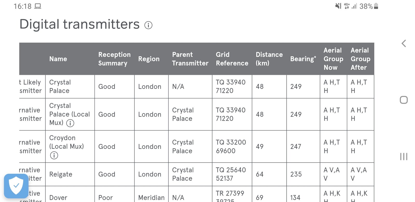

Have you had a look at the coverage checker for your area? There's one that gives more useful info, here: https://www.freeview.co.uk/corporate/detailed-transmitter-information
Pop in your postcode and house number. Once the info comes up then scroll down. At the head of the list you'll get the most likely transmitters. Then scroll further down for a rough guide to the signal levels in your area. The key to the chart tells you whether signal level is strong, variable or poor.
Take a screen grab and post the results back here.

Hi lucid. Good signal strength and crystal palace is the recommended transmitter.

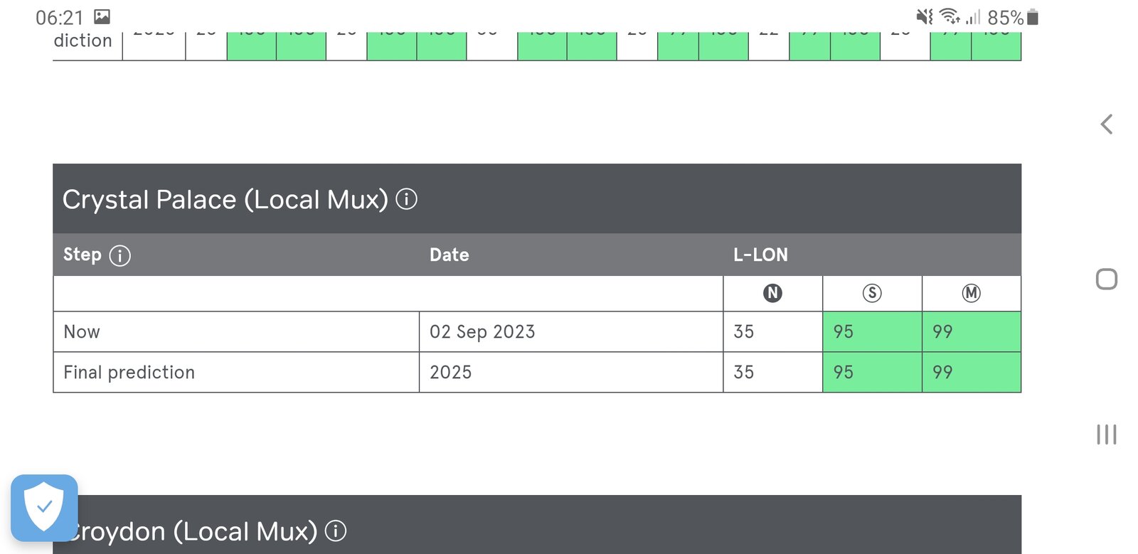

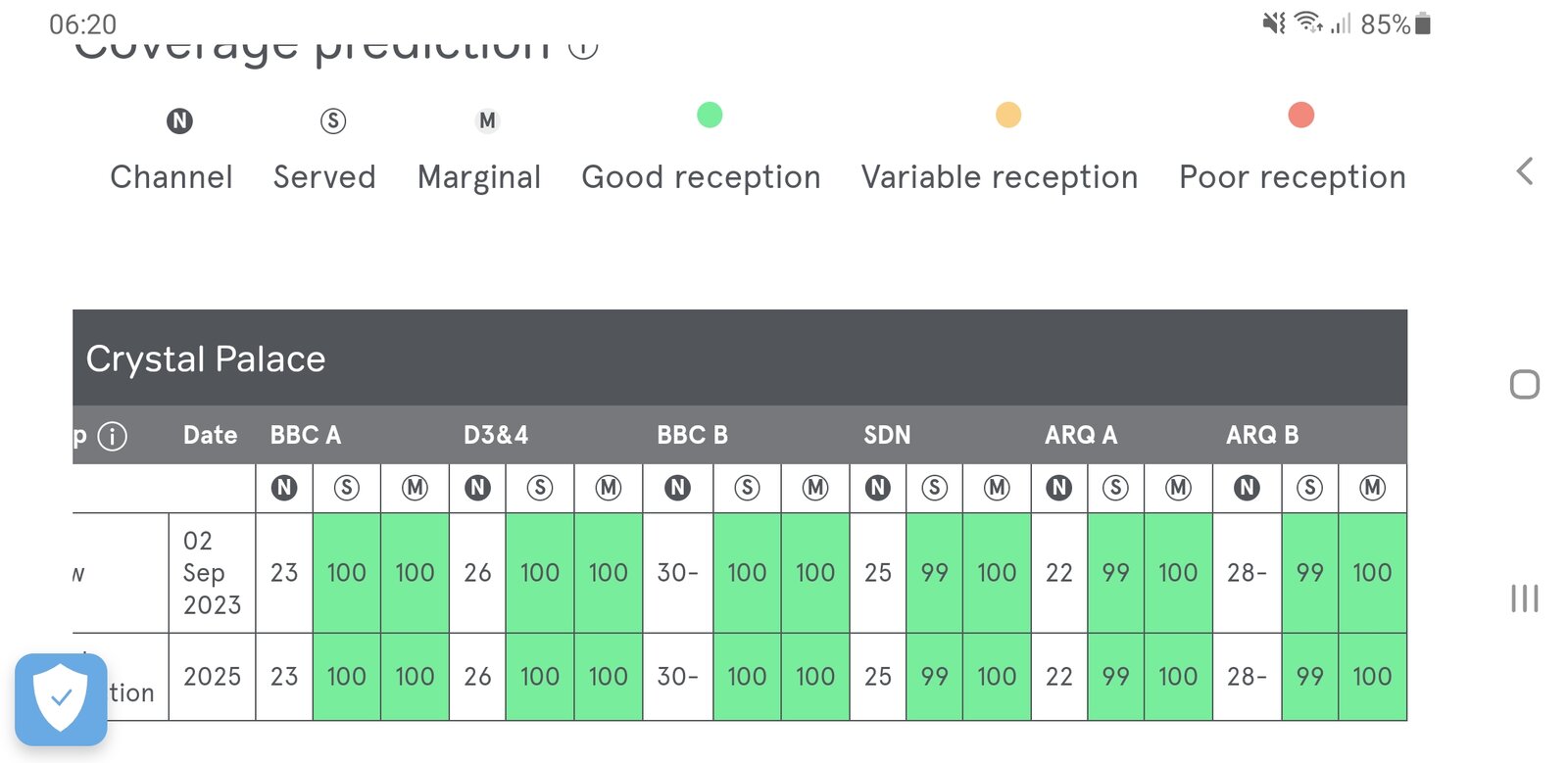

I thought you might have understood about getting a screen grab for the CP signal predictor. It's below the one you got. You have to scroll down. Keep going. A bit more. That's really the one we need to ssee. it has the individual muxes. Can you show us that?
Sorry im using my phone to get the screenshots so space is limited. More info attached.
the aerial is mounted on a 4 foot pole on top of the chimney stack. House is a bungalow, located at top of a large hill but there is a large wooded area behind us where the aerial is directed.
With those sort of field strength numbers I am really surprised that you get no signal without the additional amplification that the powered splitter provides. The exception would be if the trees are right at the end of the garden or towering over your house.
