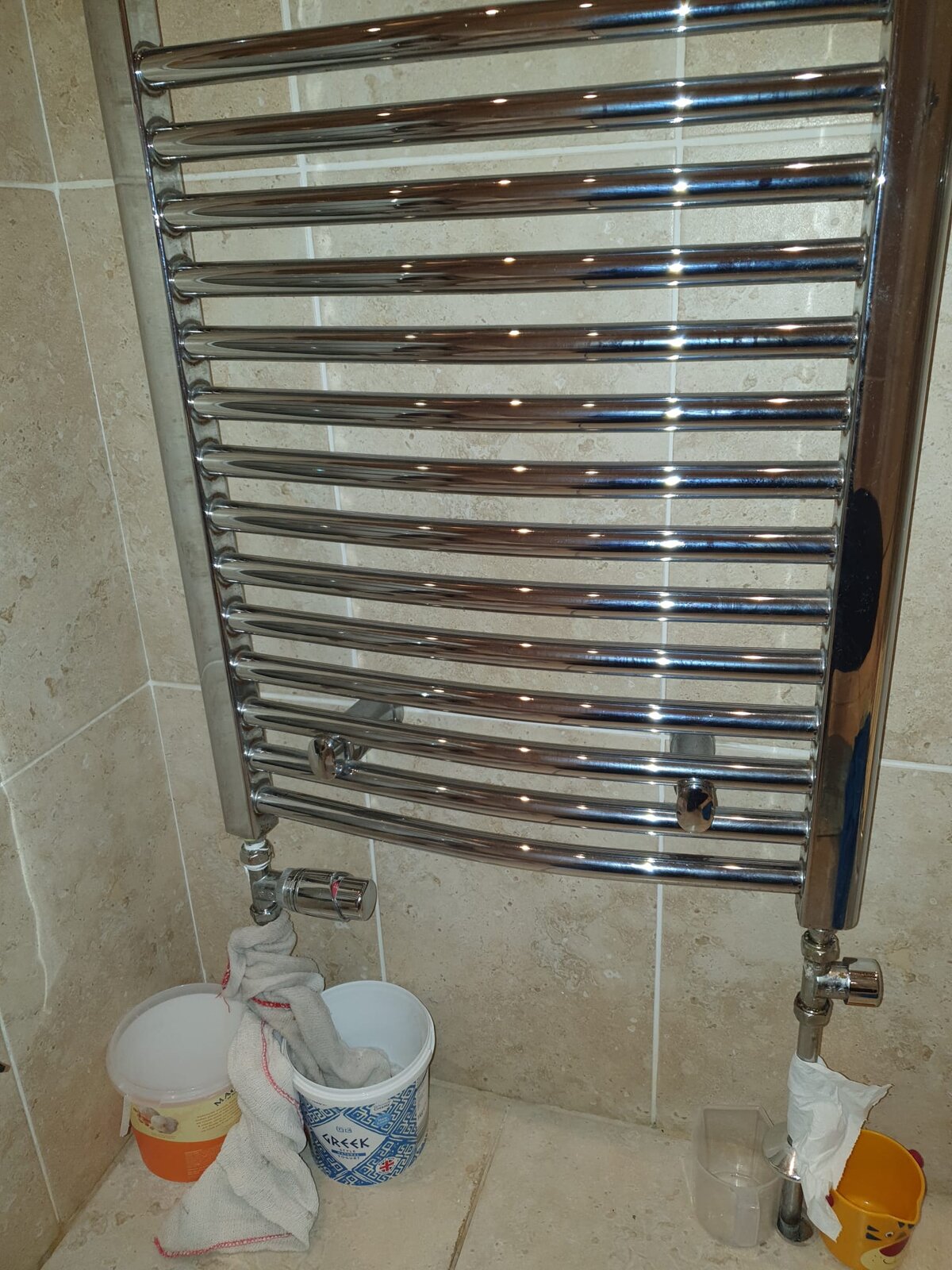

I recently moved home and found the radiator in the ensuite shower doesn't work, according to the previous owners it has never worked and a plumber said it'd be a big job to fix. Being the inquisitive type, I thought I'd have a look at this. All other radiators in the house work fine. There's no air in the radiator - when I opened it with a bleed key, water came out straight away. The thermostatic valve is open all the way, I've even removed the valve head and tried pushing the pins in - they move freely.
Going a step further, I decided to loosen the bottom nuts to see if water comes out of both sides, it does. A plumber mentioned that replacing the valves could get the radiator working again. I have 2 questions:
1. If the pipes at the bottom of the radiator don't get hot why would replacing the valves help?
2. The nuts came loose quite easily, but now when I tighten them back up, they still leak (very small drips). I'm tempted to tighten them more, but I don't want to over tighten and possibly make a manageable leak a lot worse. Am I being too cautious?

Maybe an isolator was switched off so you only have water flowing in front one side?
Could be a balancing issue, or that lockshield valve (non thermostatic one) on the right could be closed?
Got the valves replaced, radiator warms up nicely now :-)
Although, I still don't really understand why the feed pipe underneath didn't warm up
If the old valves were blocked and stopping the flow, then the feed pipes wouldn't get warm either, because there's no flow of hot water through them.
