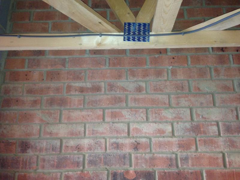

Hi all,

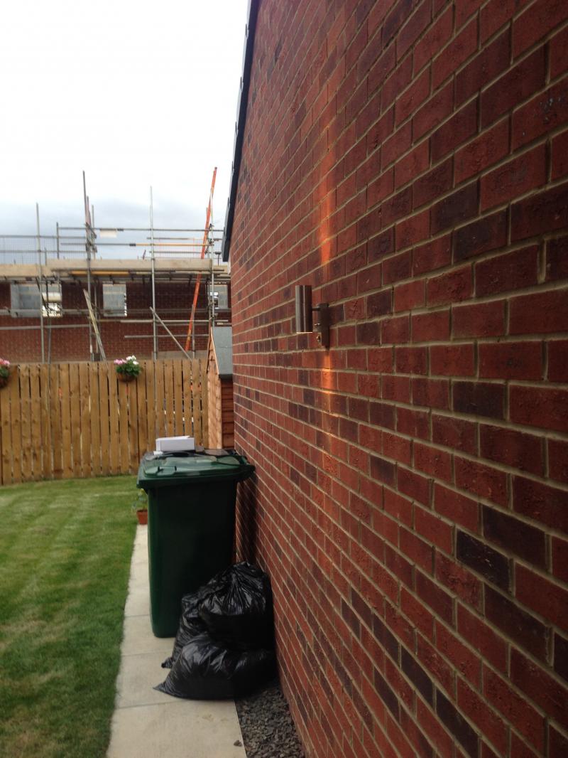

I want to install a couple of ~60W photocell-activated outdoor lights on the wall of my garage to give some security lighting in the garden area.

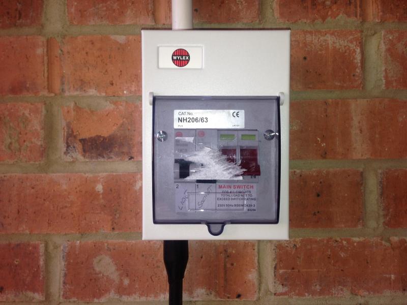

The garage has it's own small consumer unit (RCD protected at the main consumer unit) with a separate circuit for lighting and for one double 13A socket.
So, I need to spur off the socket circuit... This is the current setup:
...as you can see, there's just one t&e (presume 2.5mm?) coming from the consumer unit to the socket, so no ring main.
Can I just fit a junction box and 3A FCU where the t&e comes across the joists, or should I spur off the socket itself? (I thought you weren't supposed to spur off a socket with only one wire coming to it?)
A double pole 3A FCU would be best so you can use as a switch and isolate the lights.
If you want.
That's correct when it is a spur from a ring.
This is a radial circuit so you can connect as many sockets as you like.
However, it must be protected by a fuse or MCB of 25A or less.

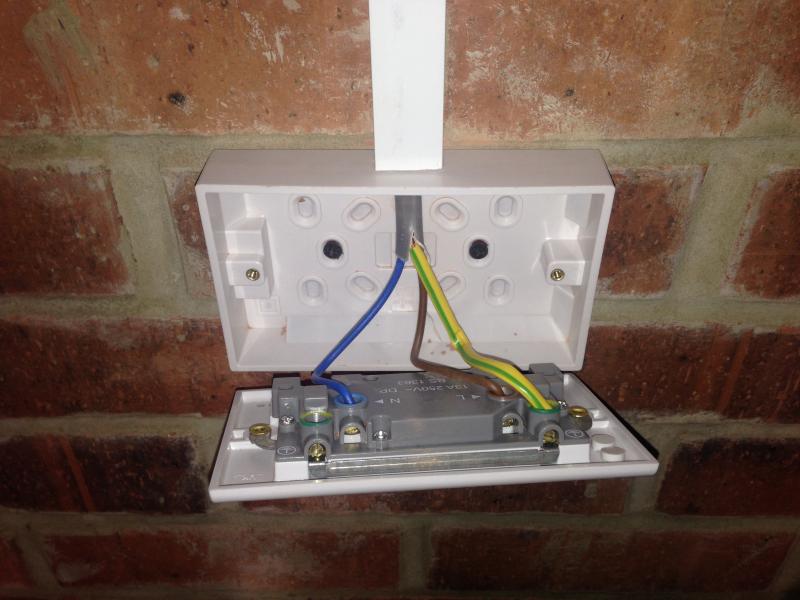

well I ended up just taking a feed from the lighting circuit...and it works! :D
I know it's not the tidiest, but I just want to make sure everything's ok with the wiring in the junction box... going from right to left is the main feed from CU to switch, and the "spur" is the one going upwards...
Well done for using the light circuit.
Junction box is tidy for a diy effort.

no switch yet, that's tomorrow's job (and the other light)
Can I just fit an ordinary light switch and connect both lights to that, rather than another junction box?
Yes use a normal light switch and use that as a junction box.
You will need to join the neutrals in a choc block.
