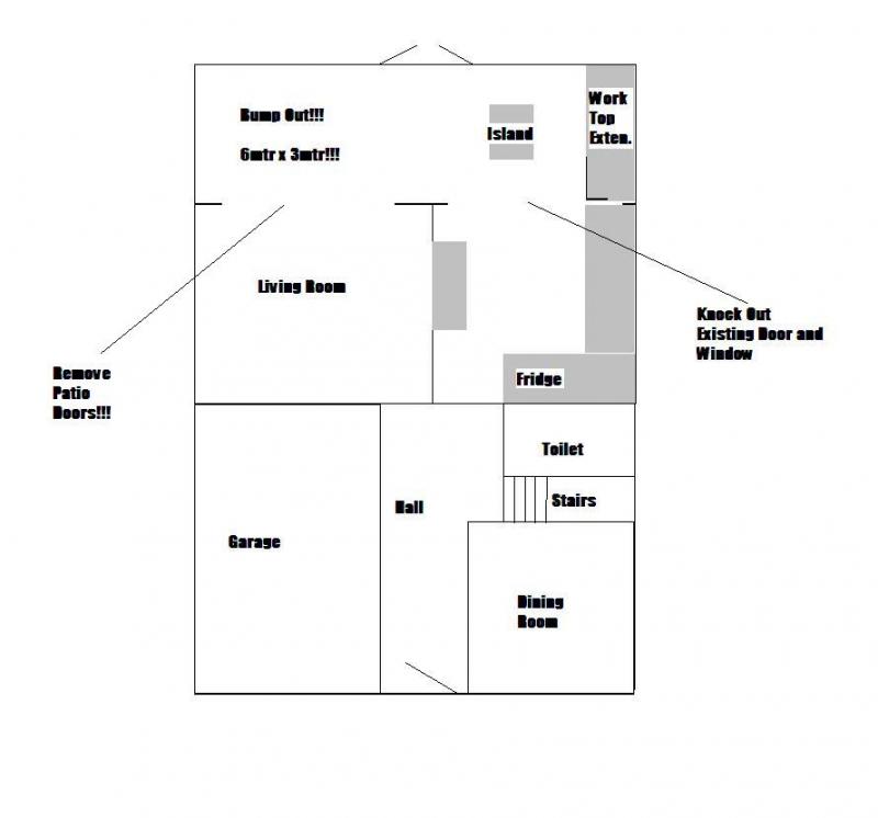

As for my extension ideas, I plan to remove my current patio doors, and use them in the new extension, I believe the Lintle above this current window opening to be sufficient, without adding an RSJ.
However the Kitchen currently has a door and a window, I dont know the status of the Lintle, but if needs be I suppose an RSJ could be used!

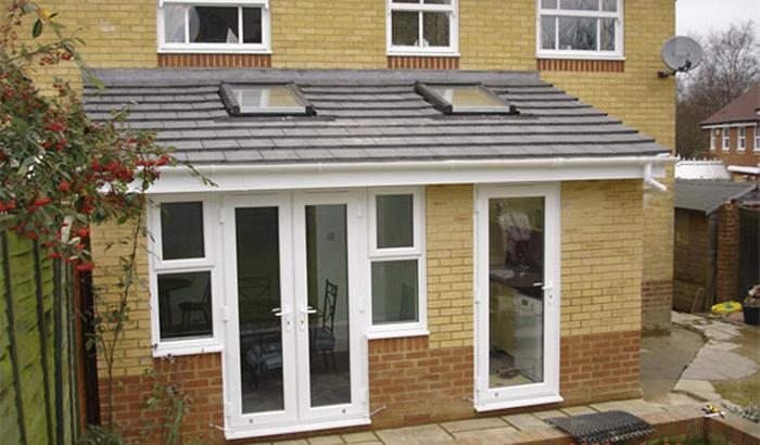

The thing I cant get my head around the most, with the house being of timber frame construction, is how the roof will tie into the current property structurally, how will a lean to roof be supported against the outter skin of the original house??? Help in this area would be very much appreciated!
Attached are 2 pictures, one being of what I am after, but obviously my house is wooden framed internally with brick outter, and the other a very rough plan of what I want to acchieve. Cheers Rich
You don't have to worry too much about supporting the external brick or lean-to roof, a steel beam will do it - exactly the same as with a traditional extension
The issue is how wide the knock-through openings can be, as if you can't work to the panel sizes of 1200mm, then it could mean more work adapting the frame
