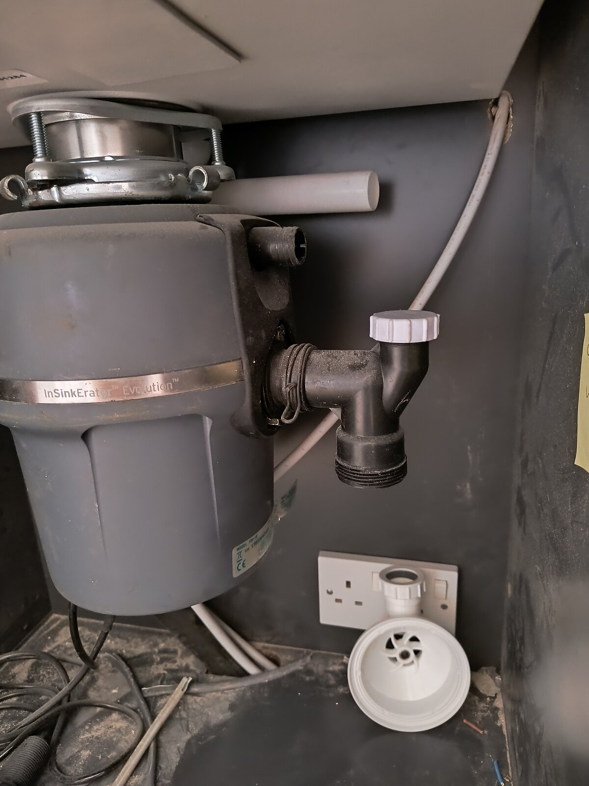

Any suggestions? It's an insinkerator evolution. The overflow pipe at the top is about 30mm diameter, the white screw cap is the inlet on the disposal (looks suitable for a 25mm pipe - presumably the cap is replaced by a compression nut and rubber seal.
I think this has been asked before without being solved, so alternatively is there a universal fitting that would connect the 30mm pipe into a standard 32 or 40mm waste fitting?

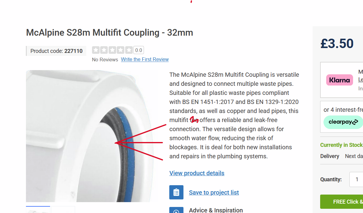

This is from Wickes. Worth a try - slice out the inner thin plasic tube with a penknife if it's in the way.
