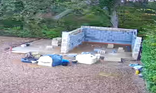

But I have solid blockwork on the right garage bit, double skinned = insulated). 7.3Nm outside and thermalites inside. Its going to be clad with featheredge to look like the above images painted in black bedec. My garage door will be attached at the side (piers).
So far this (below) is where I am at so its almost ready for the roof.

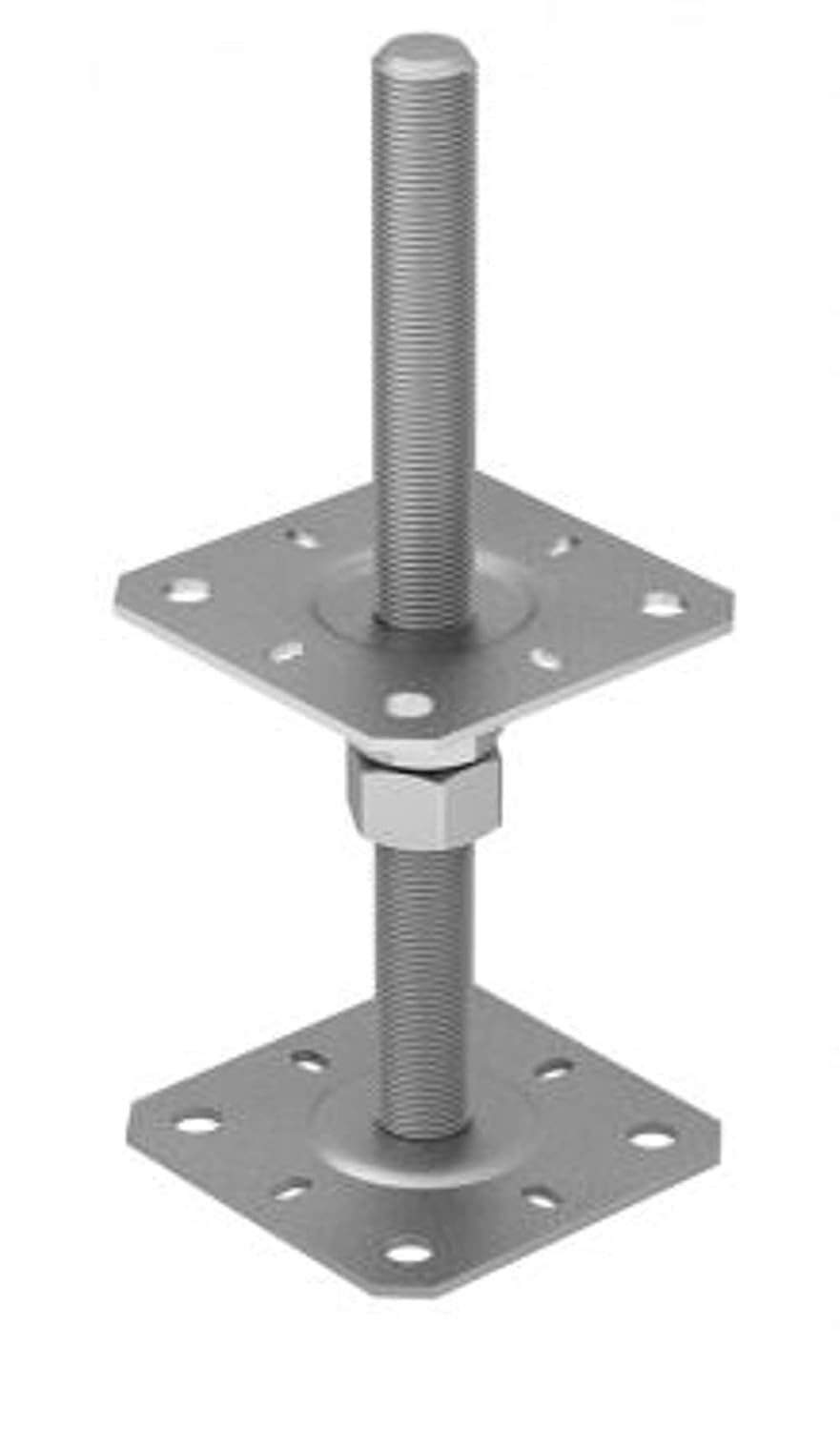

For the carport side on the left I'll be drilling in plates on the left into the concrete. Then these support the oak posts off the ground.
They will each be chemfixed in.
