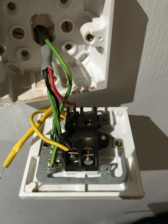

Our house is VERY poorly decorated and it would appear that the woodchip paper has been badly skimmed over!
Question is, if this is the case should i A) knock back to brick - board and re-skim, B) TRY and get to skim off and take off woodchip then PVA/Patch and re-skim OR C) Just skim on top of bad decor and repaint.
Thanks all
Attached is a pic of the top finish, this is the best i can do at the minute as not many on the new phone - will post some new pics tonight
Picture looks more like a switch plate, than dodgy plaster?
Any way, plastering over wallpaper is not very good practice! It would be a case of stripping back to the original wall, then seeing what condition these walls are, then take it from there!

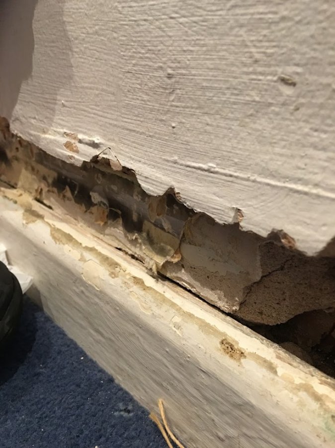

Here is a better pic of what i am talking about :)
Please excuse the decor! LOL, the house is being done room by room.
This pic is where i have ripped a pair of heating pipes out when i fitted the new system, they plastered UP to the pipes!!
Just because there is wallpaper behind the socket it doesn't mean the whole wall has wallpaper they could have stripped it off and cut around the boxes before skimming , even so if there is wallpaper and it's solid just patch it

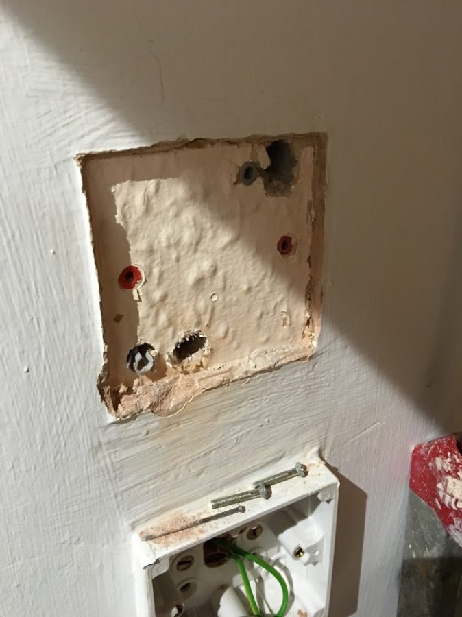

i have taken patches off verious places in the house and i can see the woodchip behind the skim.
I want to re-skim the whole lot you see, not just a patch up. the wall is a right mess.
How well is the skim stuck to it you have to ask yourself, we all know you shouldn't skim on paper but people sometimes do and its sometimes succesful, I wonder what that covering is on plasterboard is called? Now your considering being a plasterer its things like this you will have to make a judgement on ,Is it on there nice and sound? If so why take it off? You be the judge

I presume that best practice will be to knock back to brick and take it from there but as you say... why make more work if the covering is sound!
If you decide to take it off get a steam stripper/wallpaperstripper the steam should lift the skim and wallpaper off to which you will be down to original skim coat, with any luck the original skim won't blow if it do then its back to base coat
