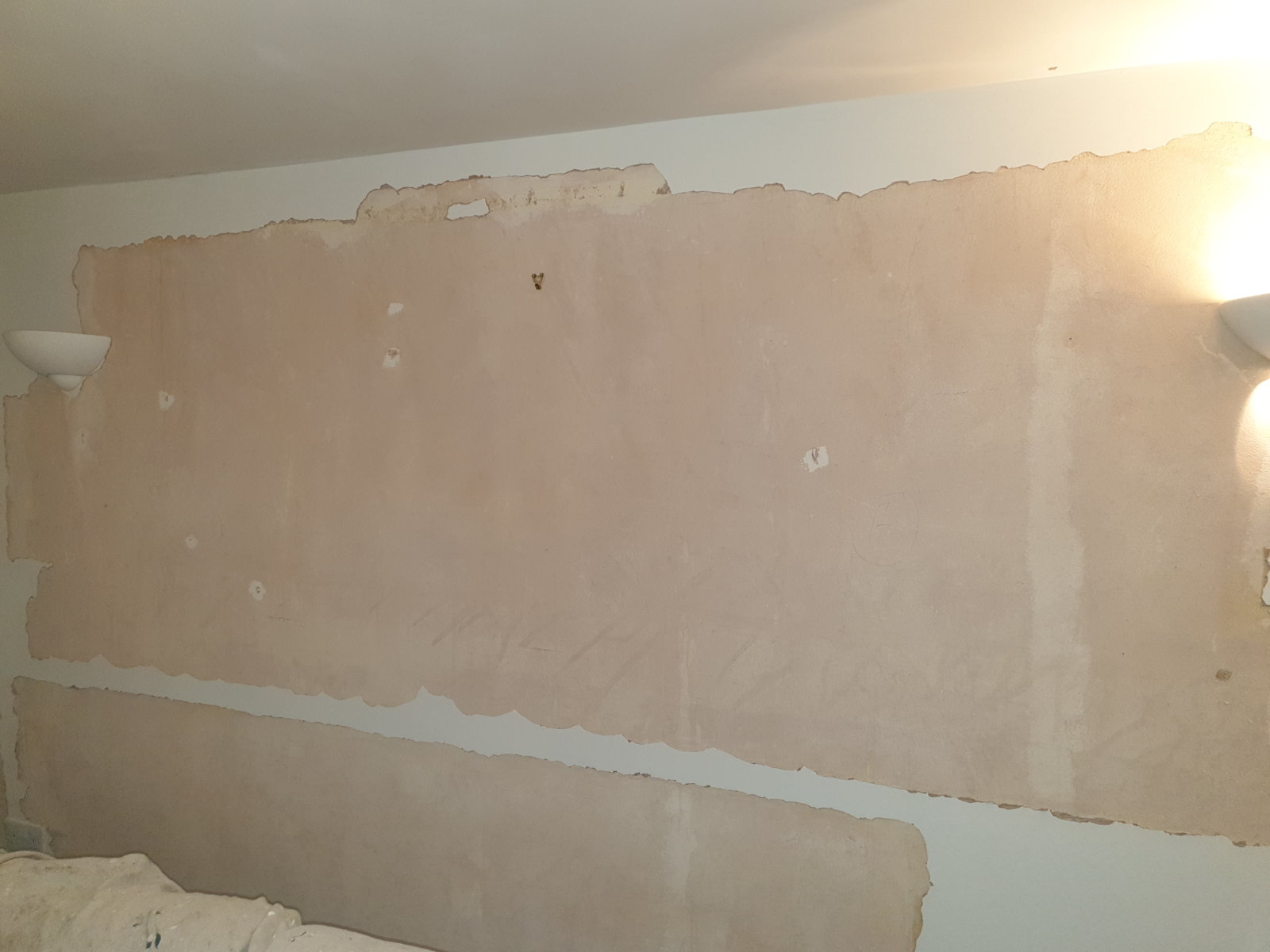

Hi I've got an internal wall were a lot of the plaster has come off,it was a very thin coat bout 2-3mm,the surface below is sound ,I wanted to know if I could use easyfill to level it off or one coat plaster which would be best and should I pva th
e surface first many thanks
No, use multifinish plaster. SBR/PVA the wall first.
