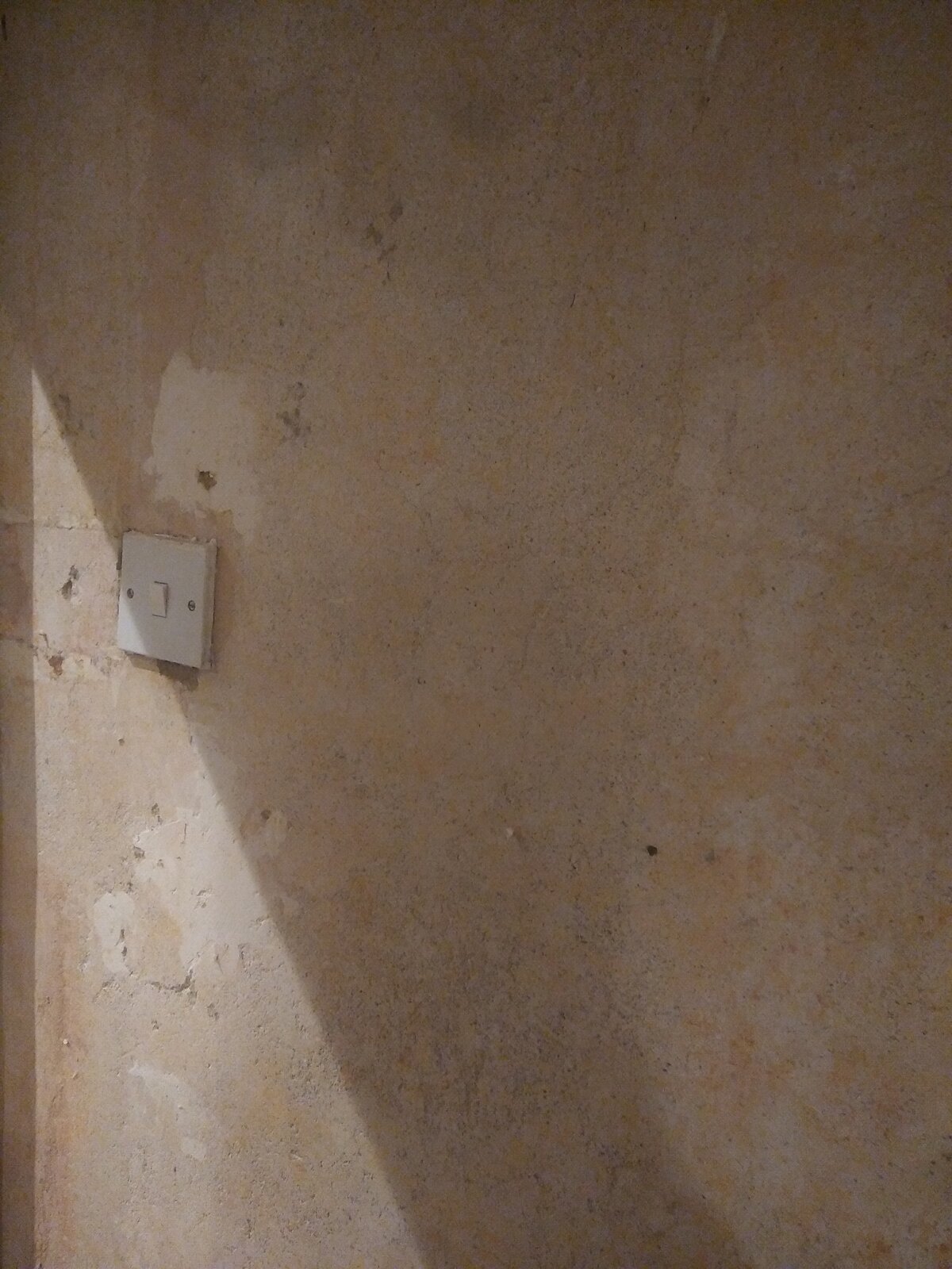

House was built in 1902
The lime plaster is extremely porous and will suck all moisture out the multifinish
What is the cheapest yet effective way in dealing with this before skimming with multifinish?
thanks
what would you do?
Dot and dab plasterboard (would 9mm be ok for wall or 12.5?) then skim?
Hi. It is on an internal wall and my house was built in 1902 - am i getting confused and maybe its not lime?
I'll get a picture now...
if it’s only internal walls and theres no hollows or blown bits crack on with multi, providing theres no signs of rising damp....mesh any cracks and vulnerable areas , around and above doors etc. soak it in neat pva with some sand in . leave 24 hrs and skim.
great thanks for your help
there is one quite big crack from previous times as a result of subsidence - crack is in corner of room. What would you fill this with?
Also, i have some sharp sand, would that be ok to use with neat pva?
fill the big crack out first with whatever you have , multifinish if you have it . then tape over it vertically and pva and skim.
