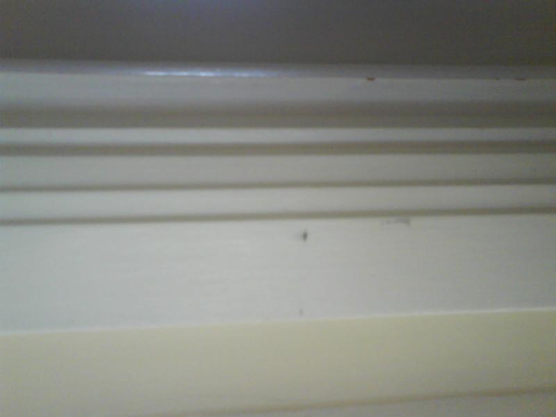

Hi
I am about to undertake so work on my house, this will involve taking a wall down.
I want to continue using skirting/arcitrave/picture rails, but I cannot find any the same anywhere, have anybody got any ideas on what I can do
Cheers

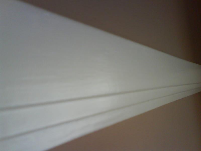

It is very awkward to photograph thing that are white so I am going to have guess. I think it is a type of Lambs Tongue moulding. The architrave that normally goes with such a skirting is an Ovolo moulding. See page 2 of the guide.
I am sticking my neck out but I think it looks like a quadrate moulding as been added to the top of the lambs tongue. This as been carried out to disguise the gap that shows once the skirting has shrunk.

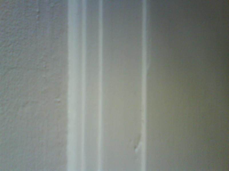

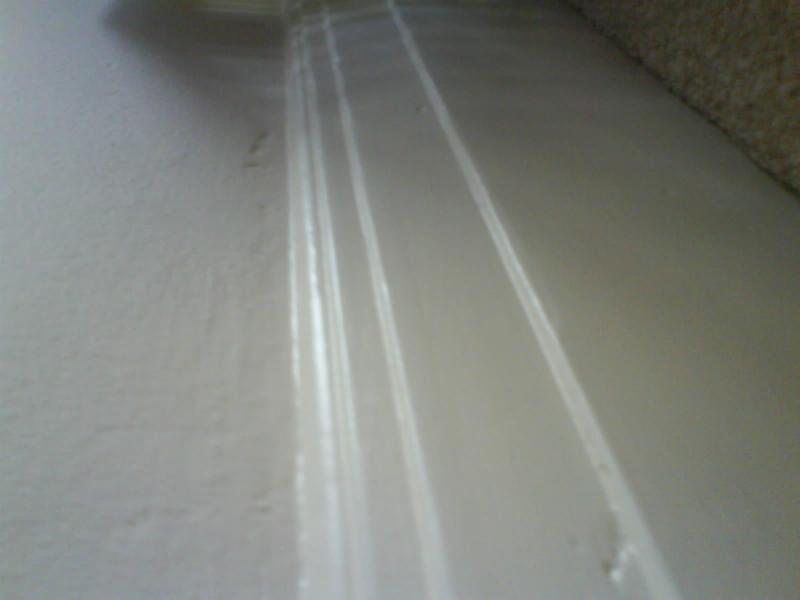

The photo of your architrave I just can’t make it out the same goes for the picture rail photo.
I think you will have difficulty in find any one who can supply you off the shelf. And if you did it most likely not the correct size (see note on guide)
But all is not lost as I make all my own mouldings I have problem in supplying your good self should you be able to find another suppler.
