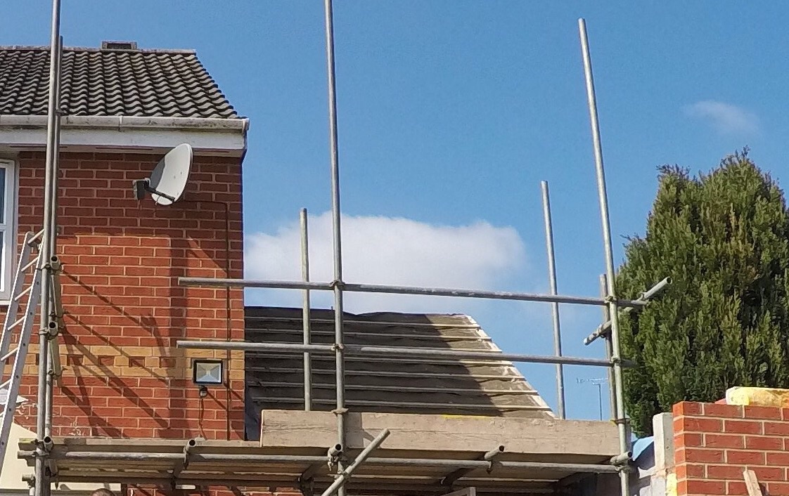

Can anyone tell me how difficult it is or isn't to unplug the cable from a satellite dish to feed it through joists instead over over a roof like the cheap-ass installers do.
Is it just a matter of removing the sky dish cover and pulling connectors then plugging back in or a specific wiring mechanism
Cheers.

The cables are fitted with F connectors. These have a screw thread for attaching the lead to the LNB.
The F connectors themselves simply screw on to the end of the cables. You might find it easier to take off the plugs when routing the cable, then fit the plugs back on before reconnecting. Here's a How To on fitting F plugs from the Satcure site

I'm specifically talking about the cable into the back of the sat dish.
The entry point for the cable into the house is now concealed in the new house extension support column, so unless I want to drill through the wall again which I don't it's easier to unplug/screw from sat-dish end and feed through the new extension joists.
Only cheap nasty F connectors screw on to the cables. Decent ones are crimped on, even better ones use a compression technique. However many sky installers use the cheap nasty type. The cable F connectors screw on to the bottom of the LNB on the dish. There is probably a sliding cover over the connections which you will have to slide up. The connections should also be sealed with self amalgamating tape or a boot, but again sky cowboys that throw the cables over the rook may omit this as well.

Just outa curiosity, why can you not leave it attached to sky dish and feed cable from the dish to wherever it is going?
The "cheap and nasty" twist-on F plugs are perfectly OK provided that:
1. you choose the correct size plug for the cable and
2. apply silicone grease to prevent corrosion.
3. pull down the shower cover on the LNB (or fit boots if no cover).
Interestingly, all Sky installers now use compression type because of unreliable connections caused by the above considerations. However, for DIY use, provided that you follow the instructions carefully, twist-on plugs are perfectly adequate. No point in buying a compression tool if it's a one-off job.
In answer to the original question, it's not difficult. You can unscrew the F plug and refit it after passing the cable through the new holes. If it's a compression type, you can cut it off and fit a twist-on type. Be sure to unplug the Digibox from mains power before touching any connections!

Ok, took the cover off and thus is what I found.
Does this look ok and normal to you guys? As nothing looks untoward to me
It looks normal for a sky cowboy, but it is certainly not OK.
1. Cheap, nasty screw on F connectors with no attempt at tidying the braid.
2. No waterproofing with either a boot or self amalgamating tape.
The cover that you have removed is supposed to slide up inside. Neither boots nor tape are needed with this type of LNB. The cover keeps direct rain off. All that's needed is silicone grease. See http://www.satcure.co.uk/tech/boots.htm
The F plugs look suspiciously loose and might be the wrong size for the cable. Click on the "How to" link that Lucid provided in his #2 post.
