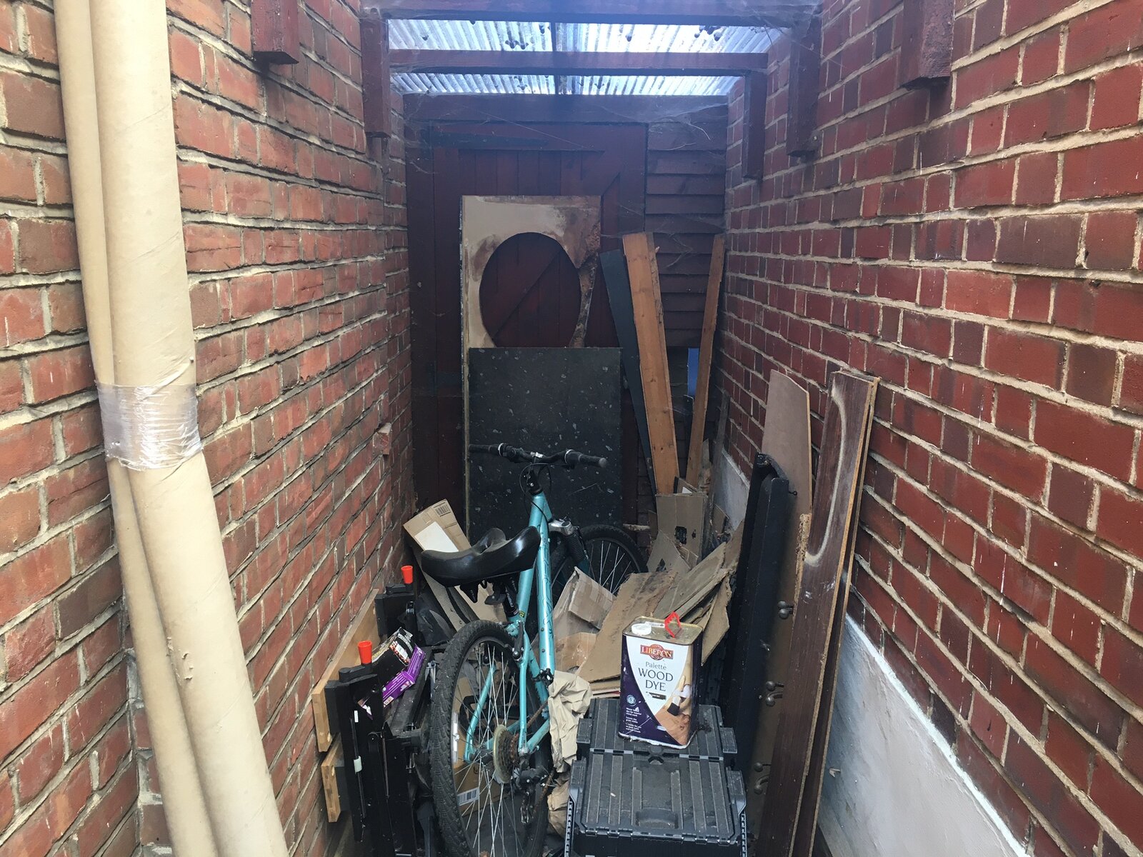

We have a narrow space down the side of our house which currently has a portion of it covered with plastic corrugated roof sheets so we can store a bike and other bits of crap (out of sight out of mind right?). What we're looking for is a slim shed (no more than around 90cms external width) but as deep as possible, perhaps 180cms or more, that can offer more secure storage, out of the elements, etc.
Can anyone think of something that's available off the shelf in kit form? Not bothered whether it's wood or plastic but obviously needs a door and roof.

What do you have either side? Two brick walls - side/end of houses? A picture of the space would help.
either side are two brick walls yes, one wall is ours, the other is our neighbours wall.
Here's a pic of the rubbish dump!
Easy, if you get on with your neighbours and they allow you to attach on to their wall. Sell it to them that it will be a security feature. A door at the front, a door or wall at the rear and a flat, felt roof sloping either way for rainfall. This is what a mate of mine did in the same situation - he has stairs in his and his wife uses the upstairs as her hobby/sewing room.
Edit. You're halfway there. Flat roof, felt, door or wall at the other end. Job done!
Thanks Mottie. When you say flat roof, what do you mean? The corrugated plastic roof (which isn't entirely waterproof by the way) is sloped for rainfall.
Just some plywood to replace the corrugated plastic. Probably some arris rail either side at the top and some good quality shed felt stuck down with cold felt adhesive.
why would I need to replace the corrugated plastic with plywood & felt Mottie?
Leave it as it is. Get a wooden garden gate to fit the width of the opening less a couple of pieces of wood to act as supports for hinges on one side and a gate catch or lock on the other. Fasten the wood to the brick walls. Hinge the gate off one side and a catch/ lock for the other.
1. You mentioned security and wood is better than plastic for that. 2. You said the corrugated plastic was leaking. Replacing the plastic with a proper roof like you get on the shed you wanted, will kill two birds with one stone.
