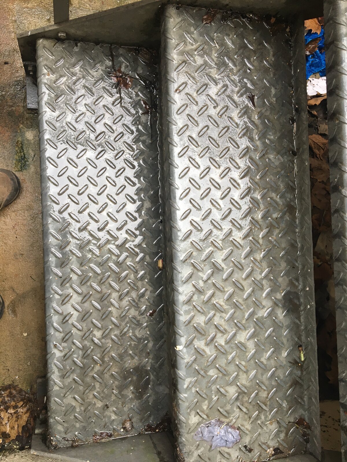

There are some steps outside the front of my basement flat, leading up to street level. See attached photo. They get quite slippery when the weather is rainy. I suspect it's just that they're quite old and perhaps the raised zig zag type profile (don't know what its proper name is) is a bit worn & smooth.
Is there something I can do to improve the grip on these?
I don't want to replace the steps altogether because they're rock solid apart from this one problem.
Thank you.
It's called checkerplate. You should be able to get an anti slip paint for them.
I checked out some anti slip paints online and they seem to need several days to fully harden. How would that work on these external steps? If I can’t climb the steps for a few days I’ll be a prisoner in my own home! Is there some way to get around it (like only painting part of each step the first time and then painting the rest later)?
Well if you're sprightly enough could you make do with painting ever other step, then painting the others after it's dried fully.
Investigate the grip paint they use on ship's decks, in a boat chandeliers. It uses sand mixed in with the paint, to provide the grip.
also, wait until summer if you can?
clean the steps well first. Take advice on aluminium cleaner and primer from the paint company
I think you can get self adhesive material that is used on skateboards. That may work as a temporary solution until the weather improves enough for painting
Bear in mind its probably aluminium, in which case you will need an etch primer first.

Temporary: Get a roll of chicken wire and wind lengths around each tread?
Permanent: Fix a strip of metal to the front of each tread to create a physical stop and put brick slips in.
