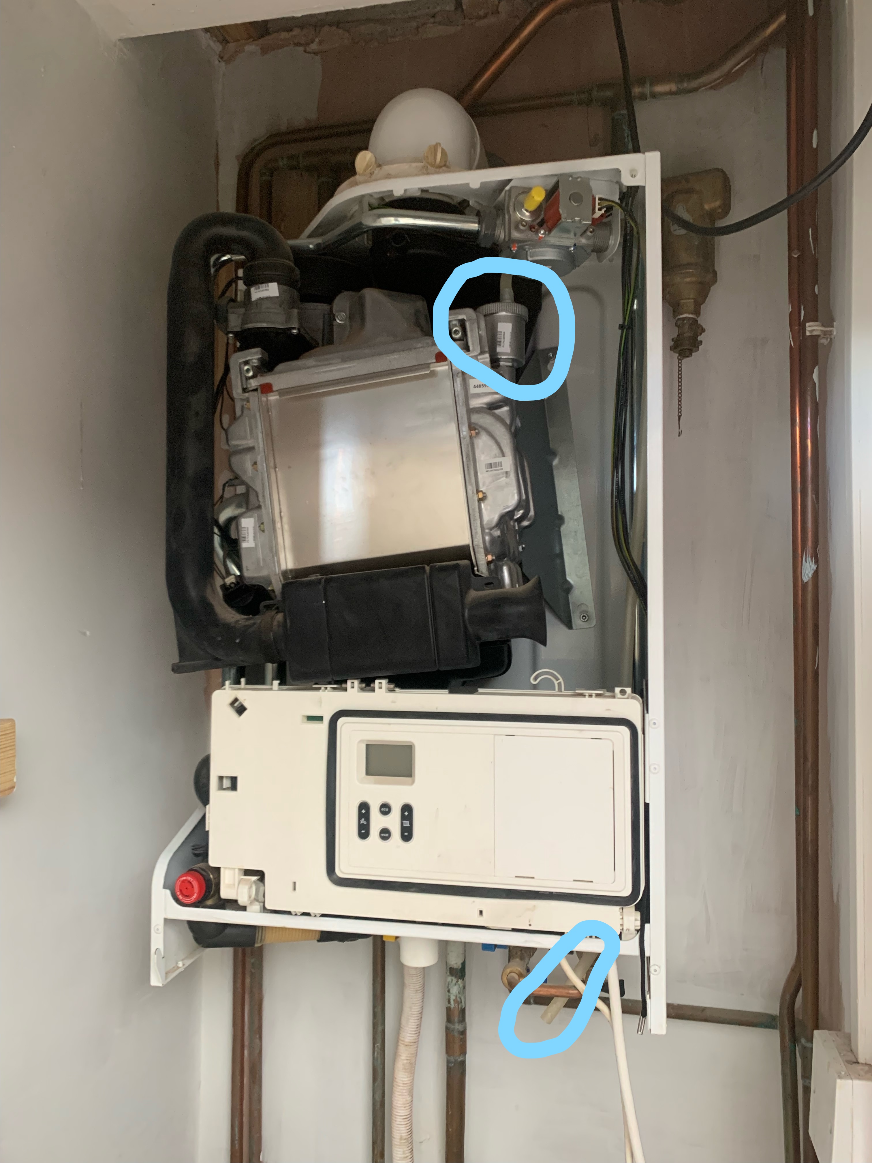

Slow drip from rubber pipe within boiler
28 May 2018
33
2
Good morning all!
We have an ATAG ic28 boiler which has been faultless for the last 4 years.
However its developed very slow drip from a clear rubber pipe within the boiler and after about a week we need to top up the pressure.
I have taken the front off and a photo is below for reference.
Before I try and find a plumber, does anyone know why this has happened or what the part is called that I assume needs replacing?
Thanks in advance.
full
It's an automatic air vent, and yes it'll need replacing. You shouldn't be removing the cover of your boiler - it forms the safety room seal which is there to prevent any escaped products of combustion from entering your home. It should only be removed by a Gas Safe Registered professional, who can carry out the Regulation 26.9 checks before putting the boiler back into operation.

I am an ATAG approved agent so if you need any help I will do my best , all automatic air vents, vessels are cheap crap, and they all leak eventually ,
