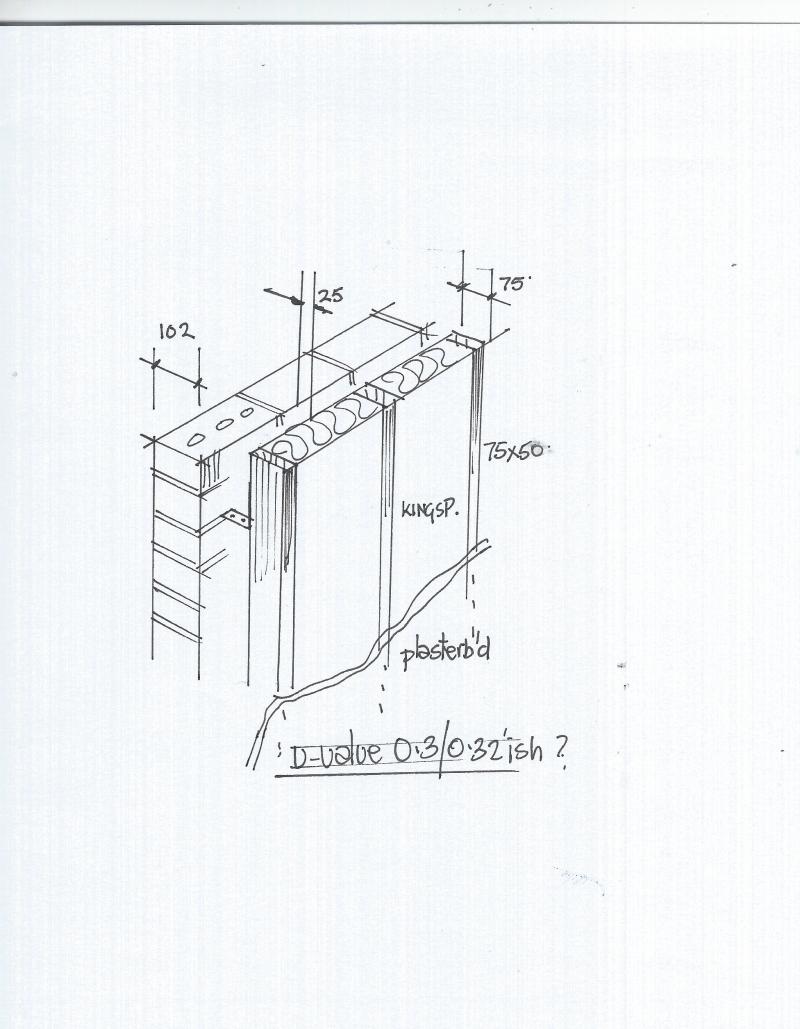

Removing the outer skin of a side wall,and inserting a beam above, is an accepted way of gaining a few extra inches in width.
As regards your new outer wall; if built of brick/block with cavity fill, it will be around 285mm thick (exc. plaster).. If you had a brick outer skin, and 4x2 studwork for the inner leaf,(with insulation between the studs) you can get away with a 25 cavity, giving a wall thickness of 225 (exc. plaster).
You might be able to use 3" deep studs, with only 3" thick insulation board, if you put more insulation in the roof to compensate.

Tony, would the second option ie brick and studwork provide the same level of insulation as a block/brick cavity wall?
Indus; probably not, though not far short. For a brick/50mm cavity/ 4x2 studs with 80mm Kingspan Kooltherm K17 board/12.5mm plasterboard and skim, you get 028. Without doing the calcs, I would guess the wall I suggested would probably give around 0.3 / 0.32; thats why he'd need a little more insulation in the roof to compensate.

Tony, just so I'm clear about what we are talking about. On one hand we have the usual outer brick, cavity stuffed with insulation and then blockwork wall. Then there is the other you mentioned. Is that basically outer brickwork with 3-4'' battens/studs straight onto and the spaces stuffed with insulation and then plasterboard as the final layer?
Paul, I hope you don't mind me hijacking the thread just to clarify this point.
no problem indus, tony if you could help that would be appreciated
Thanks Tony, great drawing!
I see the insulation fills the width of the timber, do you put insulation in the cavity as well?
