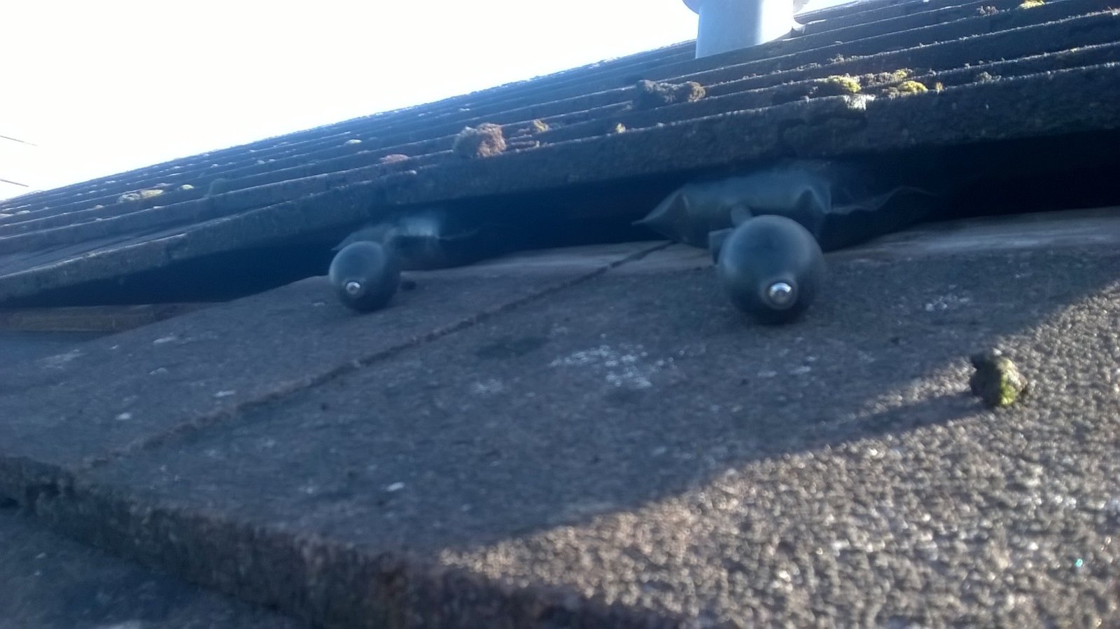

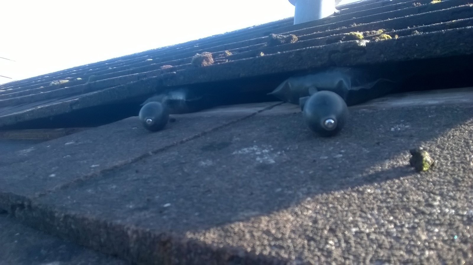

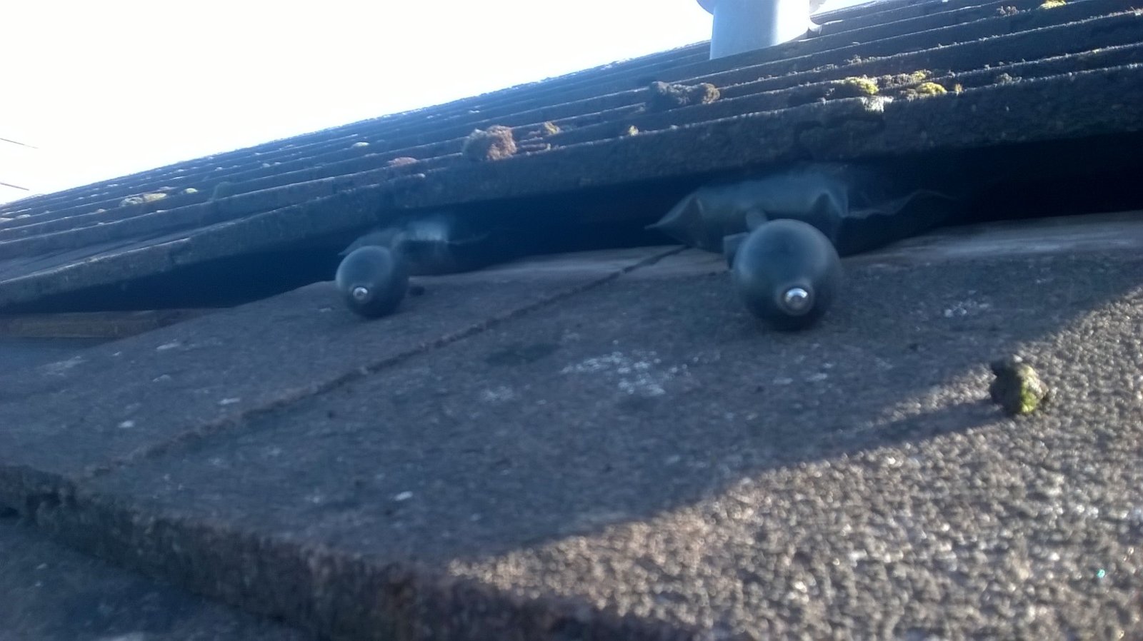

Is the roof easily accessible? I swapped a couple of cracked ones for my neighbour. I pushed in some pieces of wood to lift up the next row then slotted the new ones in, it was much easier than I thought.
Although slower, 06C29FCF-2D39-496D-A3CC-2CE0ABA65FC2.jpeg Winbags give a nice controlled lift if one has some handy:)
