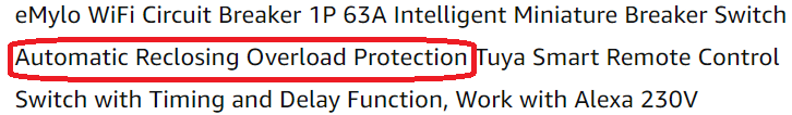

I've been involved with auto reclosers in the rail and energy industry where they are used widely. Typically they hold off for 1-2 seconds and then reclose only once. Useful for things like animals getting fried on rails or wet blown branches causing arcs on hv cables.
That all makes total sense - but, like others, I struggle to see why they would be needed, or even remotely appropriate (or necessarily safe) in a domestic (or, I would think, most commercial) environments.
Said feed circuits always have separate isolation which would be locked and tagged out under a safe system of work. No way would you just isolate the reclosers.
As I've said, that would be my greatest concern about such things in a domestic (or similar) environment.

You really don't need a second MCB, of any type. You can keep the existing MCB supplying the circuit and use that to feed a WiFi-controlled switch/contactor/relay (such as have been described), and then have the ring circuit (both ends of ring) originating at the output of that switch/contactor/relay. The only small issue is that feed from existing MCB to it would then have to be 4mm² cable (or, I suppose, two 2.5mm² cables in parallel), since it would be carrying all of the ring's load..
Many thanks JW and also very grateful for everyone’s suggestions. Yes, an appropriate contactor controlled by a wifi controlled switch module as you have described would definitely be the best route for this.
