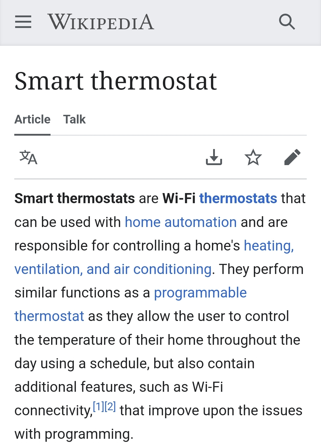

This is the definition of a smart thermostat :)

Since my post I’ve read up on it a bit more and now realise what I was calling a “smart thermostats” will do(ish) what I want!
