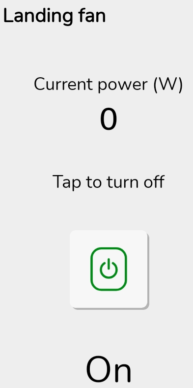

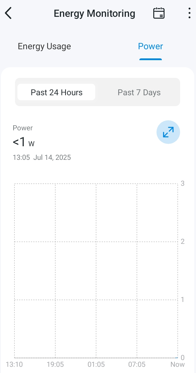

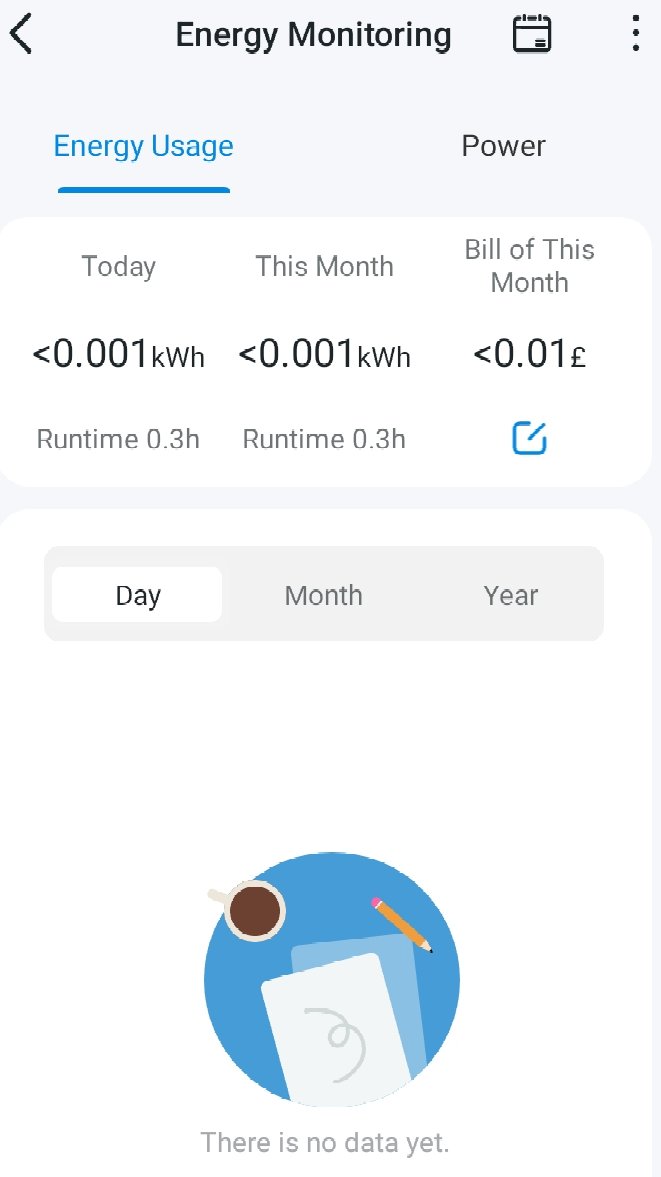

I had to re-assign what one smart adaptors did, it now runs a fan in wife's bedroom, so replaced same make Tapo two version in Screwfix so went for the cheap one, and noted on the box "Energy Monitoring" the much more expensive Wiser one has energy monitoring, 1752494833730.png bit basic, and a delay showing use, but it's a plus, but the Tapo 1752494954869.png1752495013312.png a much cheaper unit, and shows a lot more, it even allows me to enter peak and off-peak prices to work out what it has cost, does not really work for me, as I have solar, so cost depends on what the sun is doing. Last one was P100, it failed after around 2 years, and started acting as a flasher unit, new one is P110, it looks the same, but clearly improved. The first I got was Energenie I still have two, one which only monitors, I use it to test freezers every so often, don't want them by accident turned off, and one will also switch on/off as well. The Wiser one was because the TRV would not work without it, seems very overpriced. I have another one, can't remember make, will need to get steps out to reach it.

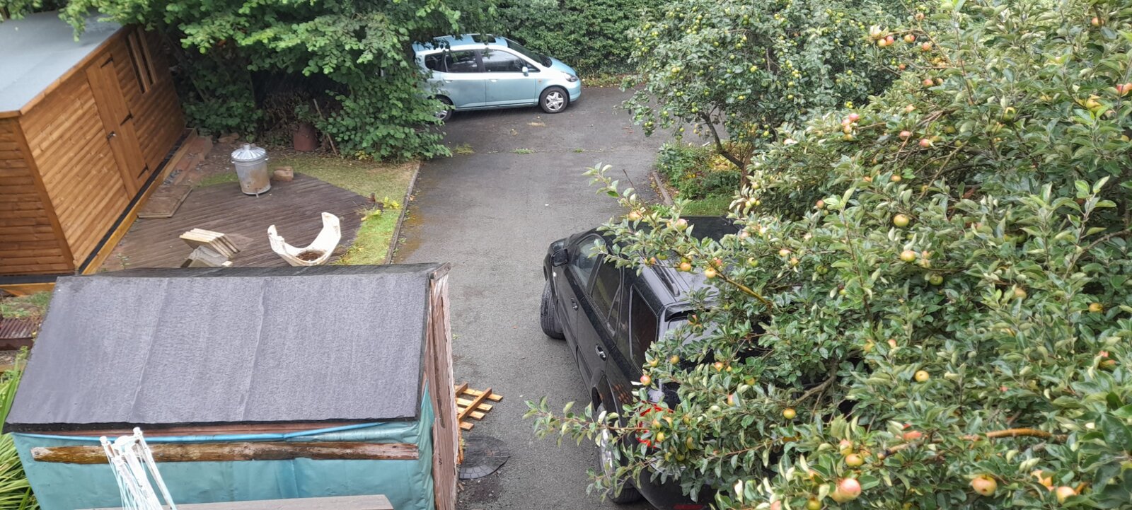

@foxhole I had PIR lamps when I moved in, with I think 300 watt halogen bulbs, when I parked the car at bottom, 1752595725371.jpeg I was too far away for the PIR to detect me, but it would see the car front, (bit with hot radiator) so they would switch on, but unless fast, could switch off again as I walked up the drive. They were already too sensitive, being triggered by wind and trees, and also as I walked past the lamps, and up steps at the side of the house, unless fast they could turn off before I had triggered lamp at the front of the house, and again plunge me into darkness. When the leak on the veranda was cured, the lights had to come down, so replaced with carriage lights with smart bulbs. I can turn on while still in the car, and off once in the house, so far safer, and they do not assist intruders who should not be at the bottom of the house anyway. At the top of the house, still have a PIR carriage lamp, using a Tapo smart switch, which since it has batteries does not need a neutral or power through the lamp, so can set times when it works, I have now over the requirement for outside lights, eight in all, two hardly ever turned on, light way to front door which no one uses. The pedestal lamp on the edge of the pond is really all the visitor needs, and I turn it to green on Halloween to show we welcome trick and treat. The one at the corner of the house by the door everyone uses is an integral lamp, so powered with a P100 Tapo socket adaptor. And the bulkhead light side of the house under the eves is also normally powered with an adaptor, but at the moment relocated to work wife's bedroom fan. This again good reason for adaptors rather than smart sockets, as can move them around.

We had an old shed, which we still needed until a new one put up, but was going to go, and an apple tree on the other side of the house, so to fit PIR's
clearly could be done, but would need to be a battery type as shown, so still need smart bulbs or relay of some sort, so the PIR costs around £15 extra to working the lights without, so why bother? What would a PIR do to improve the system?
