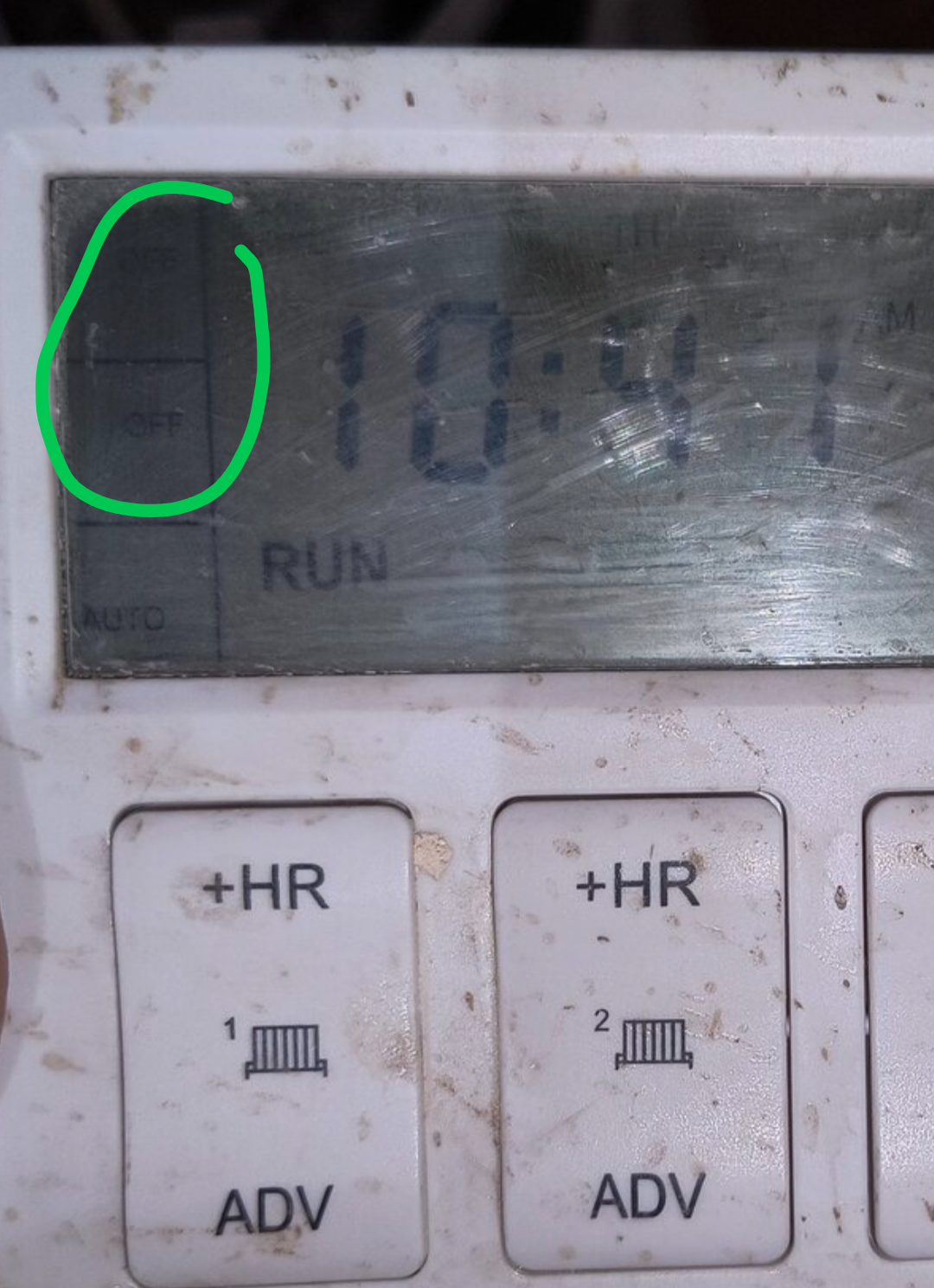

The important bit's hidden under the stairs - she doesn't even know it exists and just thinks we live in a cold house:

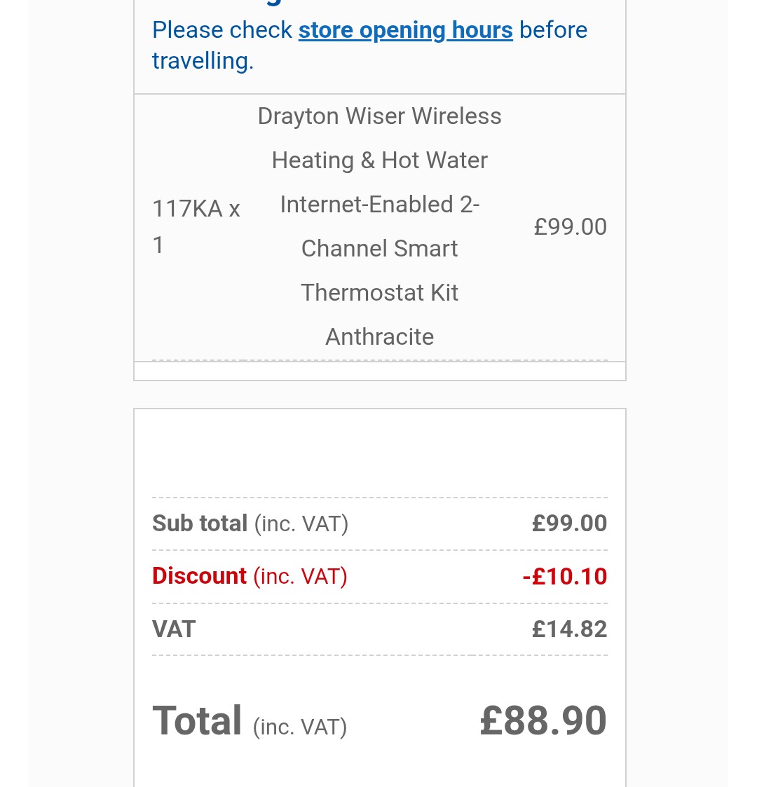

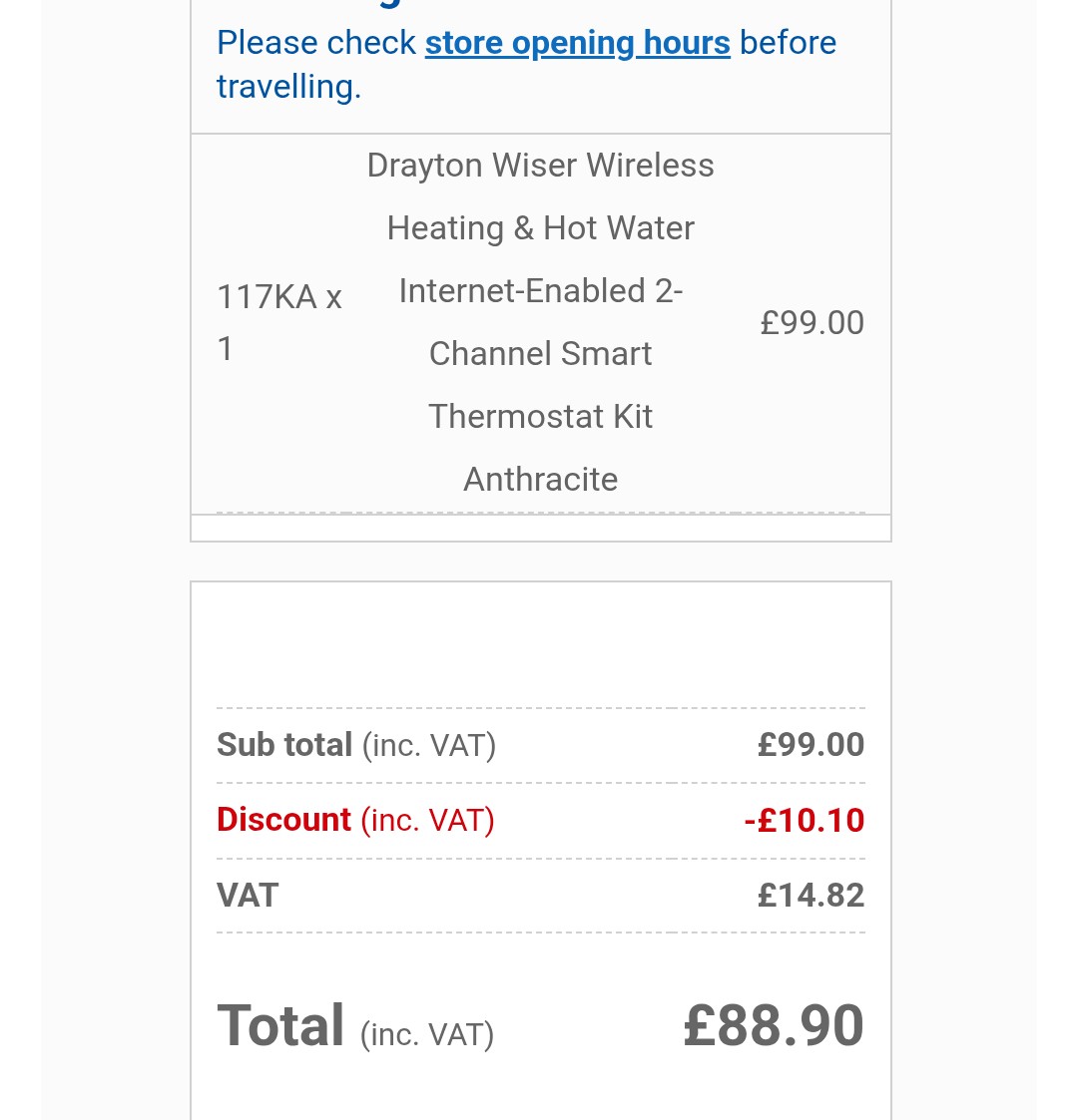

I've ordered this from Screwfix:
They didn't have the 3 channel version in stock and it's silly prices elsewhere.

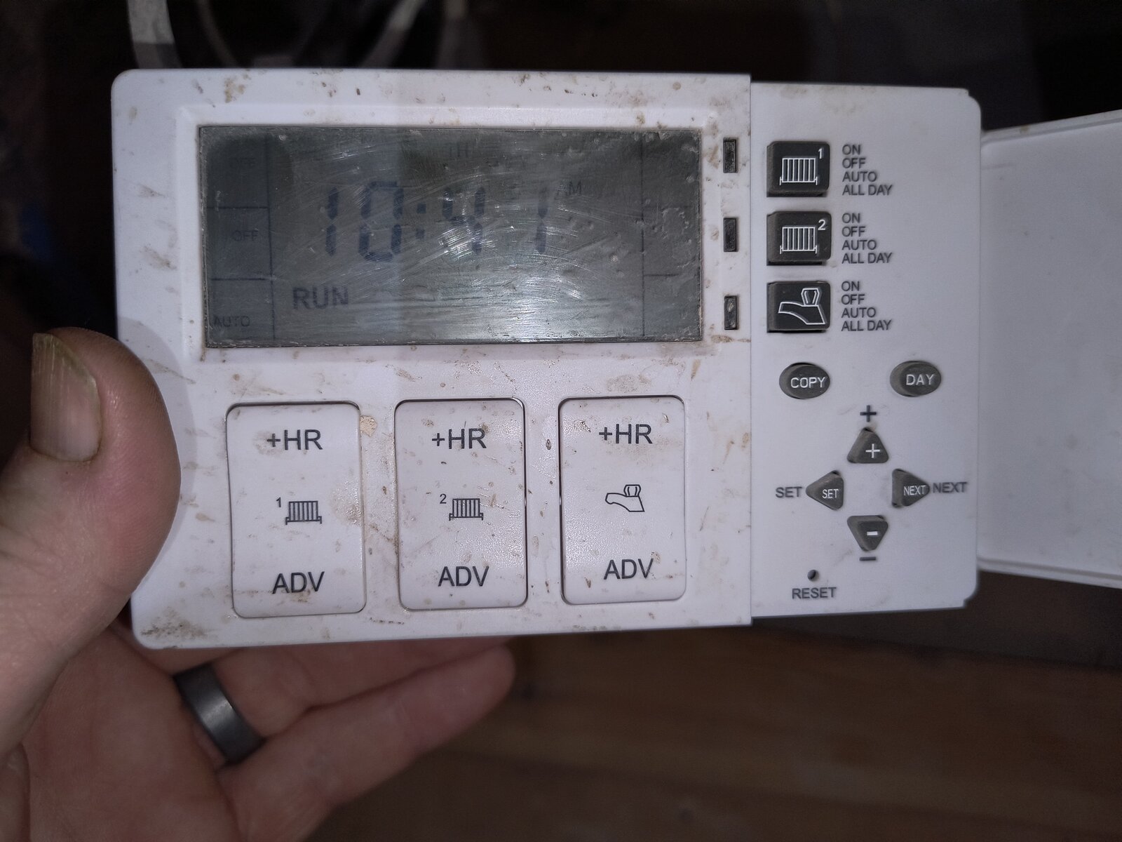

So assuming I'm happy with the way it works I need to address the sub zone in the longer term - presumably by upgrading the 2 channel to a 3 channel - but I really don't want a second stat on the upstairs landing (which would if nothing else have no bearing on the temperatures required in the individual bedrooms) - hence the current system - we never want upstairs on with downstairs off but regularly want it on for part of the period when downstairs in on!.
As I understand it, my current wired system works by the programmer sending power to the stat in the on periods and the stat (if calling for heat) switching everything on via the 2 port valve (the sub zone is just the second 2 port valve opening when the programmer tells it to)....

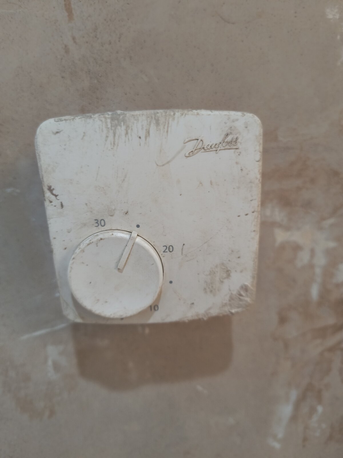

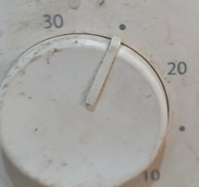

When you connect the Wiser you will need to loop the old thermostat at the wiring centre otherwise the heating will never turn on.
To get both heating zones to operate as one just rewire the wiring centre so that the orange from zone one valve is connected to the brown of zone two valve.

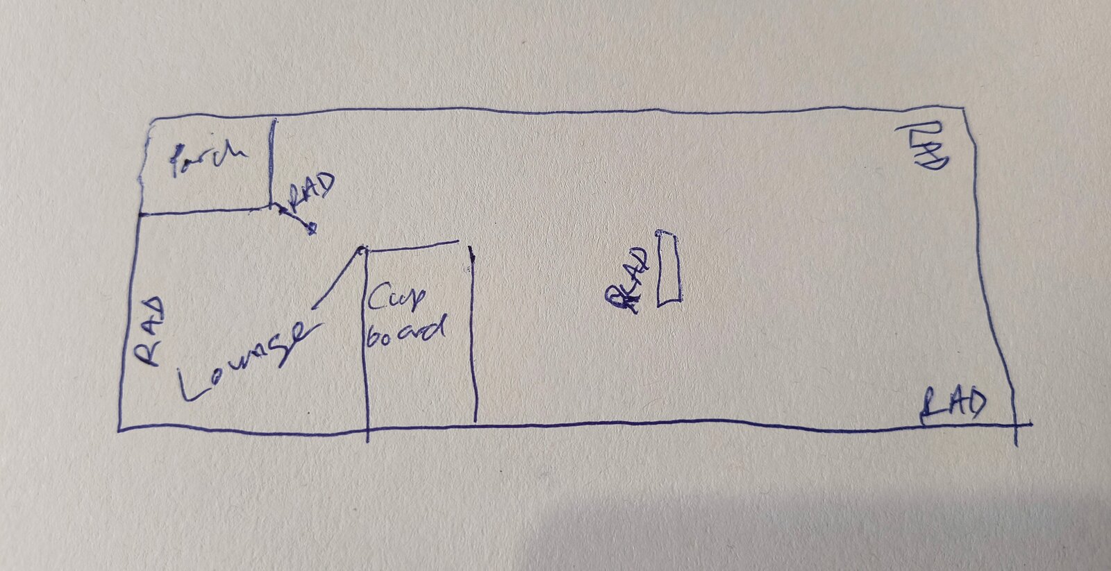

Downstairs is a large open plan area with a lounge that we never shut the door to:
This is heated as a single unit, balanced with standard TRVs - I have no desire anywhere to have a single radiator on with a fancy TRV running my ancient non modulating 15kw boiler.

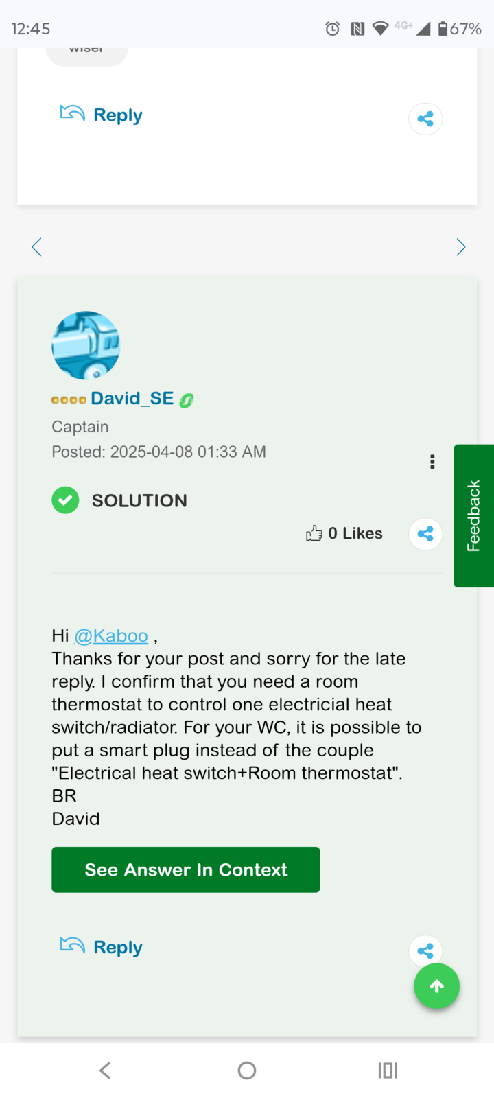

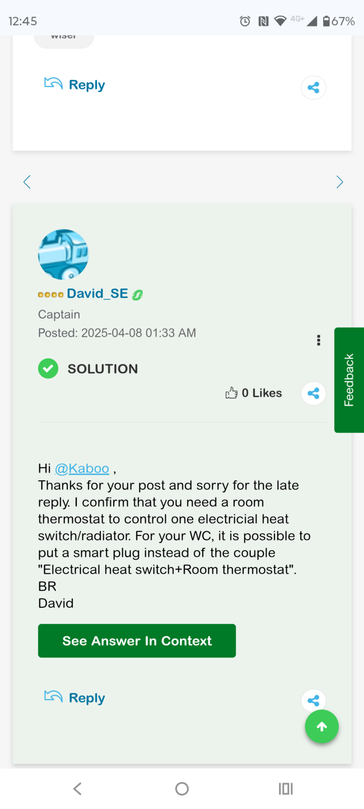

Just been on a German Schneider wiser forum and found this reply - it relates to a question about using a heat switch for a towel rail but seems to confirm that you won't get anything out of the hub without a stat.

You could use the wiser plug as you said but you won’t be getting the best out of the system. Wiser expects to have control of the heating throughout the house so that it can learn how the house heats and cools. This info is fed into the hubs algorithm so that Wiser knows when to turn the boiler on. @ericmark has issues with his heating because he has multiple different systems that don’t integrate with each other.
The heat switch is for electric heaters and only works with a room thermostat.
