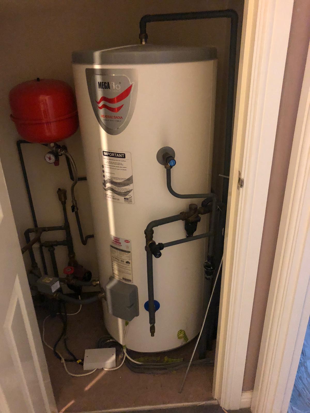

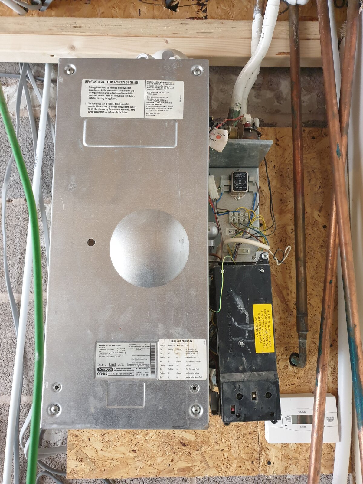

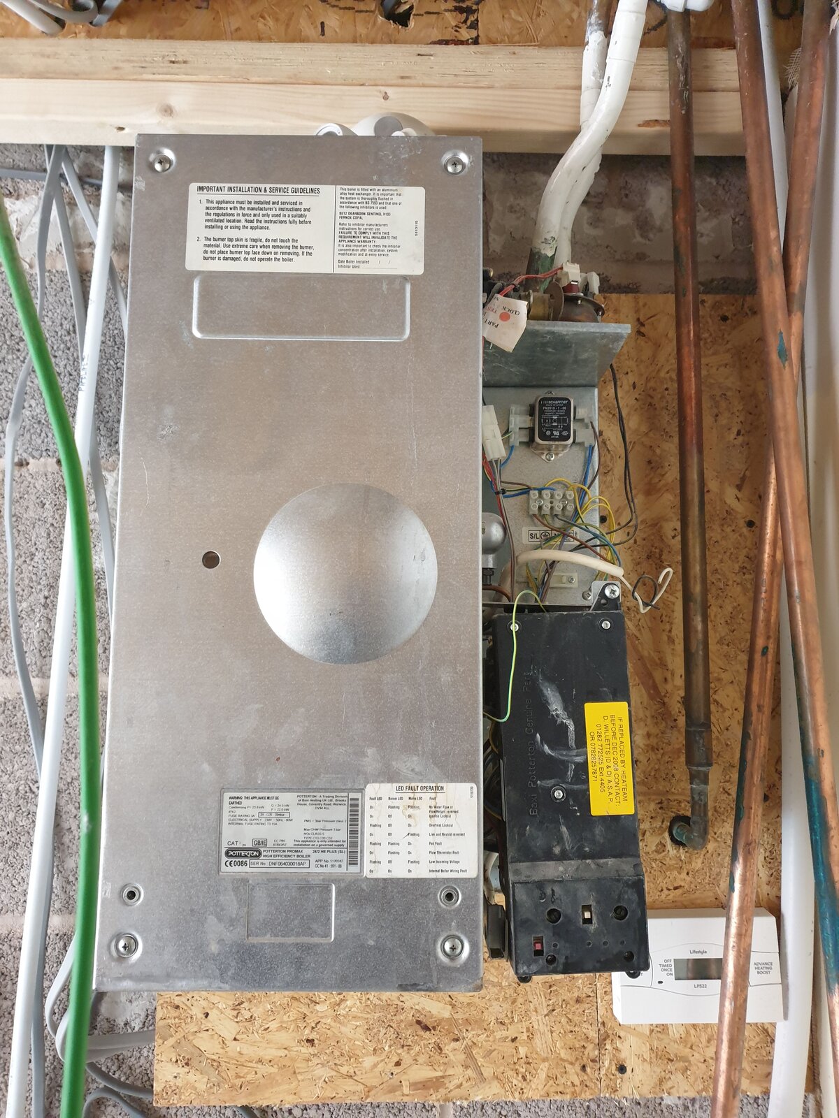

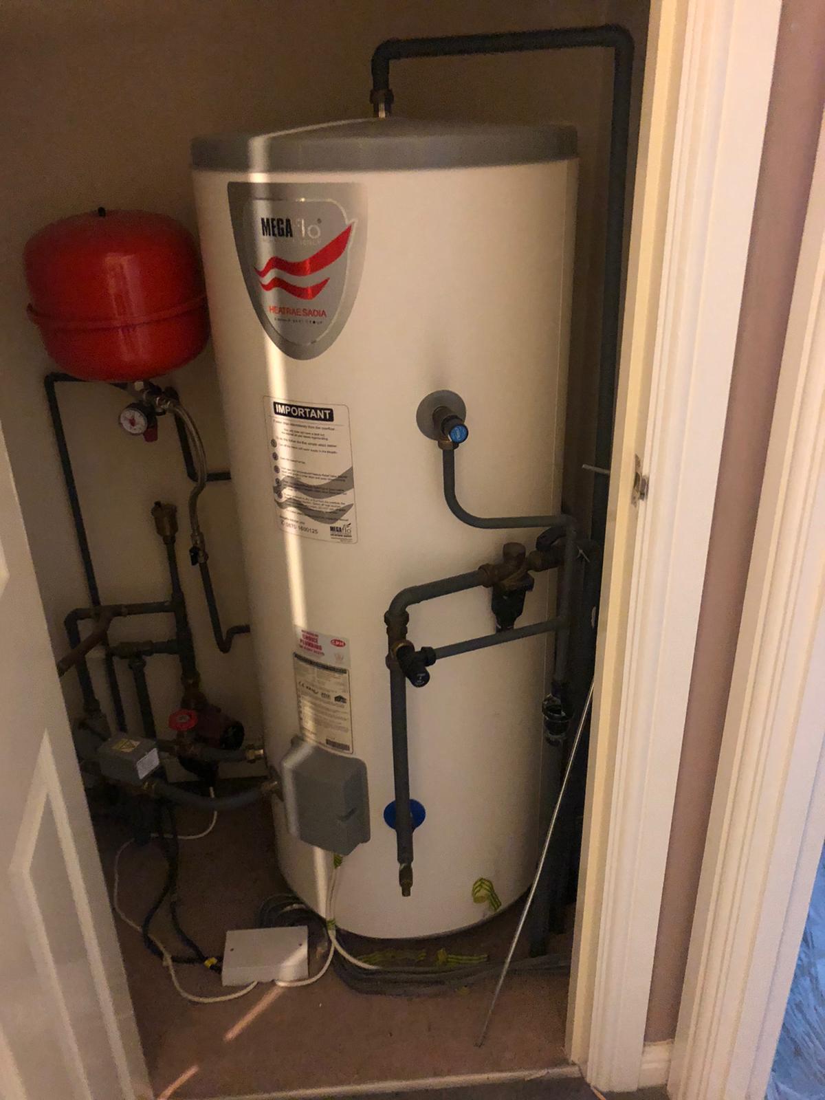

Hi guys,
Hoping I can get some input on a subject related to an extension I am currently having done. My set up is that I have central heating in the majority of the house but as part of my ground floor extension, I am having a water pipe underfloor heating system fitted.
I have a megaflow tank (picture attached) and a potterton boiler (picture attached). My underfloor heating is a grundfos 2 zone manifold with Hetta aluminium pipes.
My question is on timers and thermostats. What exactly do I need? I have purchased 3 Google Nest E thermostats (Presuming I can use one for the main house central heating and water with the other two each controlling the underfloor heating zones). Is this sufficient for me to control my heating and hot water timers etc or do I need a dedicated timer? The reason I ask is because my builder has gone ahead and fitted a timer already (a "Lifestyle LP522") but he's confessed he doesn't really know much about smart thermostats and what functions they can/cant replace.
I do want to go the smart thermostat route, I understand the nest learning thermostat 3 can do more than the Nest E, I'd be happy to buy one of these if it removes the need to have a separate timer.
Appreciate any guidance!
Thanks,
Steve

You'd be much better off returning all your Nests and buying a proper system designed to work with multiple zones and underfloor heating. Some UFH systems require floor sensors to be connected, to prevent the floor getting too hot, and if that's the case with yours you'll need to buy a smart stat system that can accept a floor sensor. Heatmiser Neo is a good option in that case, and in any case if all you want is a system to control your heating.
Other than that, the Salus Smart Home range is very good and very reasonably priced, with the option of adding in extra things like smart plugs, immersion heater timers, smoke detectors etc etc.
Thanks for the comment. I just wanted to run all of my heating and hot water off a single app and I understood the nest ecosystem to be one of the best along with Hive systems.
Nest is best suited to single zone applications really. Hive is rubbish. The ones I've mentioned are much better suited to what you're looking for, especially as you have UFH which requires different control algorithms to radiators
ok thanks, understood. So am I best off discarding my nest thermostats all together or can I use one nest for the house radiators + hot water, but adding a heatmiser for each underfloor heating zone? Is the alternative to put in a heatmiser setup across the whole house?
You could use Nest for some bits and Heatmiser for others, but then you'd have to have two different apps, which would get annoying fairly quickly I think
Thanks - I am tempted to leave the lifestyle thermostat in for the main house and at least give the nests a try with the underfloor given I've already bought them. If they are no good, I'll replace all with heatmiser setup
you can use the 3 Nest E to control your 3 heating zones and set the heating on the lifestyle to constant and use the lifestyle to control the HW if you want a nest to control the HW you will net to swap one of the Nest E to a dual channel nest
EPH are designed for zones, but does not seem to have any ability to connect to TRV heads, Nest no longer works with Energenie heads, Hive is not smart in any way and so the list goes on, there is no perfect system. Each system is a compromise.
