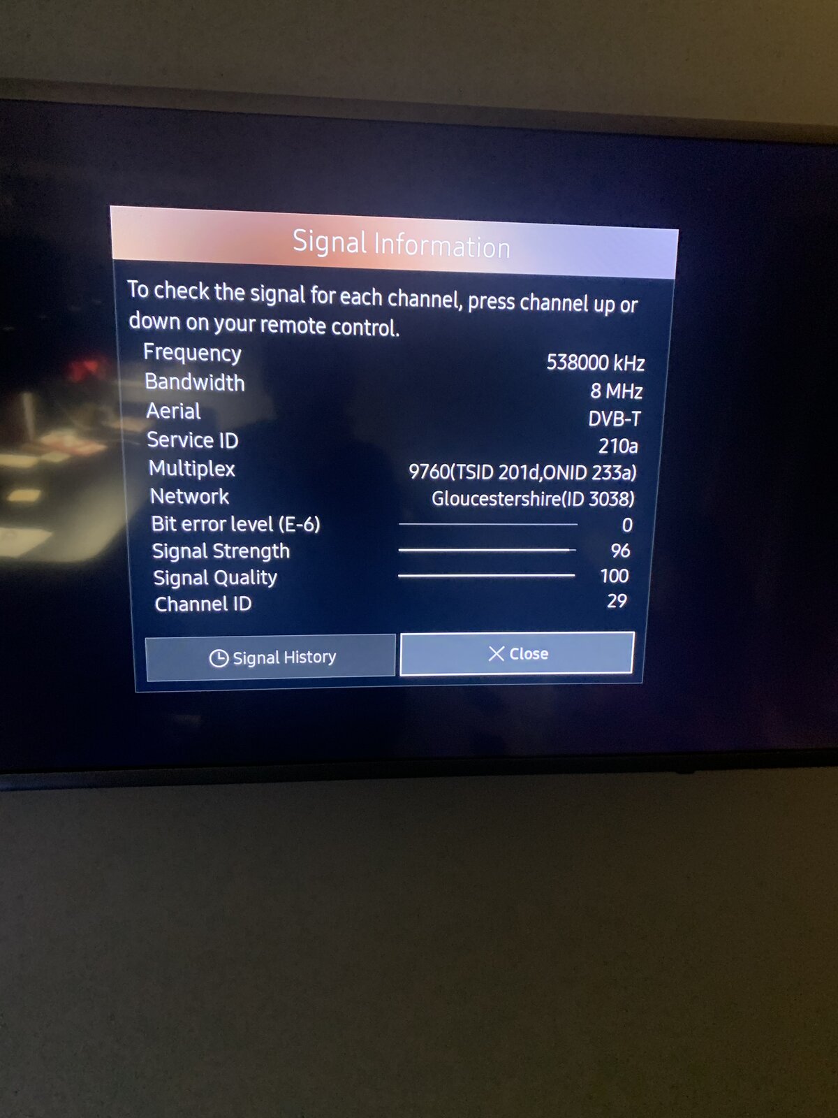

it’s strange as ai get no picture issued on the other tv in the lounge and the signal bar is a lot weaker than the one in question.
Its not the strength of the signal it is the quality signal thats important - check that measurement
do you get both a Signal Strength and Signal Quality measurement
On i TV I have low signal but high quality
Varies on differnt MUX
CH24 498MHz (Ch1 - BBC1) is 100% for both

CH28 530MHz (Ch23 - DAVE ja Vu) is strength is 60% , but quality is 100%

is that pixelating now
100% Quality
But you need to check all the MUX for quality as i say use the freeview site for your transmitter
I'm using the rowbridge transmitter and you can see the MUX and the channels
So if you find your transmitter and then look at a channel for each group and check the quality on those

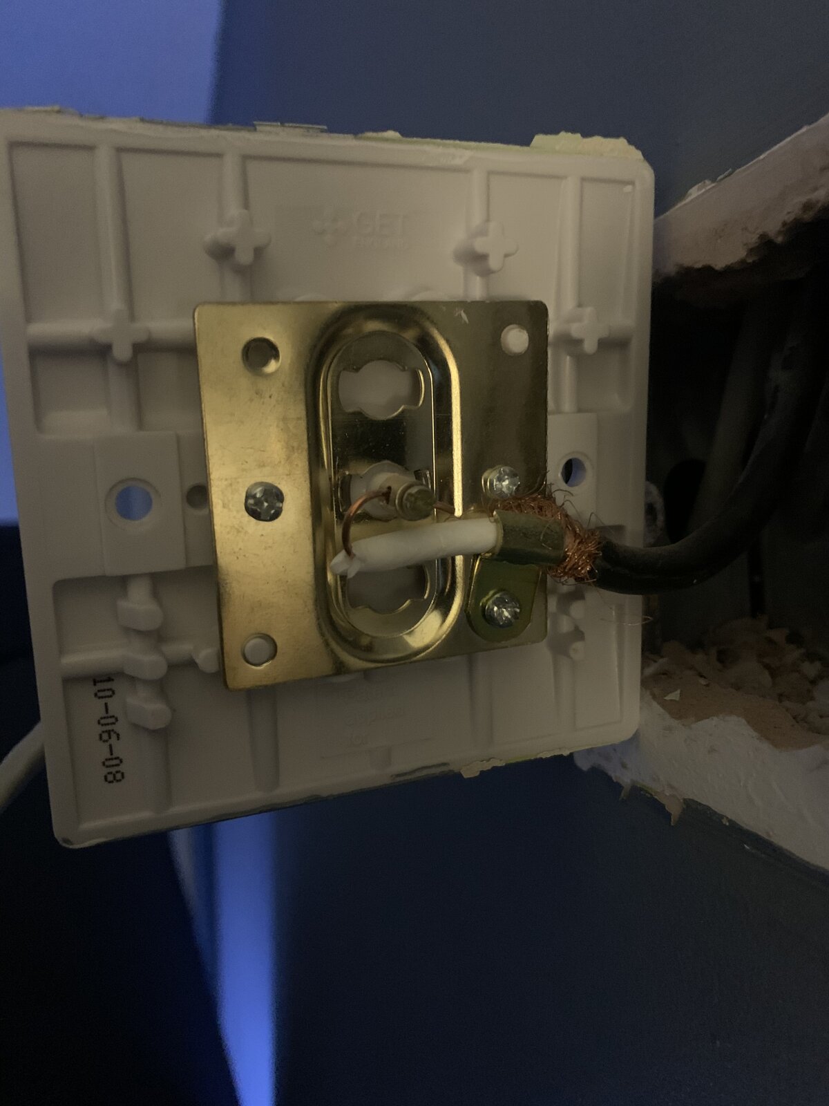

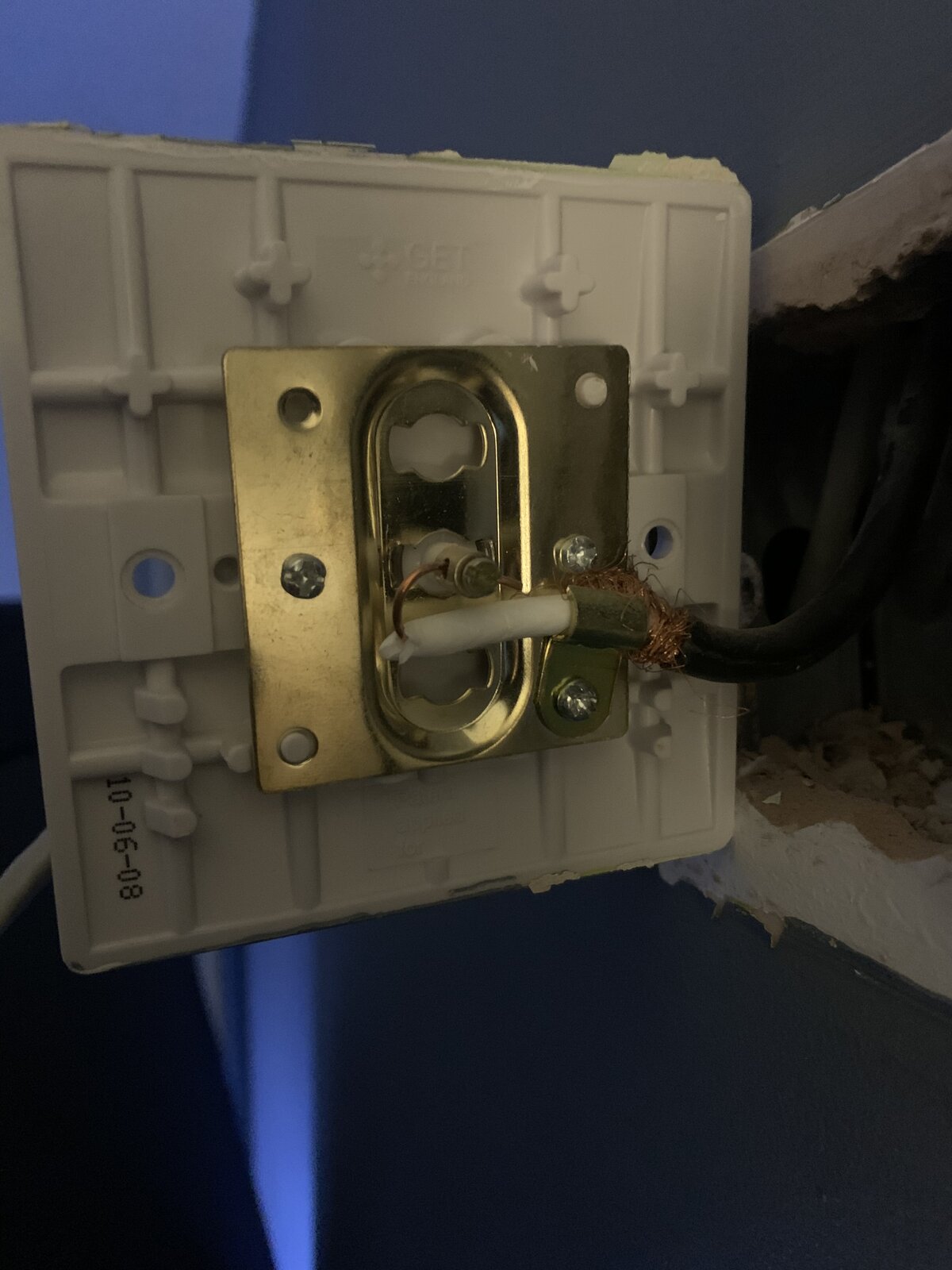

this is the socket plate...View attachment 214972
That's an unshielded wall plate. You can tell it's unshielded because it's possible to see the coax inner core and a lot of the braid.
It could be installed a lot better too, and that might help reduce some of the signal problems to that TV. Here are a couple of examples of how the cable could be better prepped.

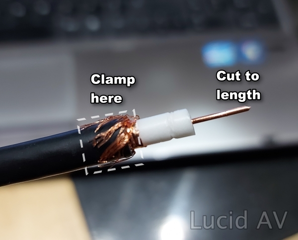

In this image the braid and foil are trimmed but left sitting over the inner insulation (dielectric). This is going to suit a wall plate where the cable clamp has a small radius suitable for thinner cables than our RG6-sized coax.

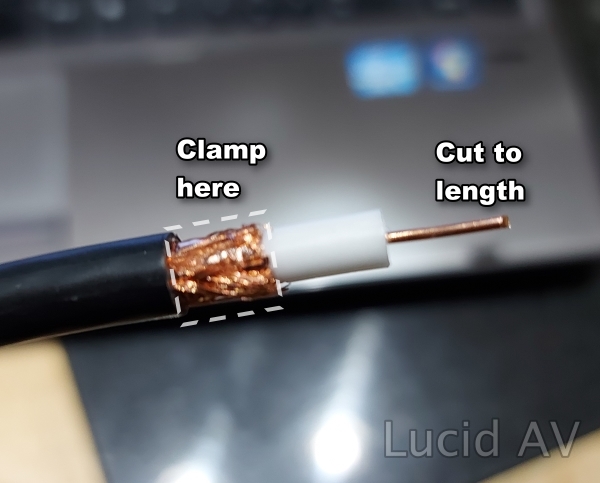

In this this next image braid is folded back over the outer insulation. This makes the clamp point a larger diameter.
Both methods are equally effective from the point of view of making an electrical contact for the ground connection. Choose whichever method produced the least cable distortion as the clamp is screwed down.
The inner core should be on a straight path from the shield clamp to the core screw clamp rather than bent back on itself as shown in your image. Trim back any excess core length and braid tails. Make sure no loose filaments of braid short between the shielding and the core.

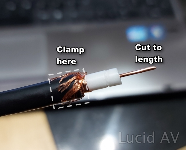

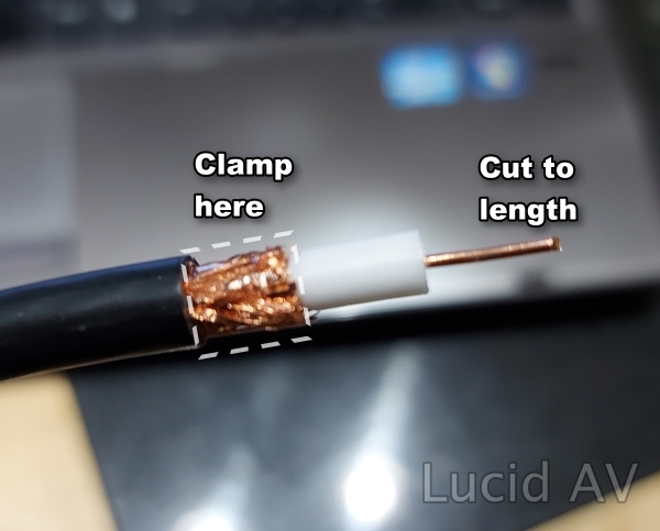

According to the info you posted from the screen shot you're on the Gloucester Lark Stoke transmitter. Is that correct? If so, then there are 6 muxes all transmitting at around 2,500W I think. The point here is that there's no variation on power between the muxes, and so any big variation in reception strength is more likely to be down to the aerial and distribution system and its cables and connections.

I checked the cable and there looks like a short. I have remade the cable end at the booster. It’s worse. I have a bit error of 2000 now.
Ok not a short on the cable but the socket was shorting so remade that again.
remade the other end plug again and so far so good.
