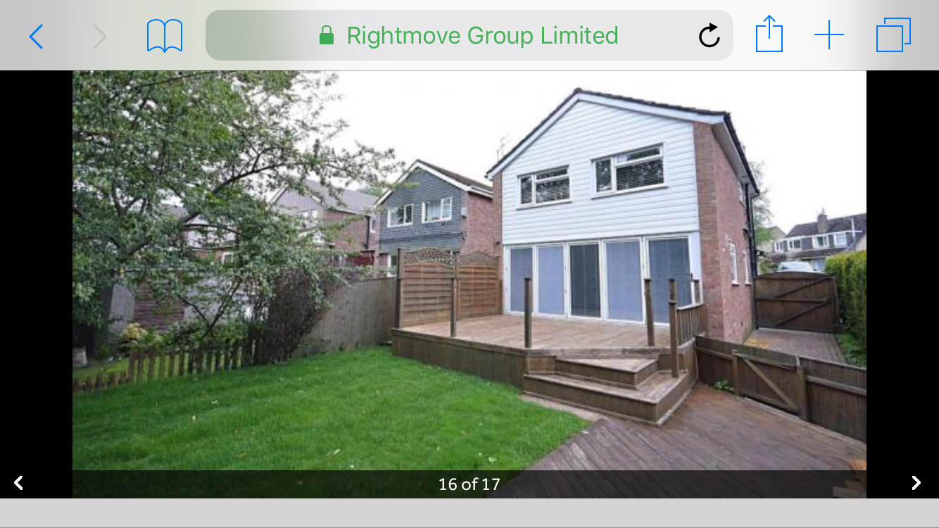

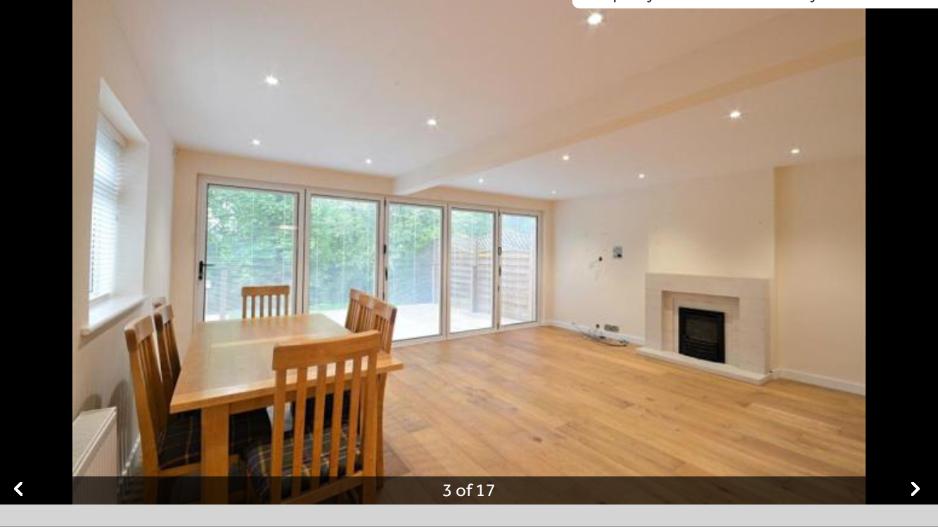

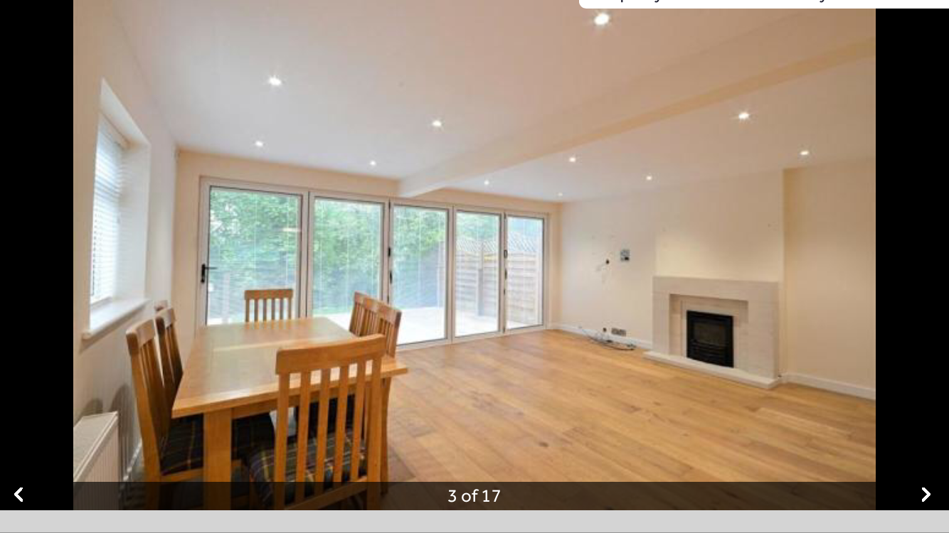

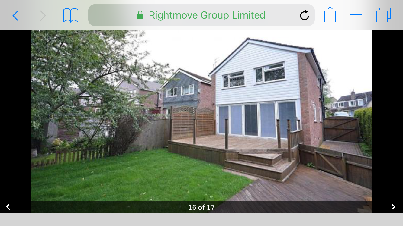

I have these doors in my house but 5x 1.2m with the traffic opening on the the left.
Had a couple of issues with mine when we moved in but I suspect they were installed by builders not proper installers.
Precision aluminium were very helpful and came out to service them and replace some seals and gave guidance on the locking issue I had. I have two internal handles to release the opening mechanism.
Sorry can’t help on the profile choice but I like the doors and pleased now the mechanism has been sorted
Hi, so assume one door open on frame side and the other back onto another door? Do you find the door size manageable, I'm staring at some 1200x2400 temporary boarding at the moment and it looks WIDE :) plus we've kids, just wondering if one would get pinned behind it swinging open or the wind catching it, guess that can happen with any door though. Whats the cill is it installed flush? Thanks
Good point foxhole but 1200 is the maximum (for Smartsystem anyway) so with a three door, going smaller would oversize the other two but was not something I'd considered, so thanks for the suggestion.
Sorry, I missed your reply. My opening door is on the far left looking out into the garden.
It hinges on the 2nd door and then utilises two release handle to Fold the doors across to the right.
They are large doors but hinge very well. We changed the lower seal as it scrubbed the bottom of the door. Using a lower profile one made it easier to open and close and it still seals very well with no drafts.
One thing to consider is the layout and furniture in the room. We have a Welsh dresser just before the doors and it restricted access slightly to the door handle so we moved it slightly into the room. My 3 year old manages with it quite well. You can buy magnetic door matches to hold the main door open but we choose to close it.
There is a small cill externally and the decking sits nicely underneath so there is no height transition from inside to out.
Hope this helps, taken from the for sale advert.
There isn’t a cill on the decking, the frame just sits slightly higher
