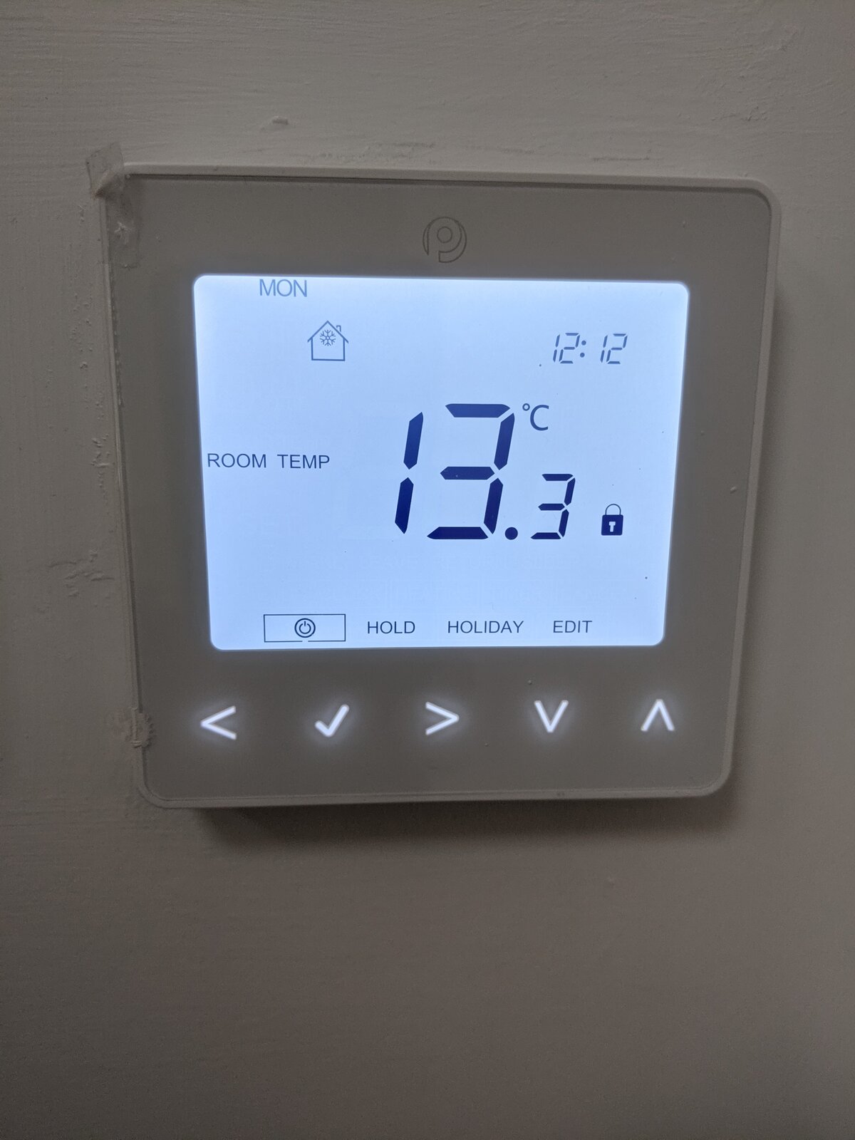

Other half was fiddling with controls trying to edit time and date but went on the wrong button and unknowingly activated the screen lock. No clue what went in as pin number.

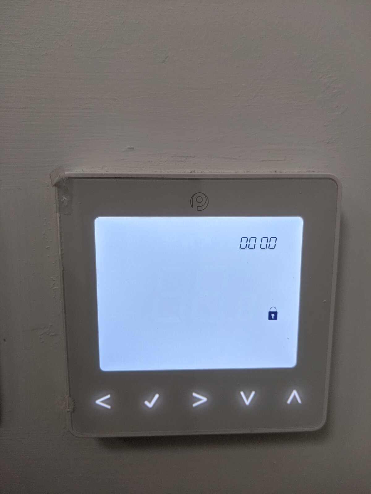

the home screen displays the current temp, date and time etc but when you want to turn up the temp or edit anything i am presented with the locked screen , see the second pics
