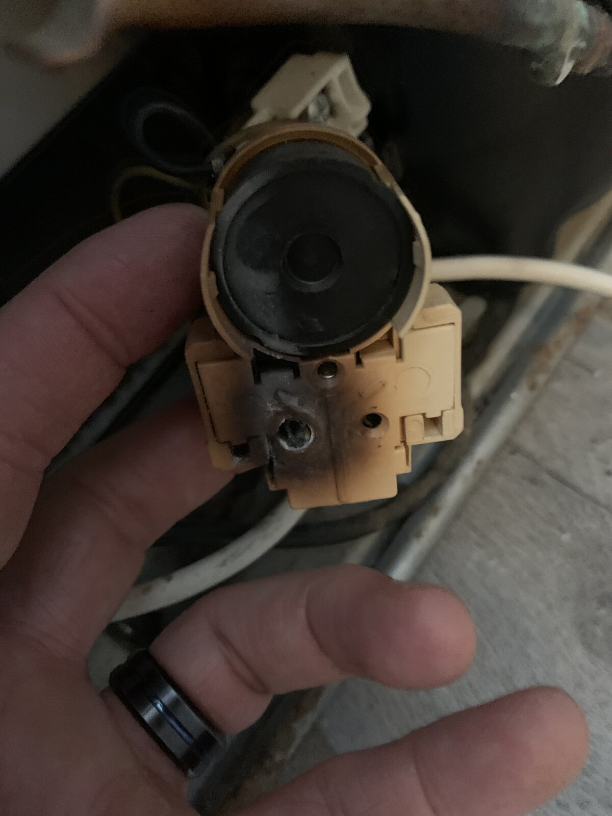

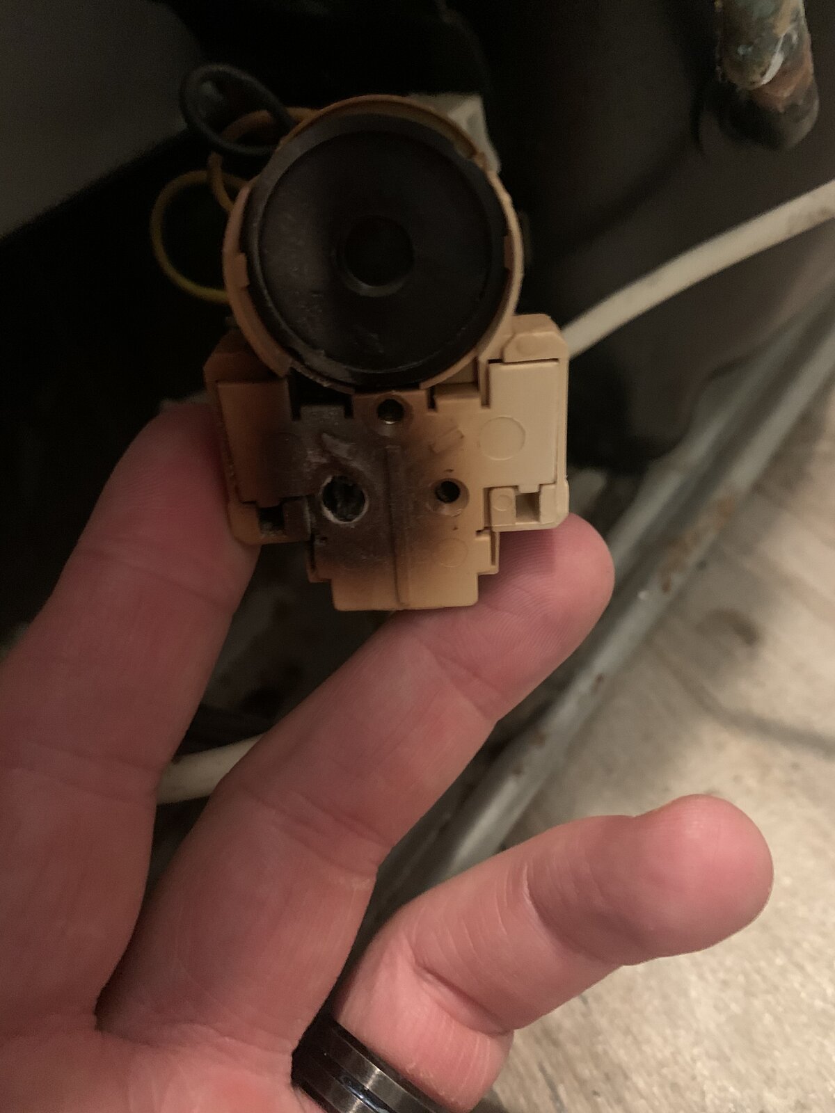

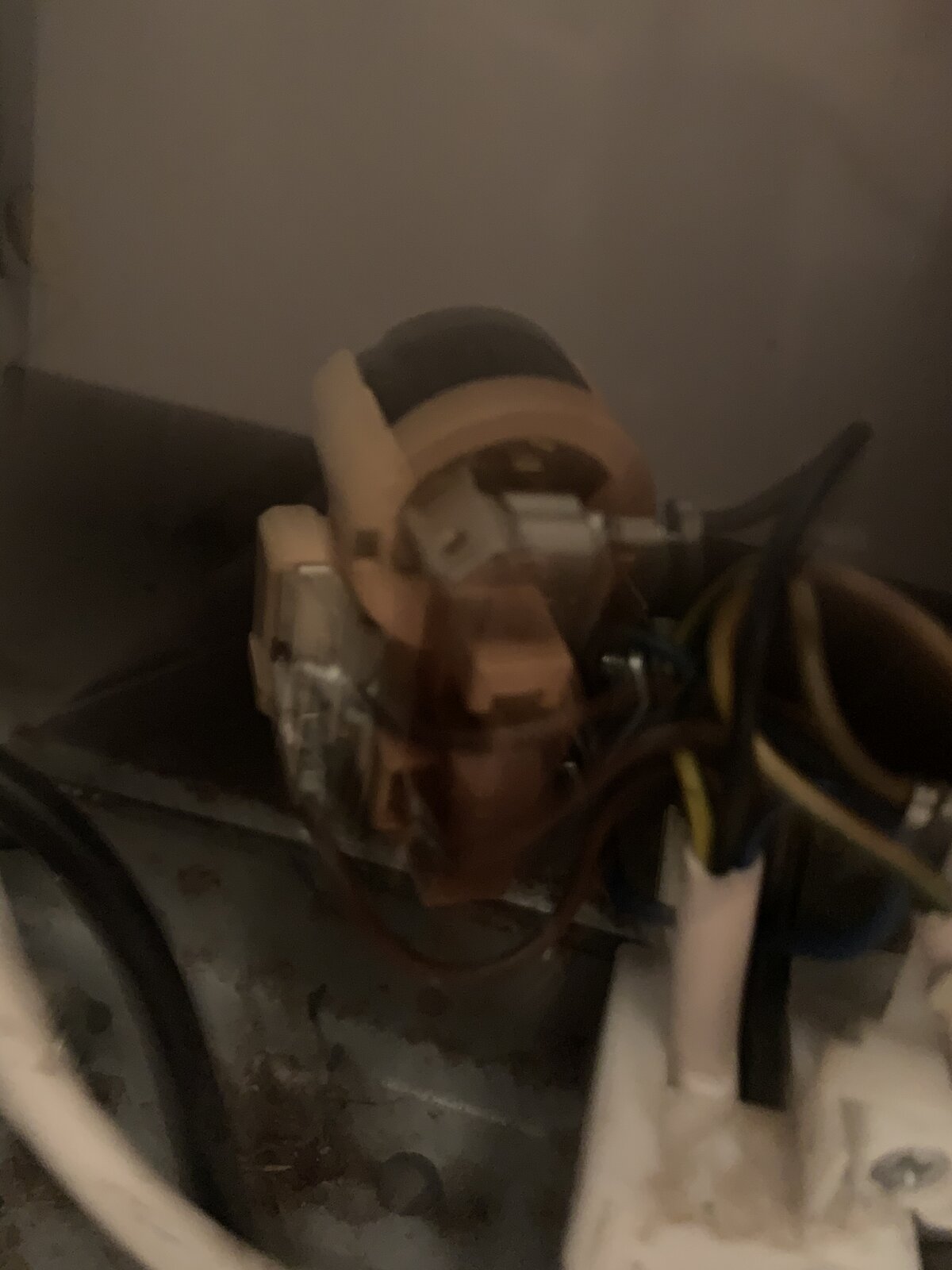

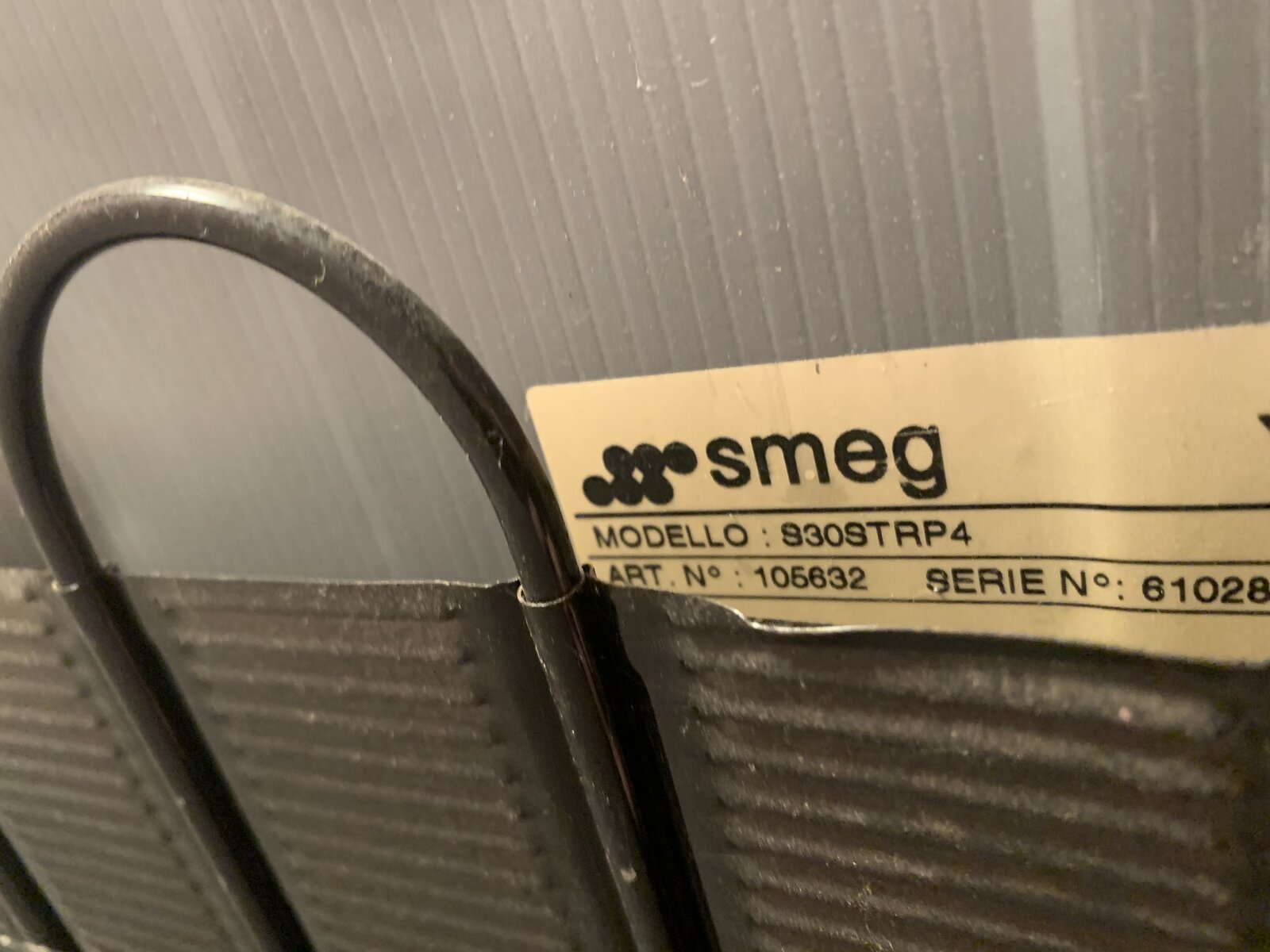

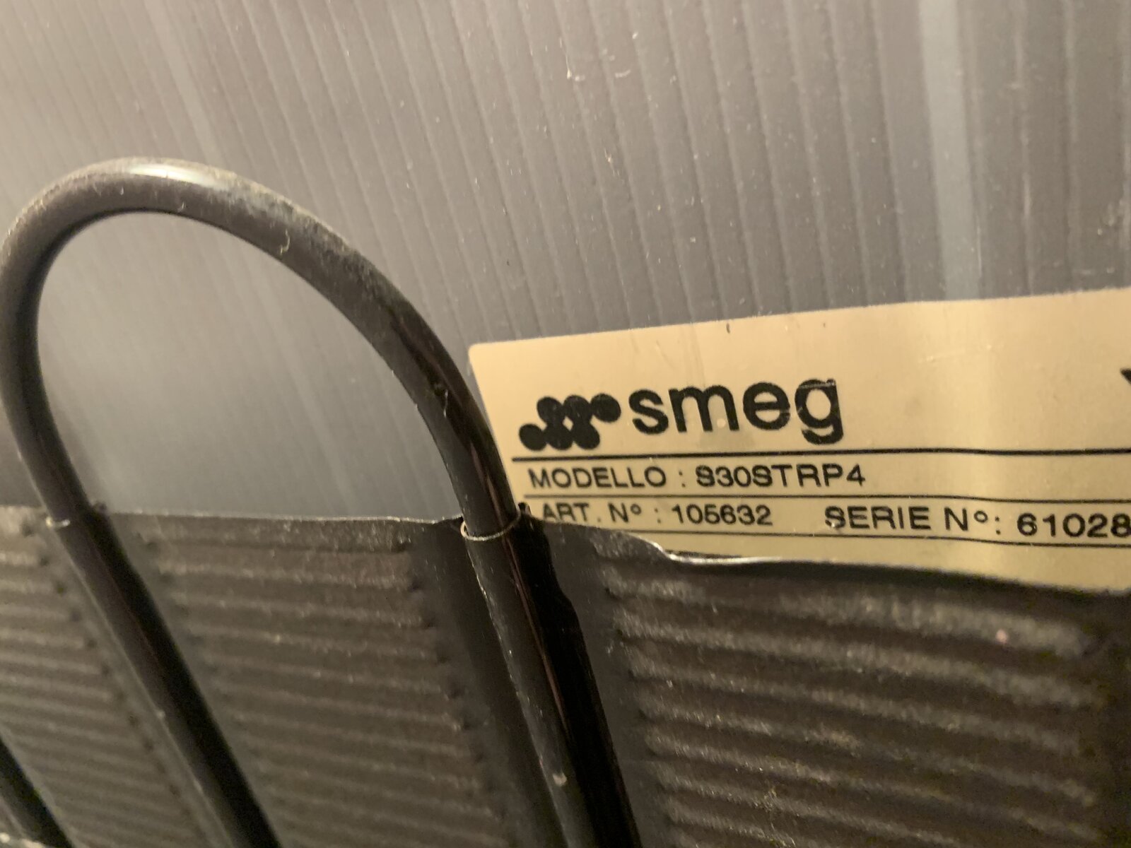

We have a smeg fridge freezer model S30STRP4 that stopped working

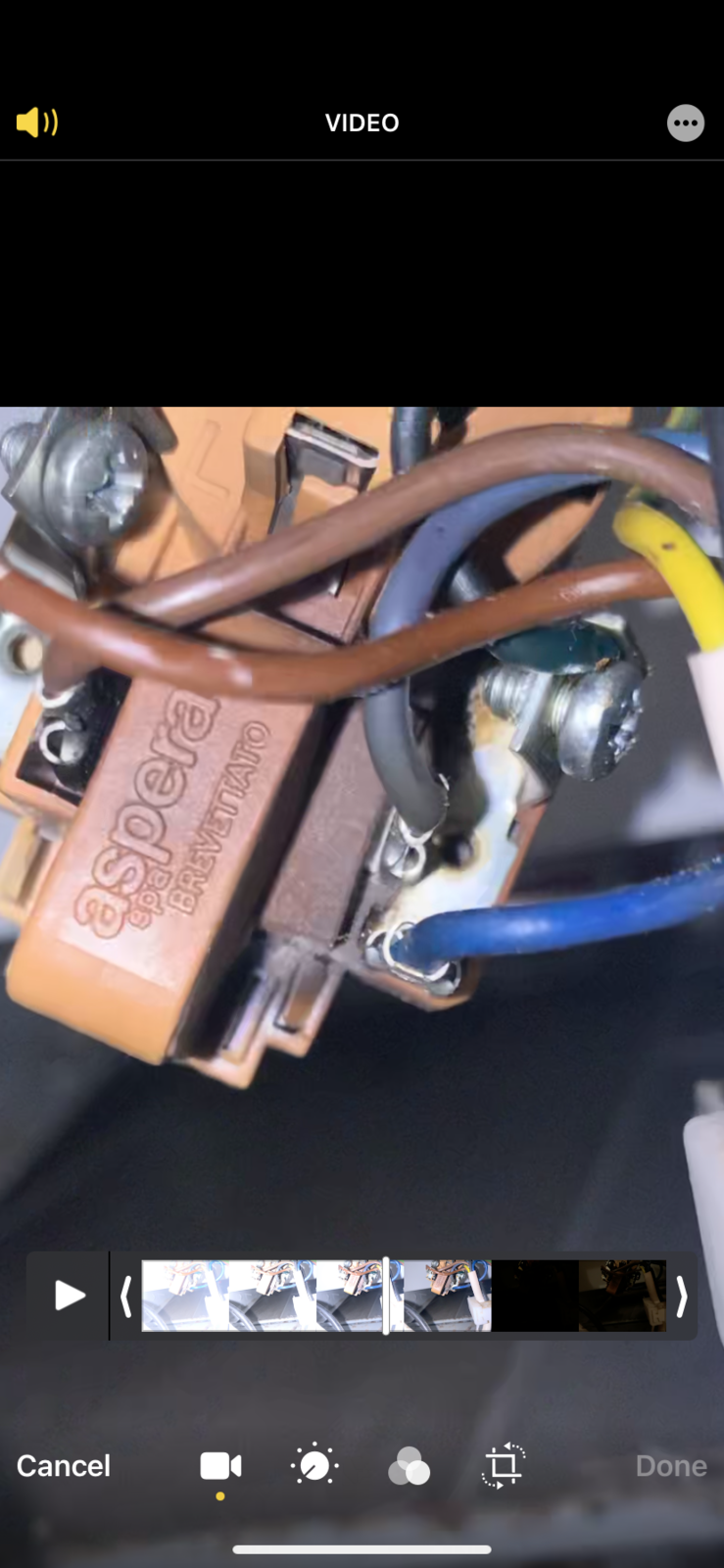

After trying various things it appears it was a lose wire near the relay (what I think is the relay anyway)
Upon closer examination it appears burnt and damaged
The current relay says “aspera spa brevettato “
Upon searching this on spares websites it appears to not be compatible with the fridge.

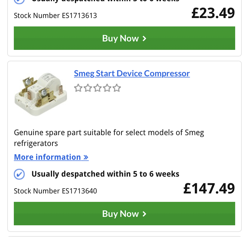

The parts websites suggest at 103N0050 relay that looks nothing like the existing damaged one I have.
Also there appears to be a massive variation in costs for this part (up to a £130 difference ) depending on which website you check
Any help would be much appreciated
(If I can work it out I will add some pictures)
Many thanks

Yes it is thank you it does have something in the circuses it is although mine has something in the circle part. And mine is brown prob through the burning

They have a brown one on amazon & parts master but it's out of stock on both sites.
Thanks so much for all your help. Stupid question time
The part you located looks exactly the same but on the website doesn’t show it’s compatible with smeg. Does that matter if I’m changing like for like ?
When I go to differ at websites it recommends a relay that looks different but is apparently for my smeg model.
Basically I’m asking is it ok to get a slightly different looking relay or do I need to replace like for like
Many thanks
