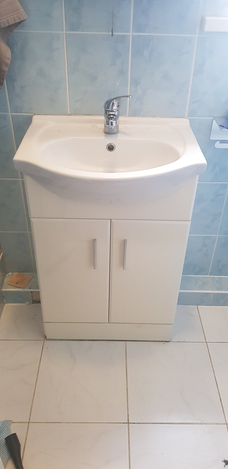

Quick one, i have a very old vanity unit and a pedestal trap like this one
https://mcalpineplumbing.com/traps/tubular-traps/x10-straight-through-trap
In the past couple of days we noticed sewage smell coming from there.

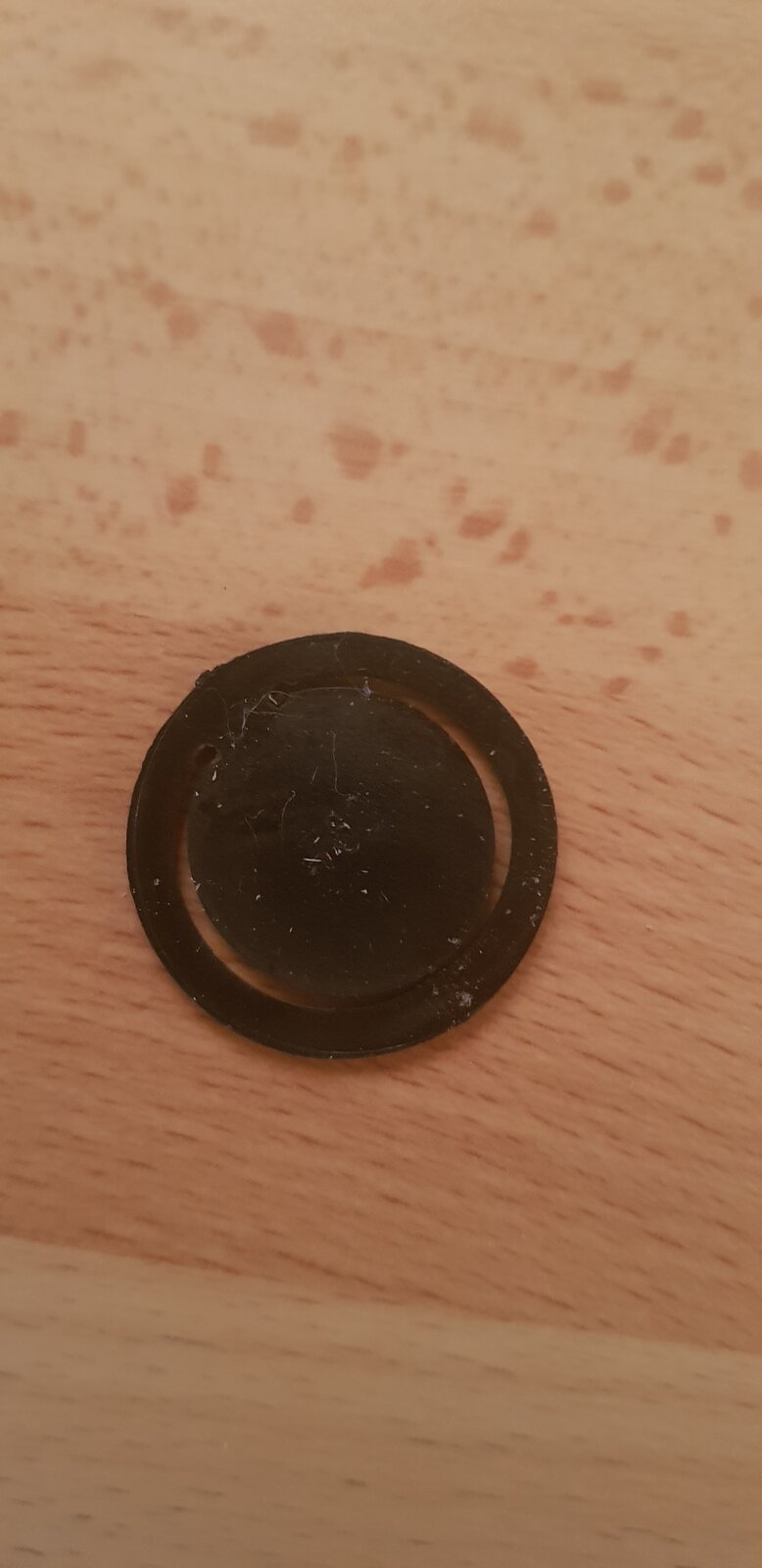

So my next action was to replace the blanking washer on the rodding eye with one from another trap.
The original washer has a slit all along the rim, that's how it's manufactured, it's not cut, see picture.
This washer, although not brittle, has become quite hard.
The one I fitted now hasn't got that slit, it's just a rubber disc.
Could this be the culprit or is there something else you can suggest?
I suppose if the problem was with the rodding eye washer I will know in the next few hours, but your input is appreciated.

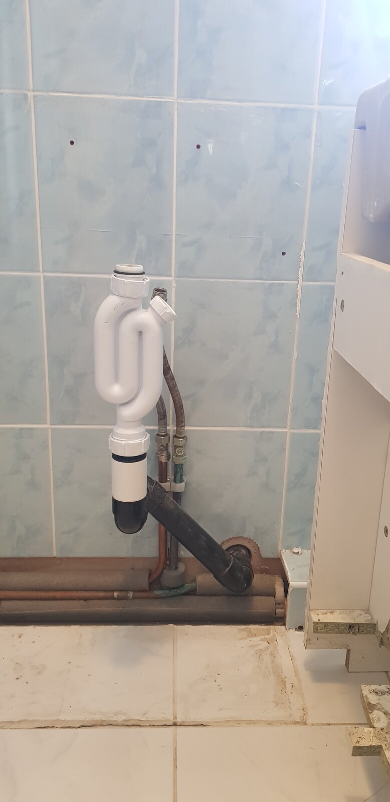

I'm going to remove the vanity unit and take a picture, bear with me please.

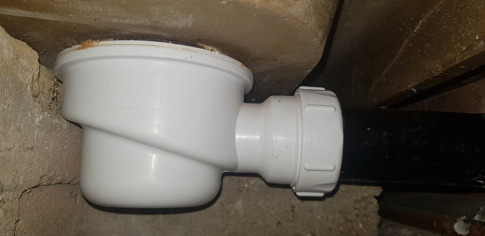

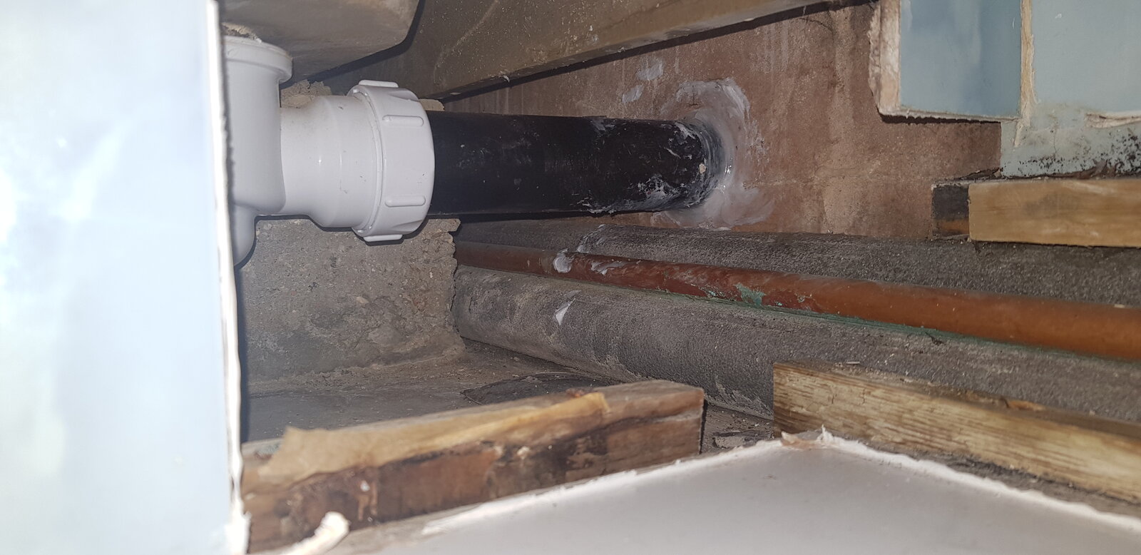

Ok, here are the pictures.
After dismantling the vanity unit i found that the smell doesn't come from its pipework, but definitely from the area where the shower trap is.
No leak, all perfectly dry.
Any idea?

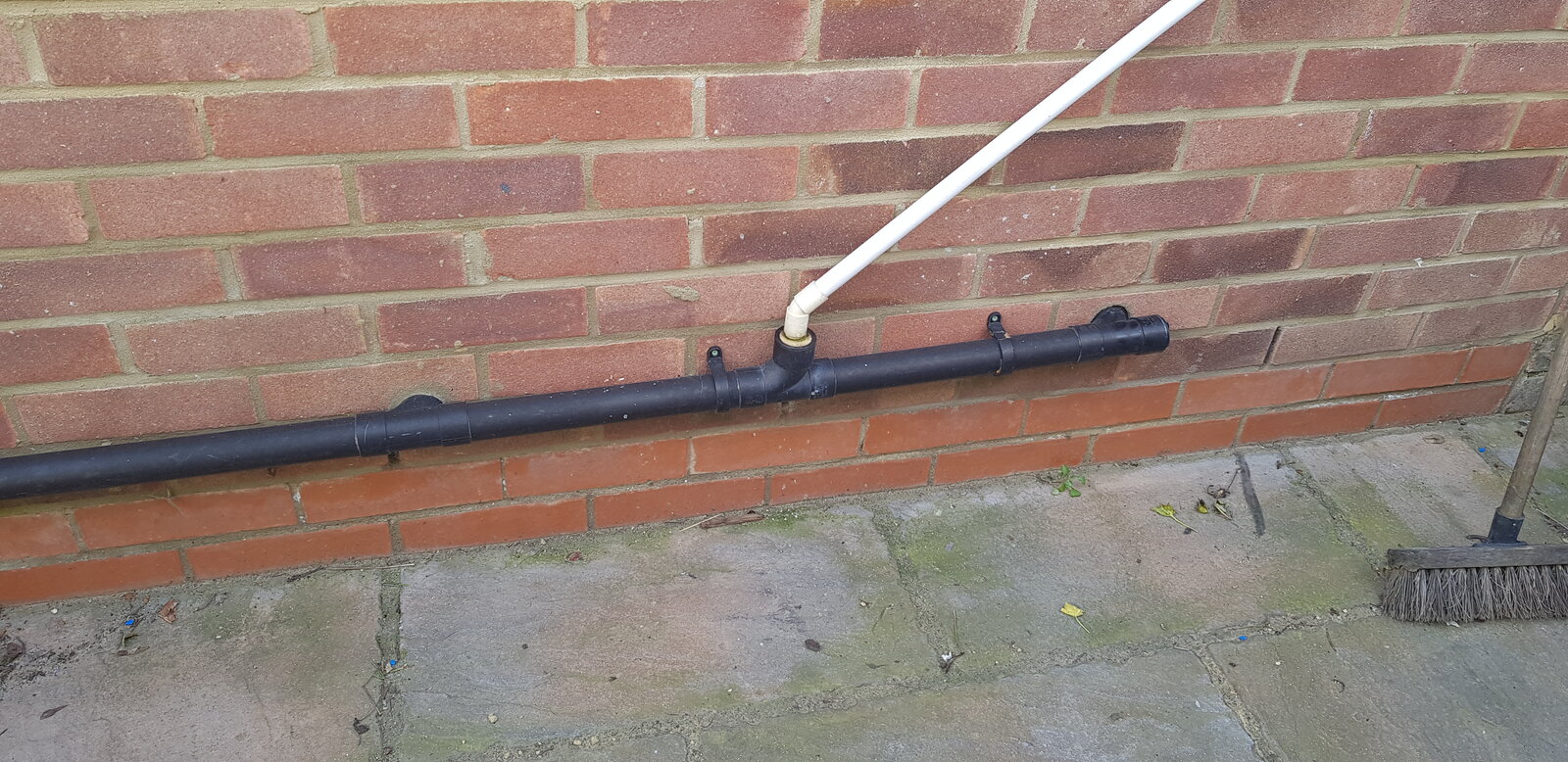

Ok, further investigation.
I blocked the pipe from outside, from the rodding eye and using a party baloon.
Filled the shower tray with water and kept window open.
Then I shut the window and after a while the smell is still there, coming from the shower trap area.
I found that now it seeps from the joint with the shower tray, but I don't understand how the smell is still coming through with the pipe blocked and full of water.
Please give me some ideas.
