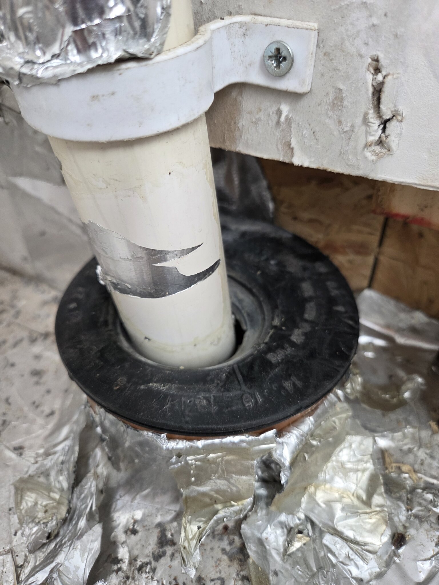

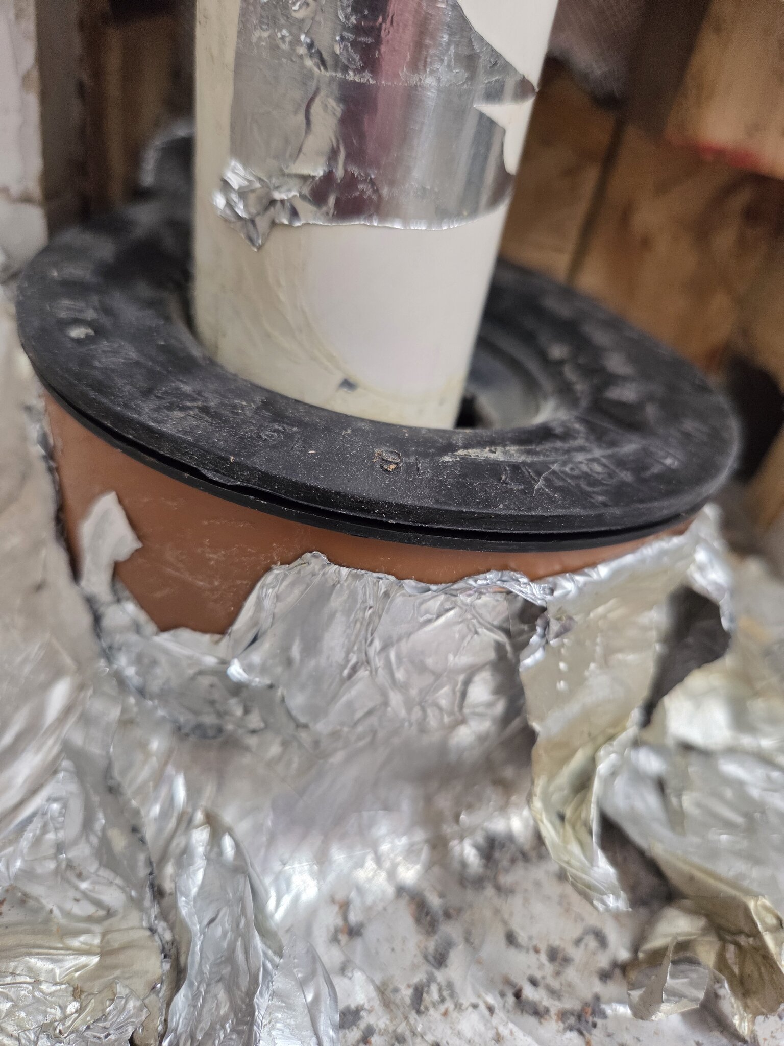

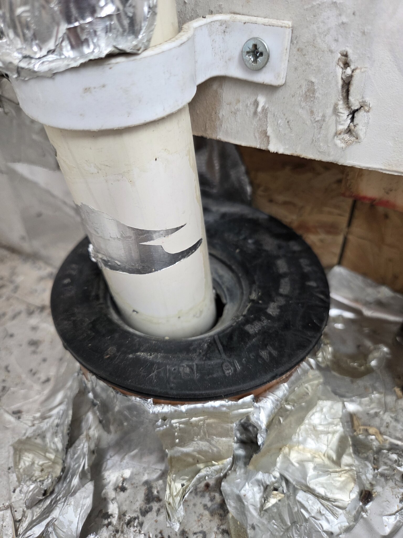

Smell from kitchen sink pipe

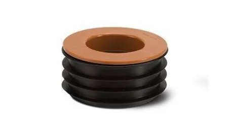

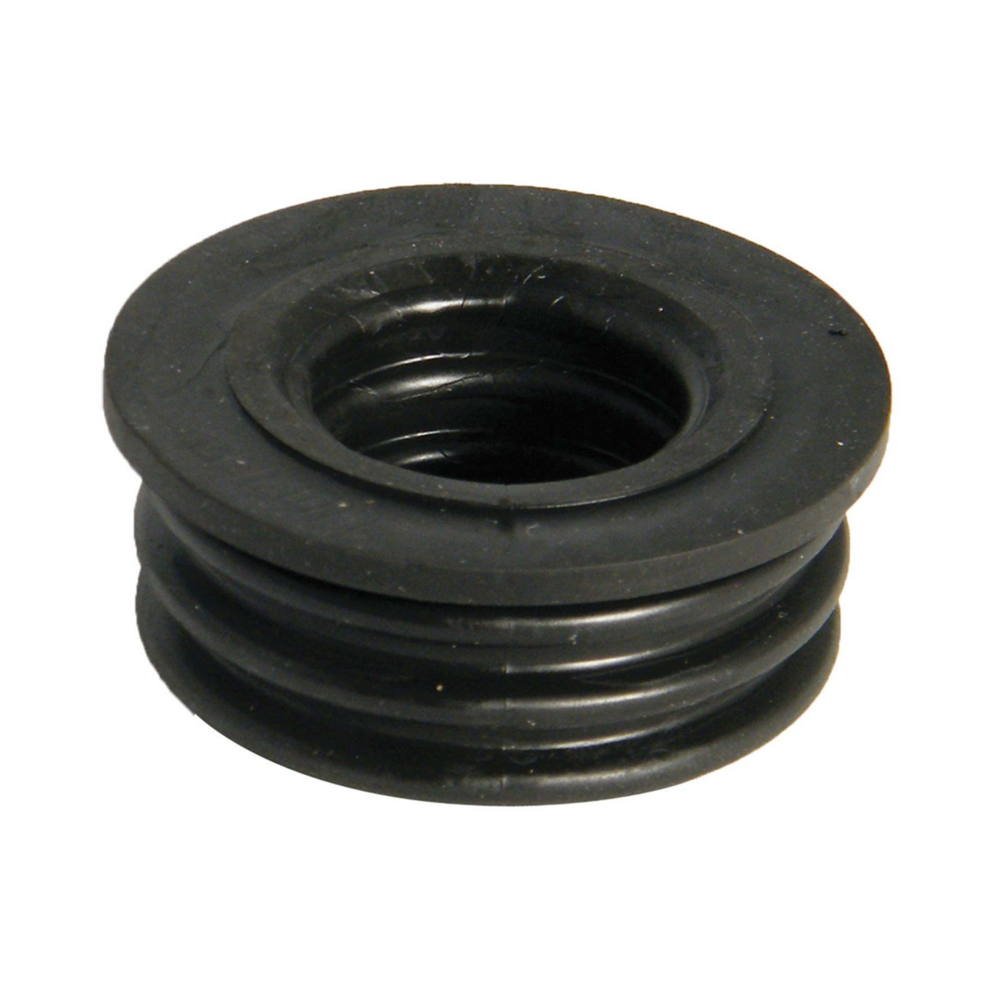

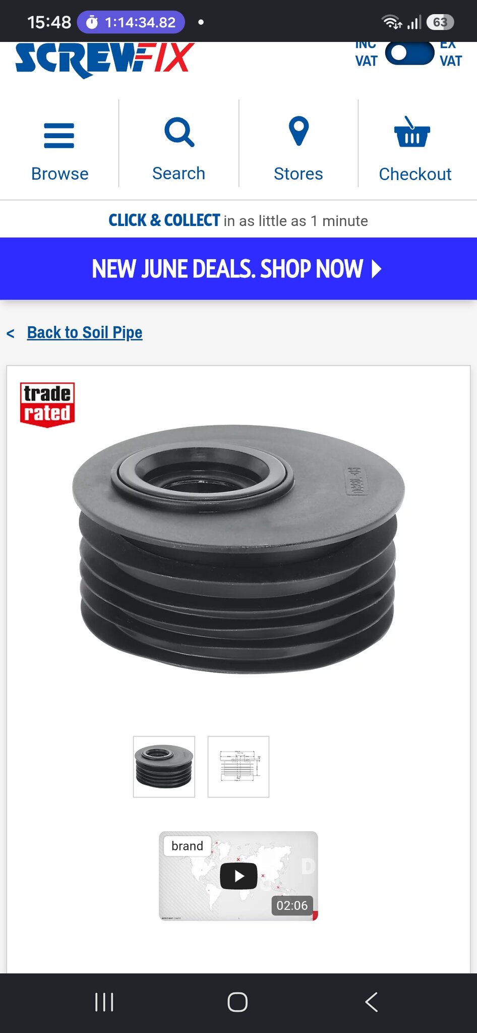

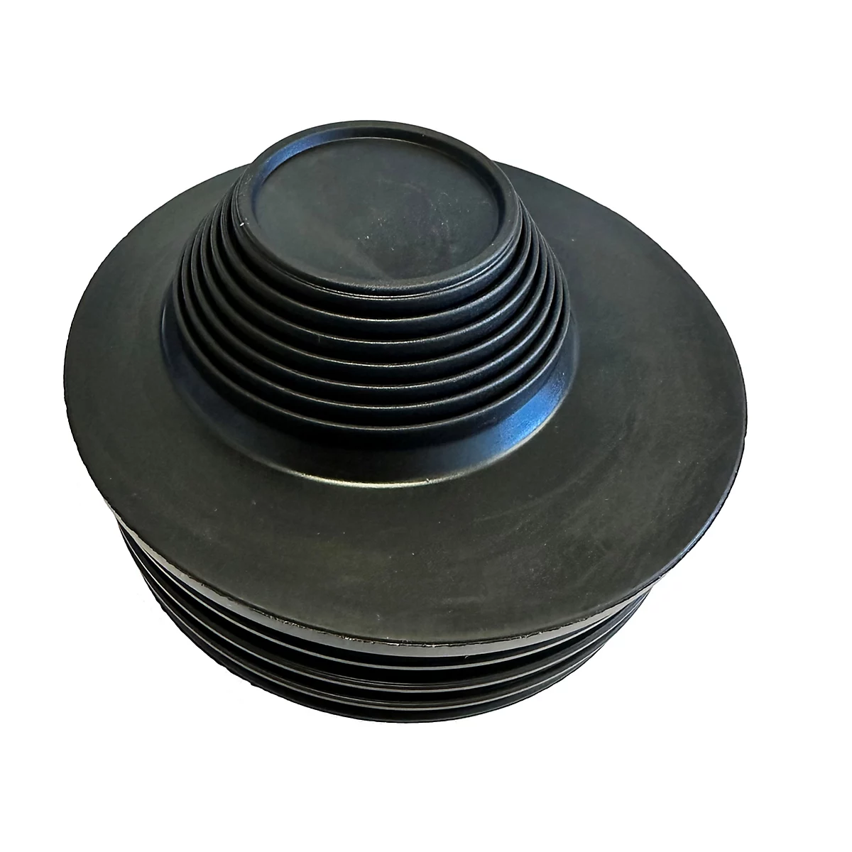

That fits into a collar, you might not have that if the pipe is plain ended.
If so you'll need this as well, https://www.screwfix.com/p/floplast-push-fit-double-socket-pipe-coupler-grey-110mm/14551
Or just one of these, https://www.screwfix.com/p/mcalpine-push-fit-1-inlet-offset-drain-connector-110mm/871JG
