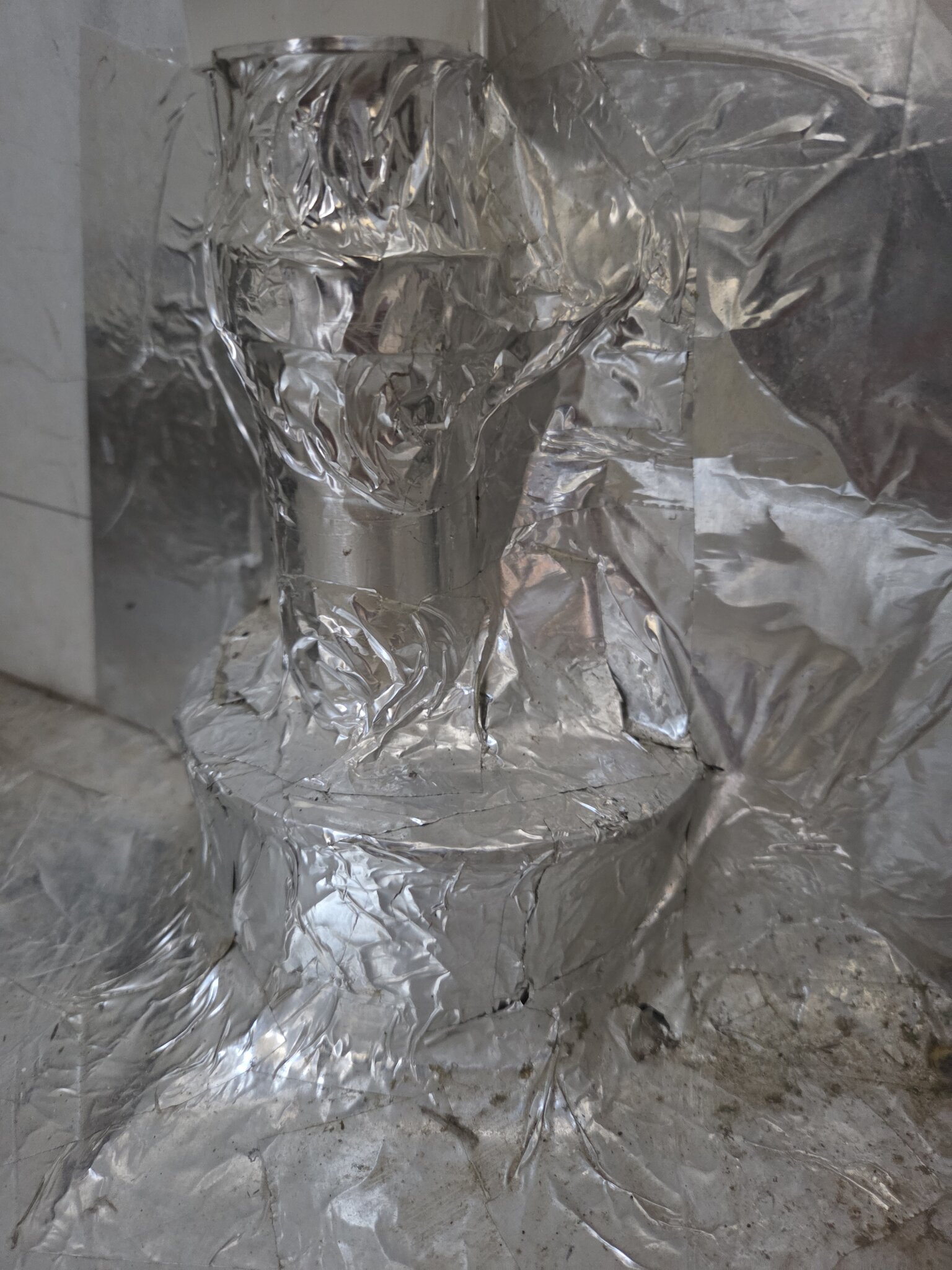

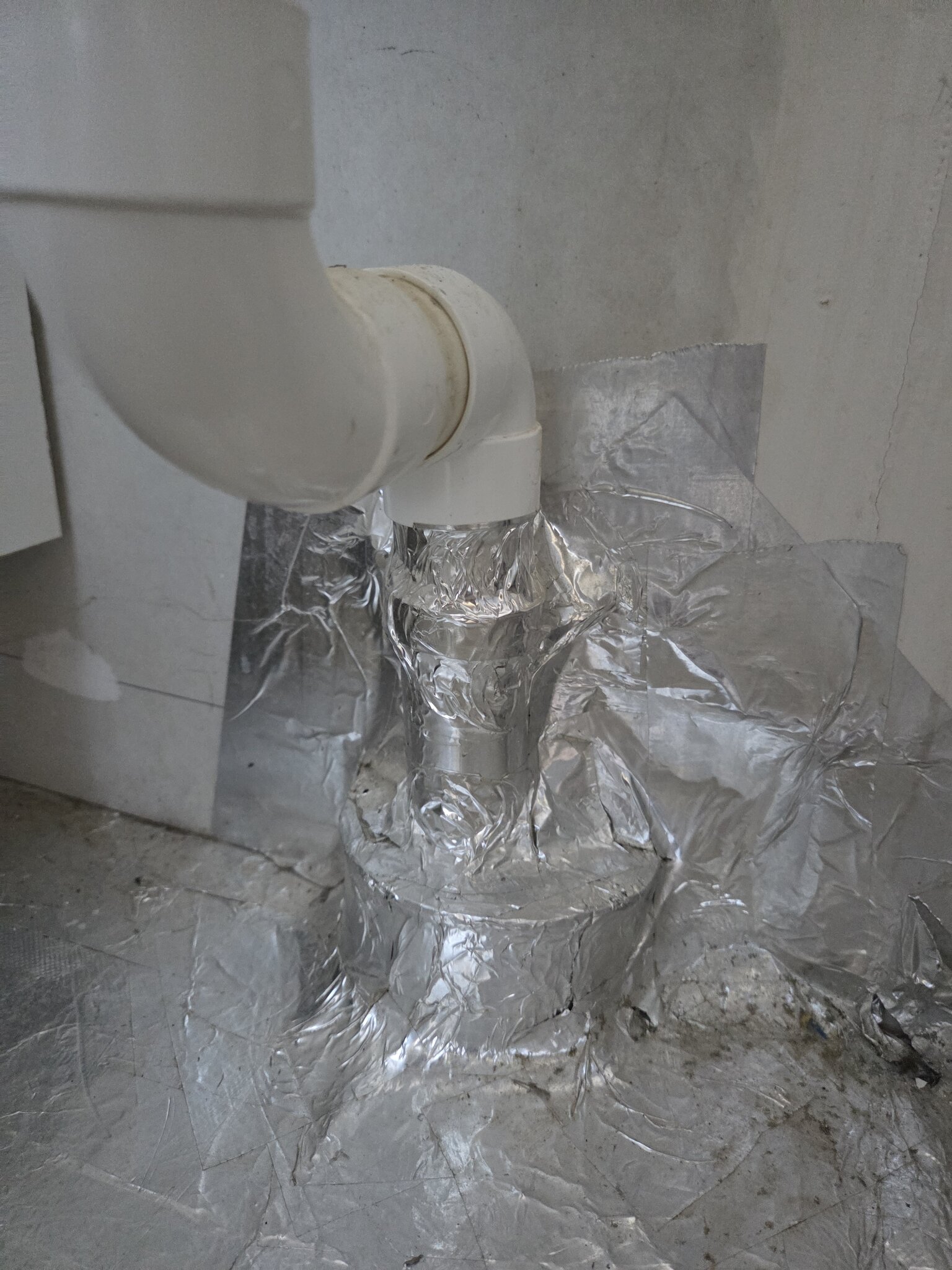

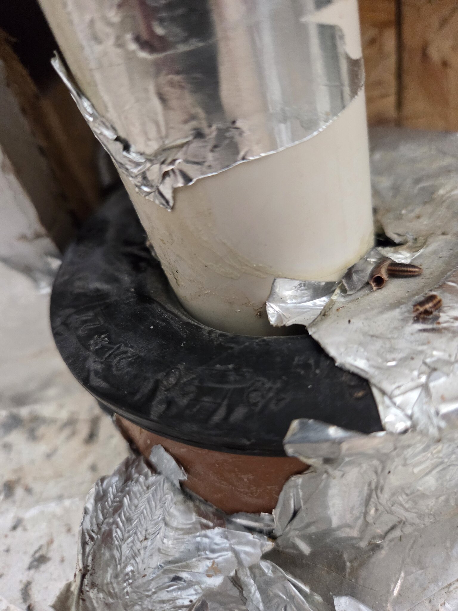

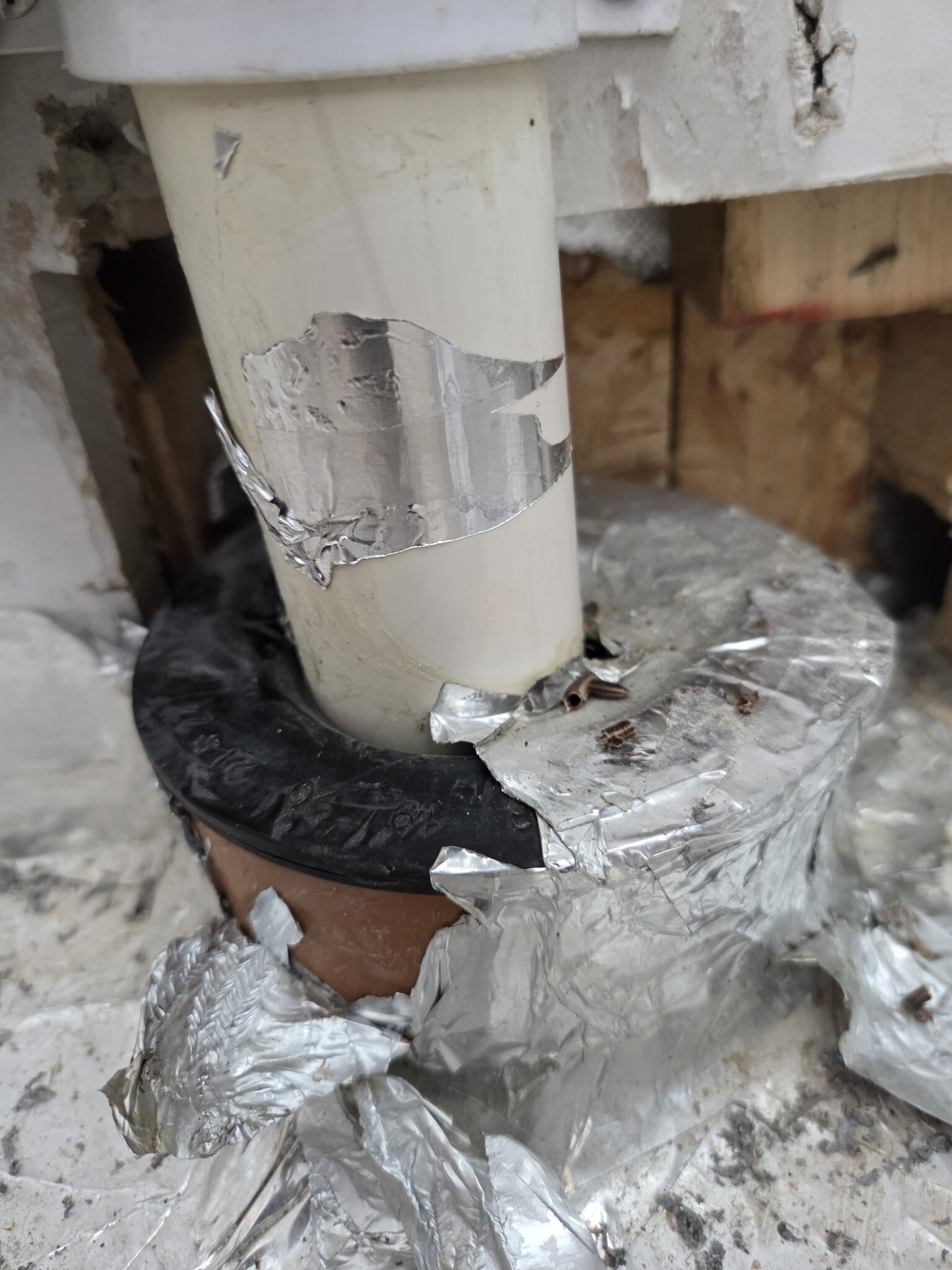

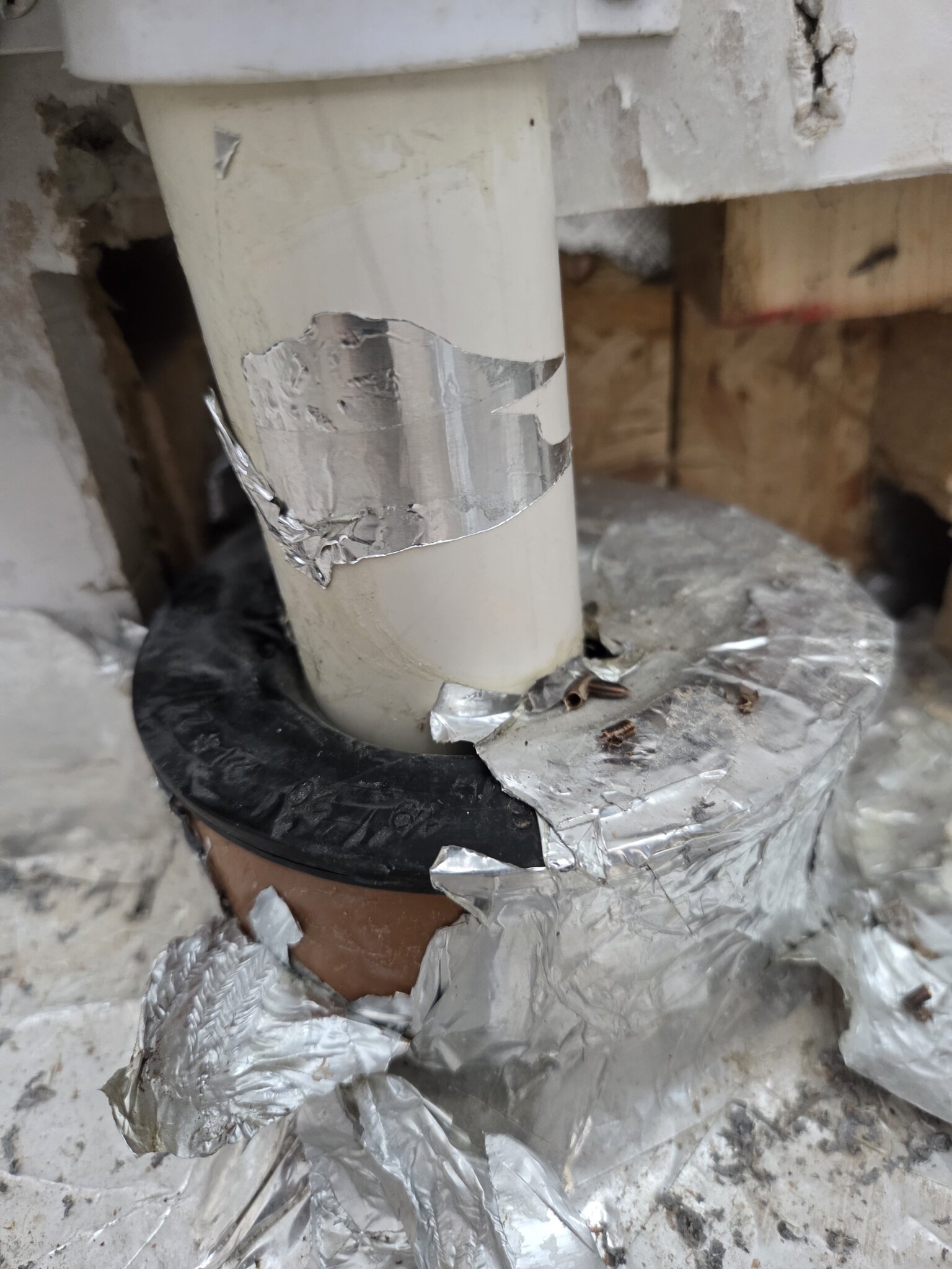

Morning,
I'm in the middle of a kitchen refit and noticed a bit of a smell coming from where the sink waste passes through the floor.
Am I best just to peel the foil back and fill any gaps with plumbers putty, then reseal?
All and any suggestions welcome.
Yes - get rid of the foil and let's see what's there - that's just a bodge by someone trying to fix an issue.
With the correct fittings ( ideally not putty) it should be able to be sorted out. The drains may need a clean/jet out too, if it's that bad.
