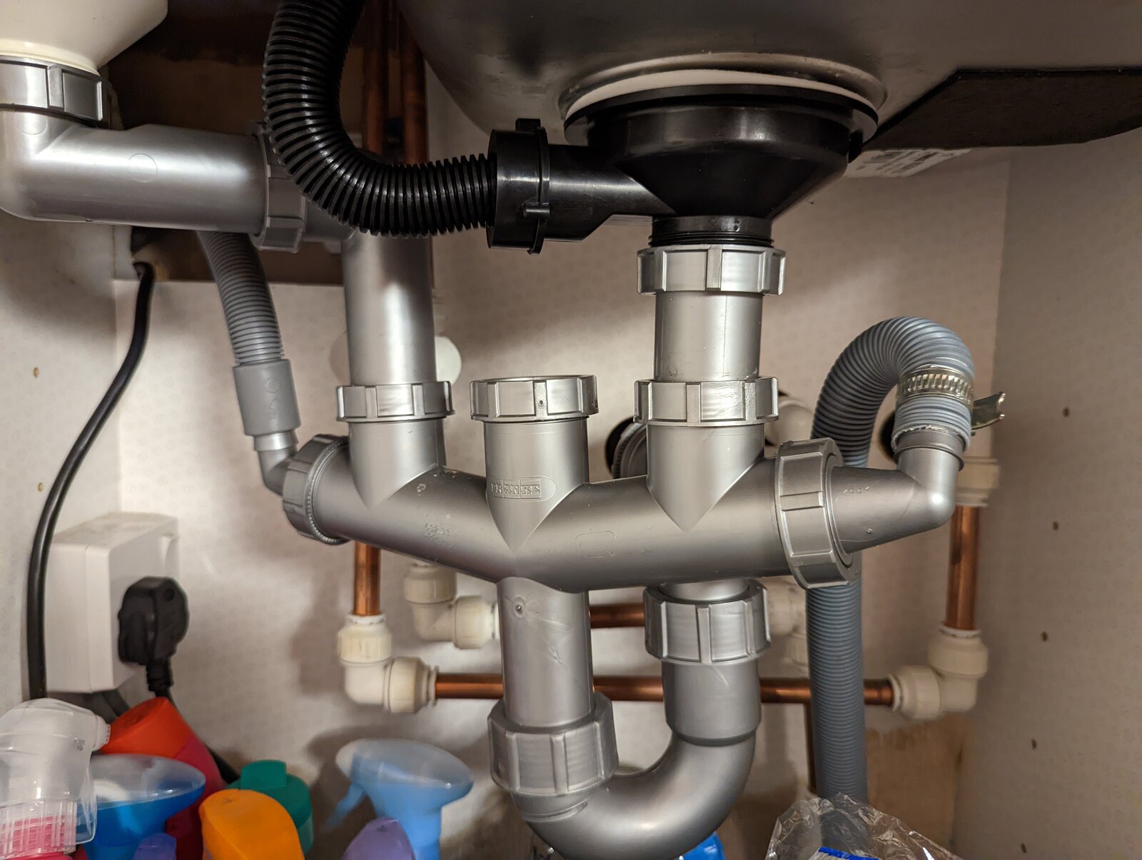

Picture of pipework, inside and out would be handy at this stage please, we can tell at a glance then if there are any glaring errors, otherwise its continued guesswork to rule things out.

Quick pic with the washing machine going off to the left and dishwasher to the right

HS2 is a railway. H2S is a gas. Some people from find both unpleasant! Make sure sleeve is located correctly, this forms the trap, and prevents foul air from coming up for the drains beyond the gully.
Undersink, the Dishwasher drain hose needs lifting up to almost touch the underside of the sink, then fall back down to the outlet, otherwise there is a risk of dirty water backflowing into it when another discharge is made.
Ok thanks will try and see what I can hook it up with as it keeps falling down. That would just be dirty water from the sink going down there? Do you think that could be it although I wouldn't say there is much dirty water that goes down there.
