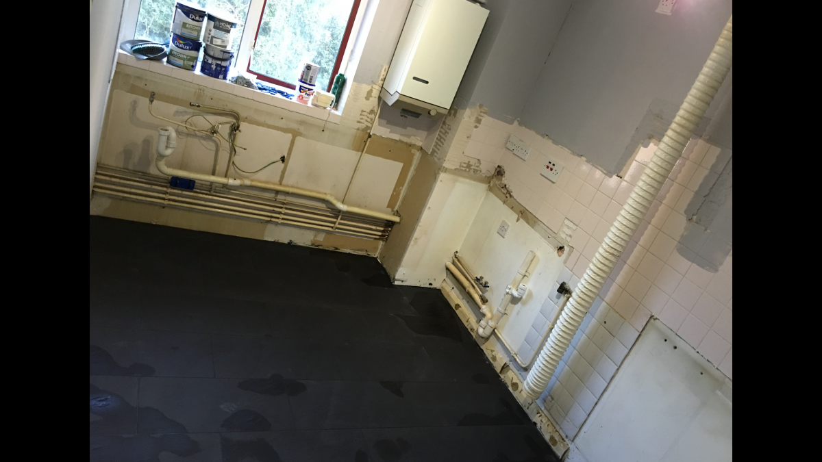

Here are a couple of pictures - one from under sink and one from when the kitchen was installed to help explain.
So under the sink the grey hose is from the dish washer - that same pipe then runs around the wall and round the corner to where the washing machine drain is plumbed in in. Hope that helps!
In the picture of the kitchen without units - the sink is under the window and washing machine is on the right hand wall.
What's connected to the back "arm" of the sink trap? Is it the boiler? If so that's unlikely to be the cause of the smell as it's before the trap.

the grey pipe under sink all looks fine,it is bringing waste from dishwshr, directly to trap.on the right wall is a combined stand pipe and trap ,and wash mach waste pipe basically drops into the top of the standpipe BEFORE the trap. a fairly standard method ,but if the waste pipe from machine is smelly it will be smelled in the flat .it looks as though an additional piece has been added towards top of standpipe and I presume it is for the condensate pipework from boiler. so you would have to gain access to the wash mach waste pipe ,where it meets the standpipe , to have a sniff. is it an old machine ?

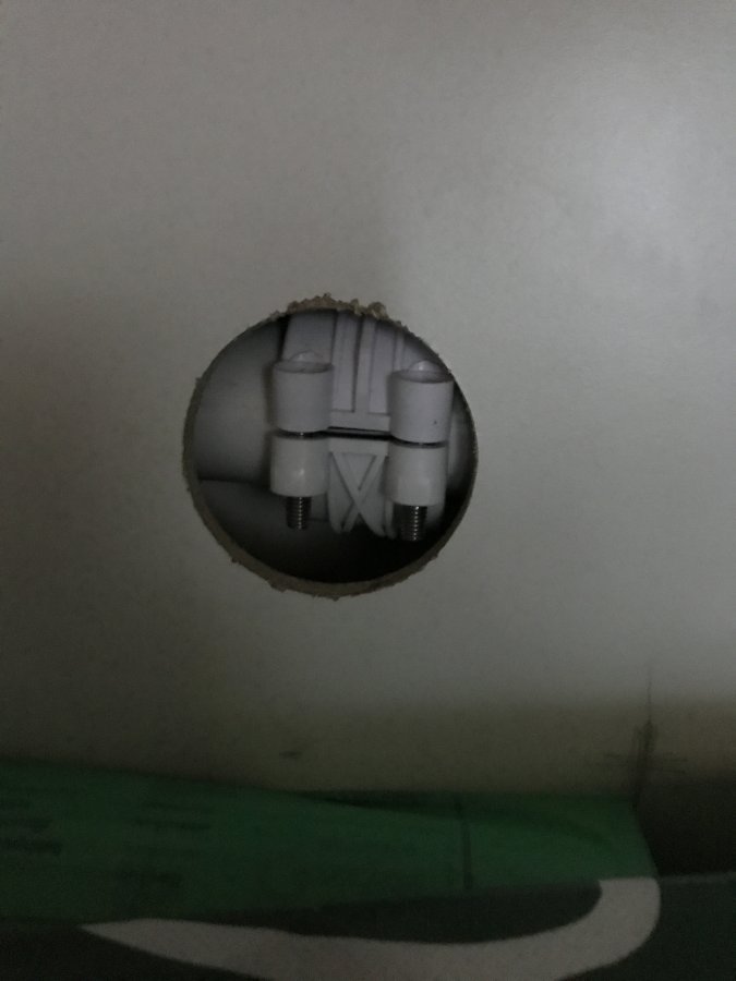

Your right that is the old boiler - the new one was fitted after the kitchen was installed - just a couple of months ago actually, the pipe for the boiler drain goes straight down and was connected to the waste pipe - have attached the only image I can get of that without removing the backs of units.

Op's 3rd photo is of a clamp on, self-tapping, T for the condense to the boiler.
So the water trap at the boiler needs to be providing the air seal from the drains.

Yes so you should really have another trap. Try turning the extractor on and closing the door then see if the smell gets worse. Or any draught from where the boiler pipe drops into the drain if accessible
