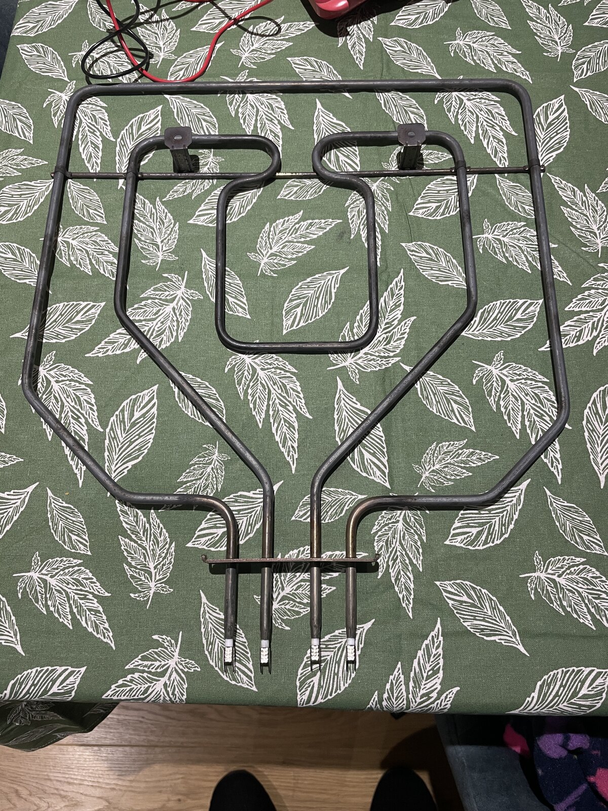

Can anyone help me with the following query, please?
I just turned on my Bosch hba63b150b oven onto grill setting and the element immediately started to smoke and smell
The display on the LCD was immediately a red square and from memory, whilst it is still warming up, It has like a thermostat icon in the middle which as I say was not present.
I immediately turned the oven off as the smell was bad and have unplugged it
I’ve taken the element out of the top of the oven as I was familiar how to do this having replaced it probably only 2 years ago.
The element has an inner and outer circuit as you can see by the photo I’ve attached
I’ve done a continuity test on both the inner and outer and the readings are as follows:
Outer = 39.5
Inner = 33.4
This is using a multimeter on 200 ohms setting
I’m no electrician but from a few Google searches I think the above readings suggest that the element is okay so with this in mind can anybody confirm or suggest just what the issue may be please?
It almost seemed to be that it came on at two higher heat immediately which is weird because we regularly use the grill setting on option 3 and we’ve never had an issue
We used the oven on Monday evening without any issues
Thanks in advance and hoping that I won’t be needing to buy a new oven any time soon

Did you check if there was any conduction between each terminal and the casing of the element.If there is non then it sounds like possibly a control board fault.you may be best off asking Bosch if they do a fixed price repair.

Test the resistance using your multimeter from each terminal to the body of the element not just between the terminals.You should measure an open circuit. IE zero ohms. Using a multi meter is not actually a guarantee it is not shorting to earth as you would need a proper resistance tester to be certain. But if the oven is protected by an RCD at the consumer unit that would normally trip with a short to earth so just thought I would ask as you don't mention the supply to the oven. As I said, from your discription of the problem it seems unlikely to be a faulty element.

NO! Not zero Ohms, it should read high/maximum/infinity...
Yes sorry should have said "no reading"

The problem with the LCD suggests it is something else to me.
So yes, I’ve just tested both elements for resistance with a probe on the connector and the other probe on the actual body of that element and you’re correct it shows an open circuit and they are both the same
When the incident happened, it didn’t trip my RCD
Do you think this could be a thermostat issue which from what I’m seeing is actually what they call an oven temperature PTC sensor ?
I’ve got the lid off, so I’m gonna do a test on that shortly also

A bit more info
I’ve just done a resistance test on the PTC sensor
At room temperature the reading was 533 on a setting of 2000 ohms but then if I held the sensor and breathed on it, it actually went up to 546
However, I’m close inspection if you look on my photo it actually looks like the white almost chalky type wick is actually split in two places
Considering that my cooker when you use the grill, which is what we was doing, which uses the top element you have three options temperature 1, 2 or 3, but that is simply done by turning a knob so would the temperature sensor be involved or does it regulate the heat some other way?
