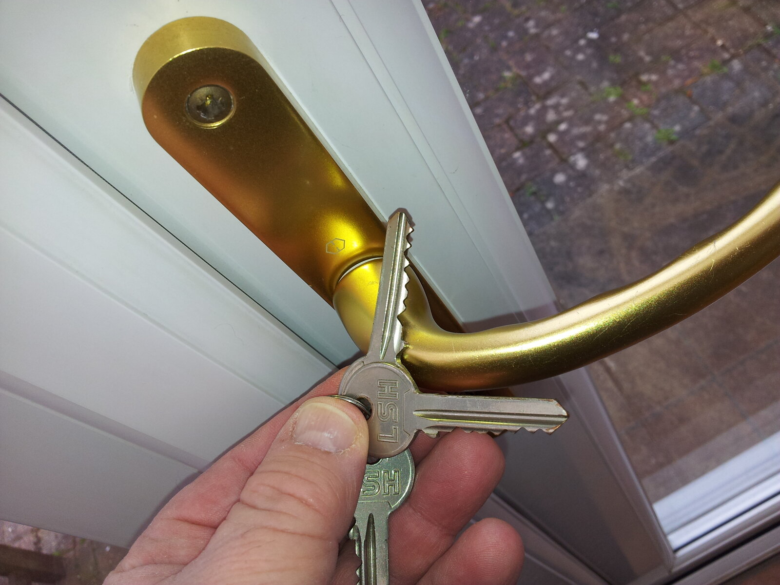

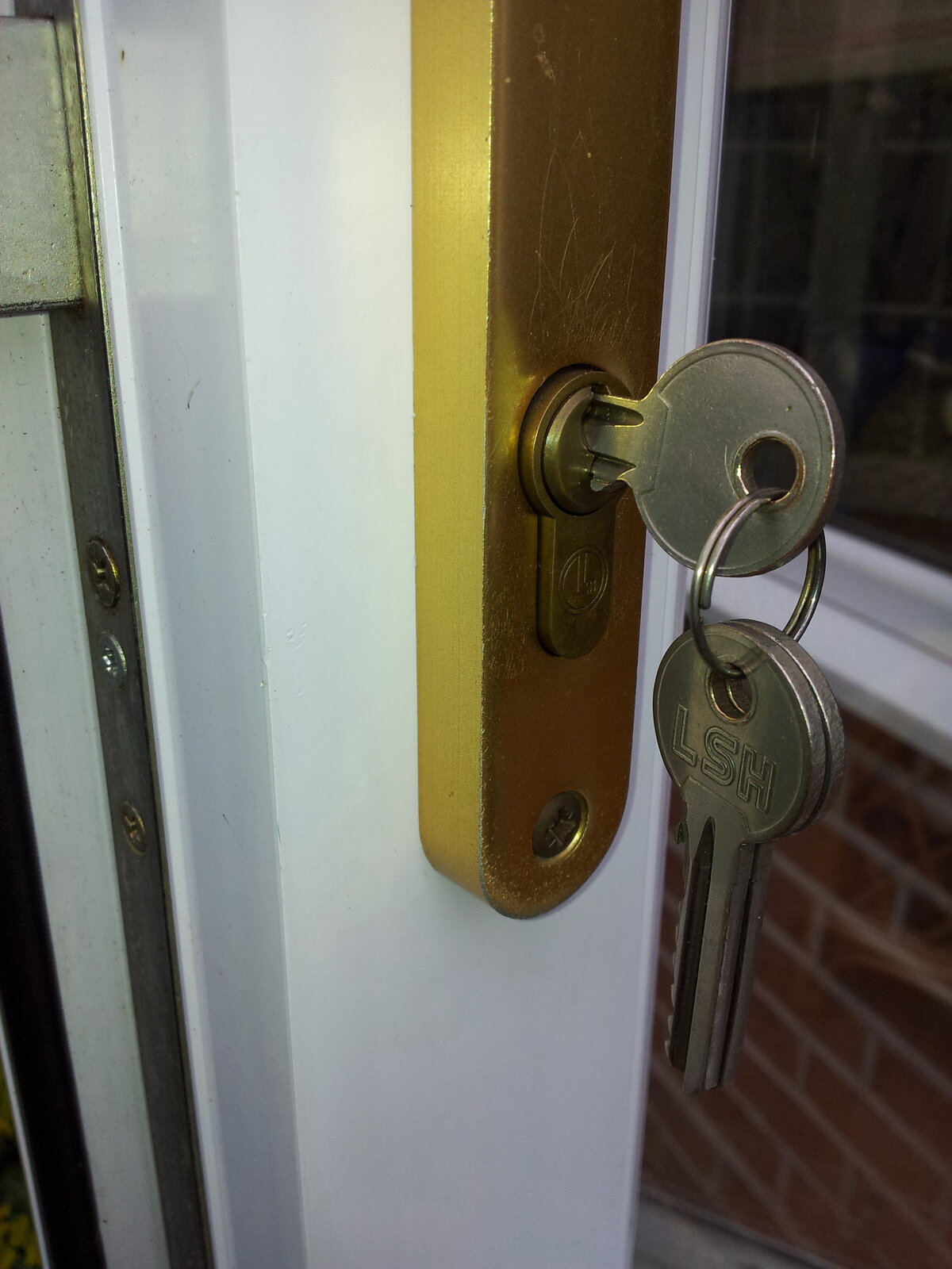

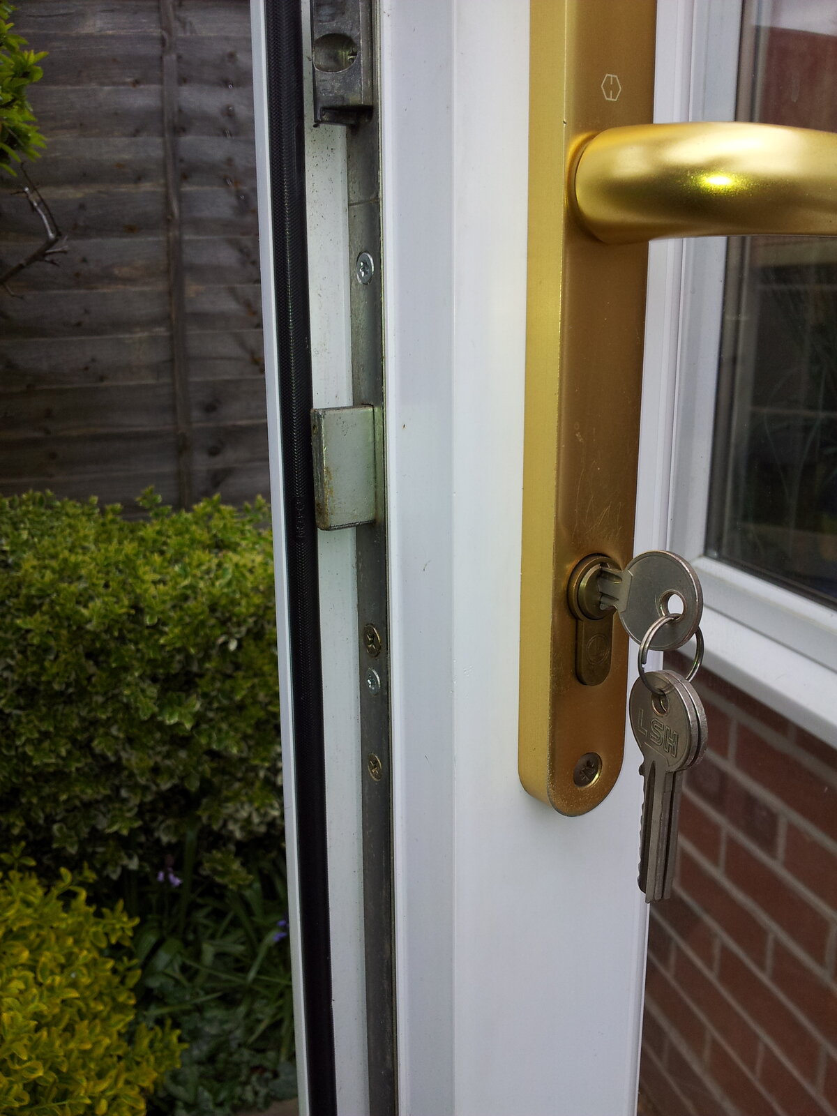

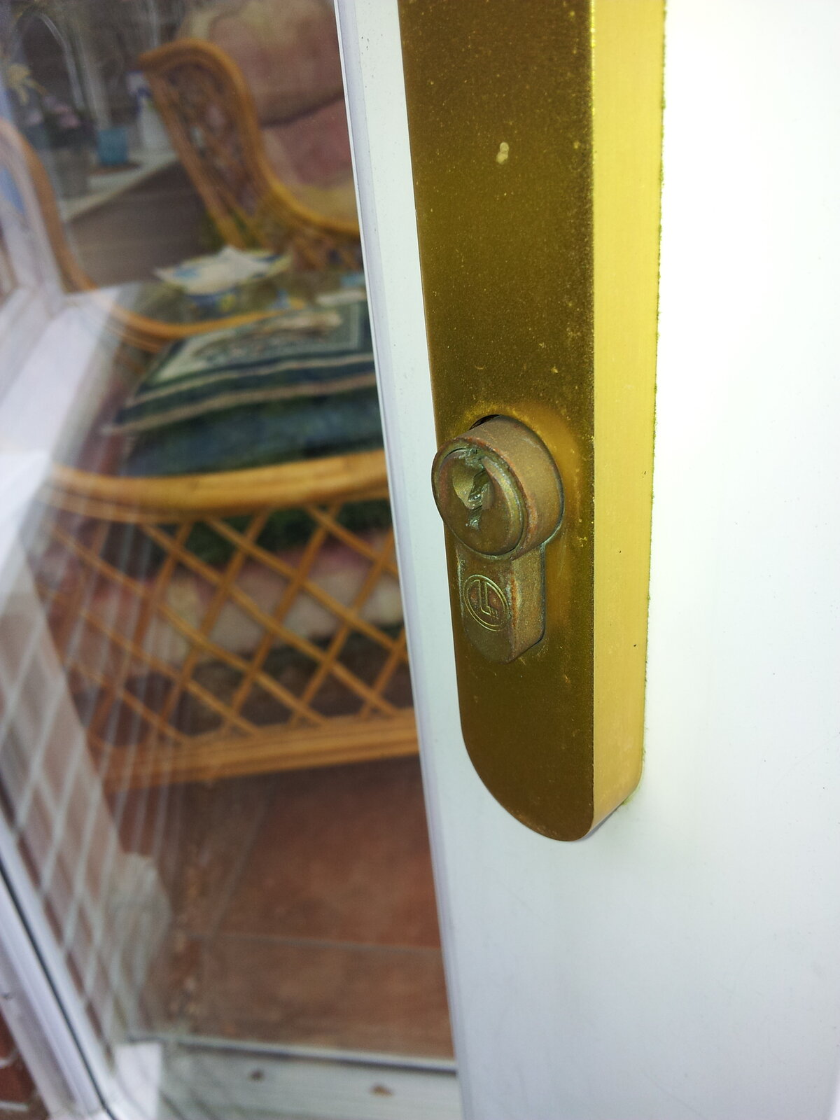

This is a lock on my mother's conservatory thing. I assume it's one of those euros which can be snapped and opened easily.
Replacement is a question of getting the length right, yes?
The 3rd pic is from outside.
Any particular recommendations for a replacement type/ source?

To the OP, you have the keys so its easy to just pop the cylinder out and measure, they are sized in 5mm increments but be careful if your thinking of knocking off 5mm on the outside measurement as in some cases it may leave the cylinder face just below the handle surface hence the next size up was being used by the manufacturer. When ordering make sure the anti snap part of the lock is on the outside or on the outside measurement
Google search anti snap, anti bump, anti drill and anti pick, and look for 3 star TS2007, theres Avocet ABS, Ultion, Yale but so long as its 3 star TS2007 you'll be good

OK so this is one which would snap.
