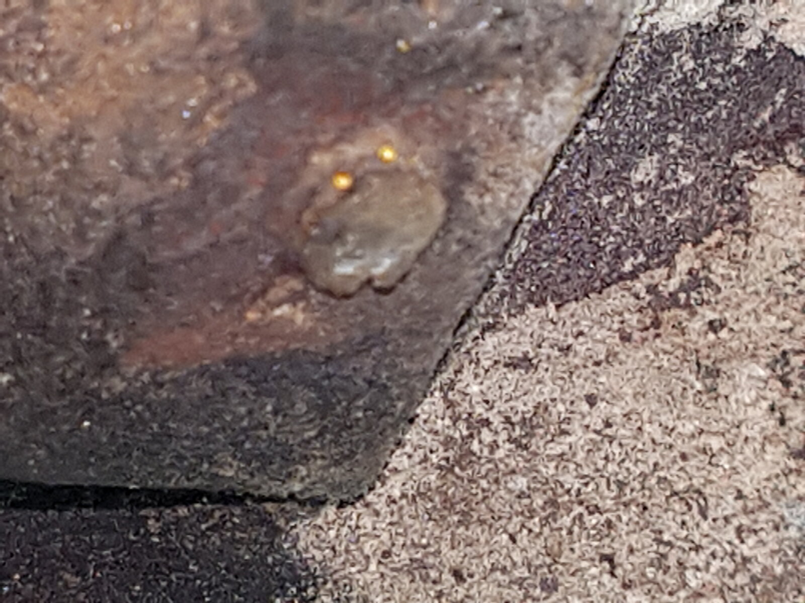

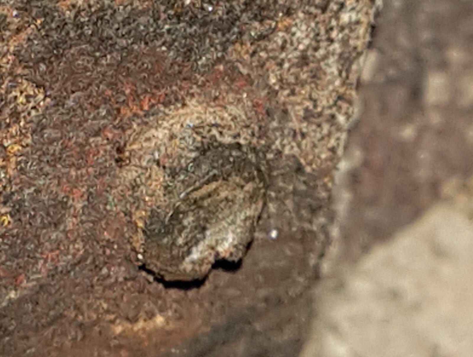

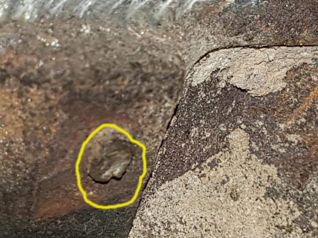

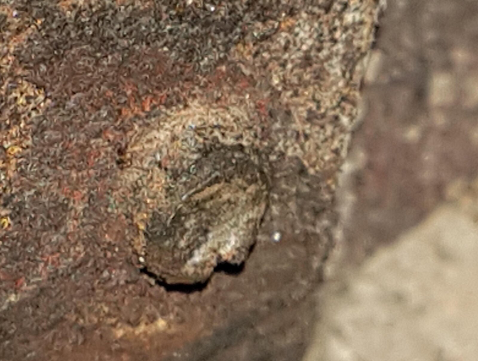

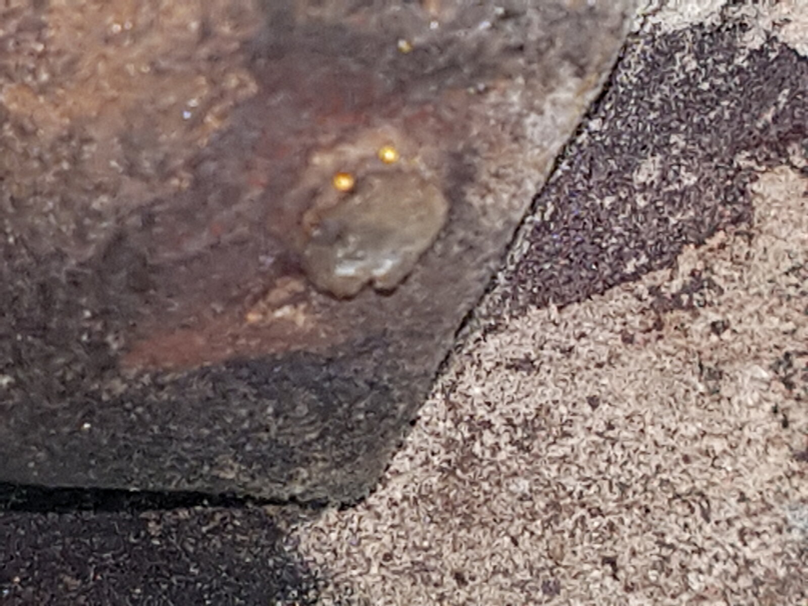

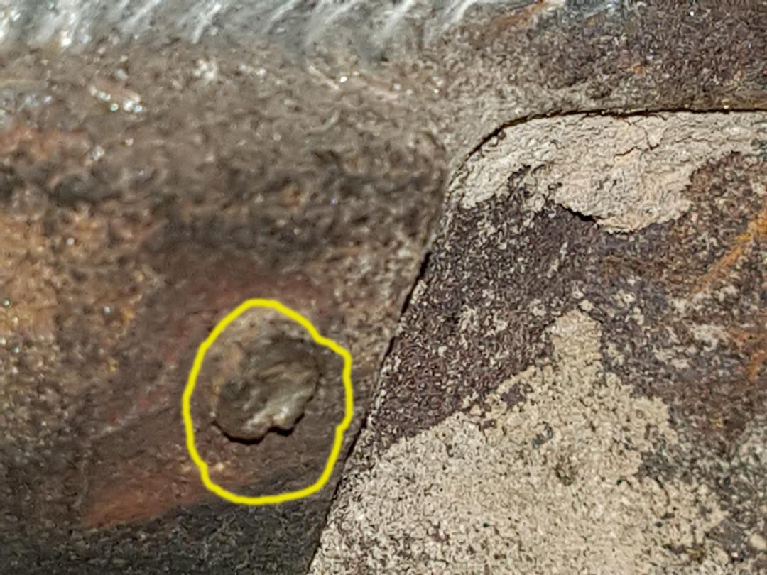

Snapped Bolt Thread in Cast Iron Housing

There is enough of the stud left sticking out, to partially screw a nut on then to weld it and try to unscrew it. Just poke the welding rod into the end of the stud/ through the nut. I see some welding has already been done to the casting.
If you do decide to drill it, be sure to use a left-handed drill. And if at all possible, use a drill stand and clamp the part. A snapped drill will make it even harder.
This is one of the few occasions when a copper grease would be useful on assembly.
May be easier with better penetration to weld a washer on first then a bigger nut to the washer.
Unless you are spotting something I cant , the pattern above the the stud looks like the residue from stove rope?
Op, a picture of the whole stove would be good
If you manage to weld anything to the end, (a nut, a short length of bar etc), you may find the heat generated to make the weld will actually free up the original bolt.
Knock the head off and drill it out, use. Plenty of lubricant and a carbide drill.
Then use a slightly larger drill bit to drill out the thread, tap it and insert a helicoil. Insta new bolt with high temp grease on the threads
Correct, that is what I said above. I'm not convinced a washer would be a good idea - a nut limits the weld to the hole in the nut and the stub of thread.
Its all very well having ideas for welders, helicoils, taps and left hand drills, but these are not the sort of things the average DIYer has to hand, and TBH if I wanted to find those things I'm not sure I would know where to turn to locally to me, apart from left hand bits which you can buy fairly easily.
I am fairly sure if I tried to weld that with my little MIG, the cast iron would just heatsink the heat away and I'd be left with a bit of birdpoo sitting on the surface.
