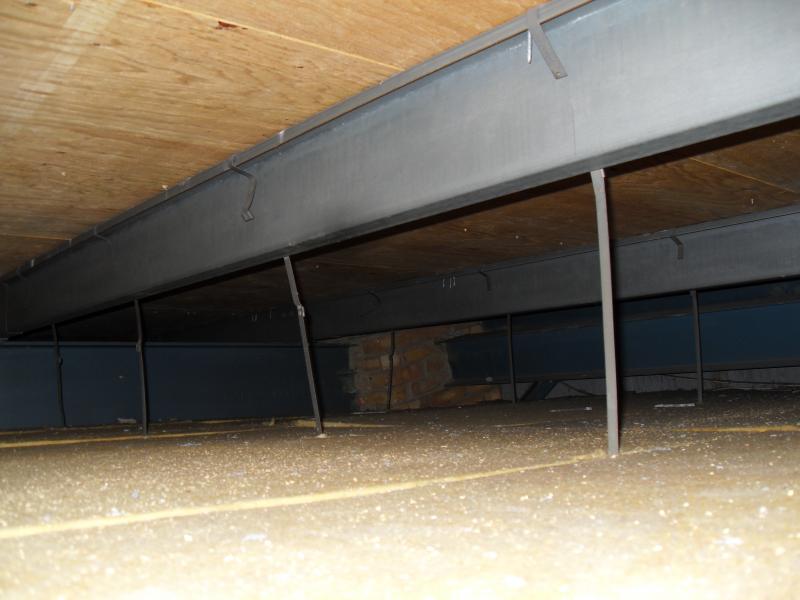

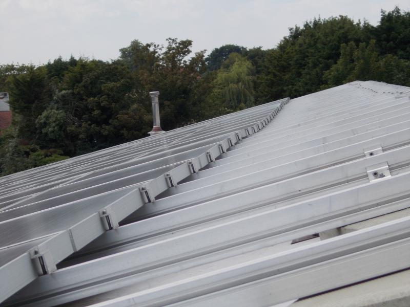

Thanks Tony, I'm trying to get as much information as possible for our club and I have noticed since the solar panels fitted, the roof is bowing and the high point I'm guessing are the steel trusses. I'm not sure if it's the heavy slabs from the solar panels are causing this
The structural engineer who did the calculations is visiting me on Tuesday
Would appear that roof was never designed for solar panels hence the deflection.
If you want the weight of snow, google (weight of snow) and you will have all the information you require.
Regards oldun,
I only spotted it when investigating a leaking roof!
What happened previously about 18 yrs ago, the roofing company replaced the white cement corrugated roof sheets with plywood, looks like OBS or shuttering plywood and on top of that is EPDM Sika roofing membrane and even the plywood underneath is not fitted onto flange or angle iron! There is not even any support or noggins on the plywood edge, When I walk on it, it's like a trampoline :shock:
Then came the solar panels in 2011, they have put down 648 heavy slabs weighing 54 lbs each onto the EPDM and I have no idea how much the solar panels weigh on top.
According to the Silka EPDM BBA specification, you can only use light foot traffic and concentrated load on top of their membrane :shock:
Does the structural engineer take into the account of the internal roof void structure? Or is it they are only interest that their calculations can take the weight of the slabs and solar panels?

The meeting and investigation with the structural engineer, solar panels installers and their rep was all blah blah blah. As far as the structural engineer is concerned it's safe, he doesn't considered the extra weight of the slabs and panels on the roof is heavy! The total weight for 648 slabs is 16,200kg and the panels 4,400kg therefore total weight added to the roof is 20,600kg or 45,415 lbs. :!: They put a string line at the top approximately 1m down from the ridge and quoted it's only bowing 5-10mm. Surely they should've done the string line test indown the middle of the roof because nearer to the ridge will be too rigid for any bend?
If you look at the photo's you can see the plywood bending and dropping with no supports and hardly and any screw fixings to the purlins. Surely there should be another extra beam or purlin in between the existing purlins plus noggins on the edge of the plywood?
The metal roofing system we have used to have cement corrugated roof sheeting and from what I understand is, these type of purlins are made of lighter steel than girders since they're not used to hold up heavy loads. Am'I right on this? Also these flanges or purlins previously has roofing hook bolts onto them, converted from corrugated roof sheets to flat plywood roof and now they have screws into them from the top, would that weaken the purlins

The problem really stems from the roof alterations. Carp detailing carried out poorly. The length of those boards without noggins at joints was bound to eventually cause an issue. The extra load sounds a lot (200kN) but it isn't that much really. It wasn't wise for the solar people to add that extra load given the state of the roof. Had it been the original roof it would probably have been fine.
I have checked with the Law Society website regarding building regulations and the Building Regulations approval is required if the solar panels will add more than a third to the weight of the existing roof covering. So are they saying if the solar panels are more than 33% of the total weight of the plywood and EPDM membrane?

Don't know where they got that 33% figure from but Approved Document A (Structure) regards anything over a 15% increase in the weight of the roof covering as needing to be checked.
When the engineers declared the 5-10mm deflection (of the trusses or the purlins?- we don't know) that would not have allowed for snow load, so ultimate defection will be greater.
In all probability, the roof won't collapse (hopefully) but it's not a good state of affairs.
