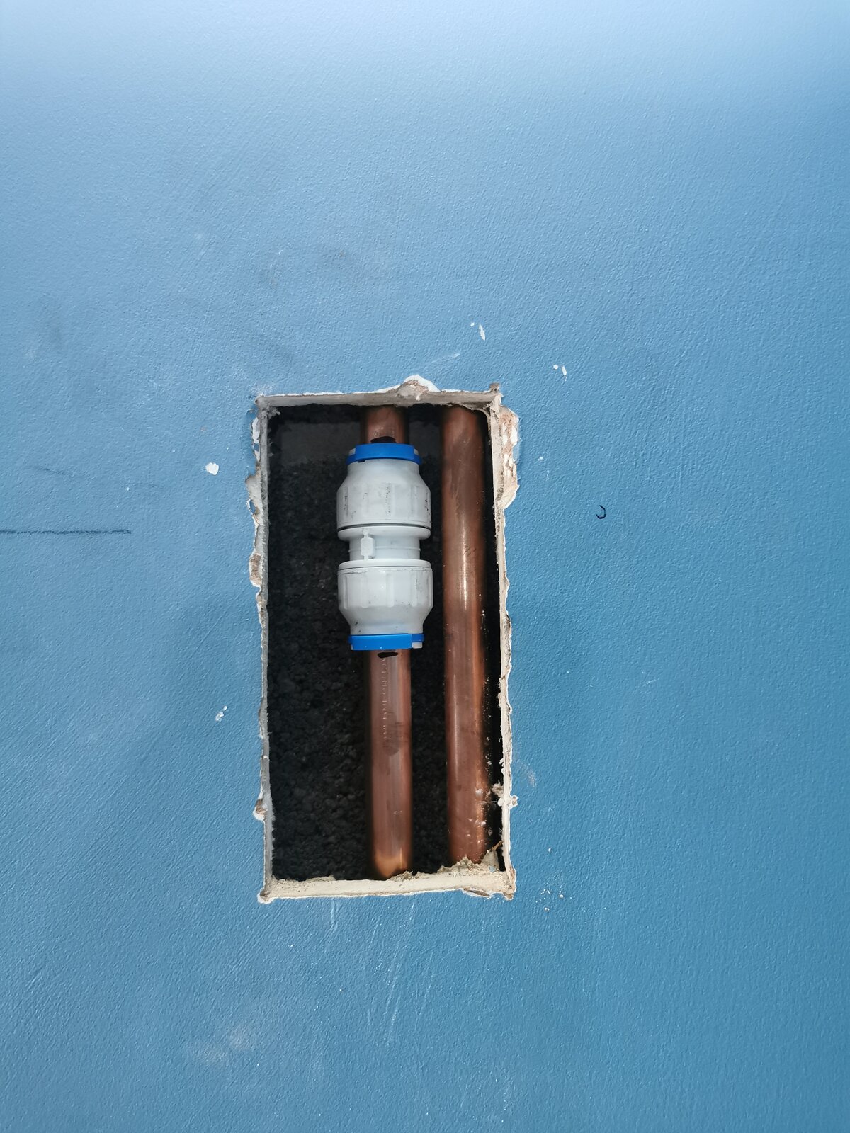

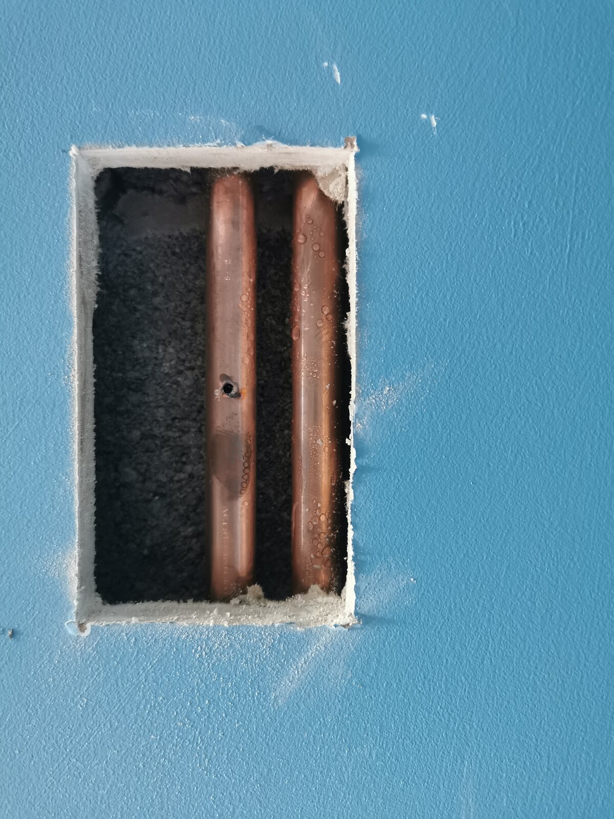

Afternoon all,
So putting up a bathroom mirror I forgot about the pipework to the basin and duly put a screw straight into it.
Easiest repair will be a push fit coupler in there but I can't get my pipe cutter in, is it possible to cut the pipe gently with a hacksaw blade being careful not to deform it then tidy up the cut with some emery cloth?
My other thought is if I cut the pipe I may get enough play to then get the cutter in and make a second tidier cut?
Chris

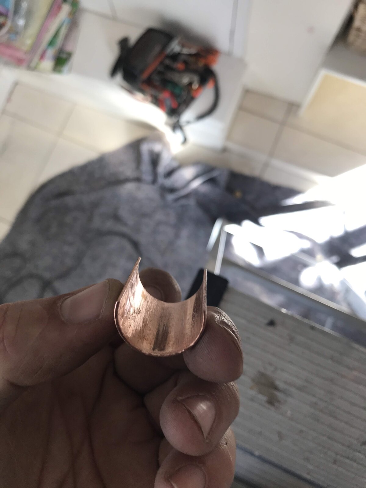

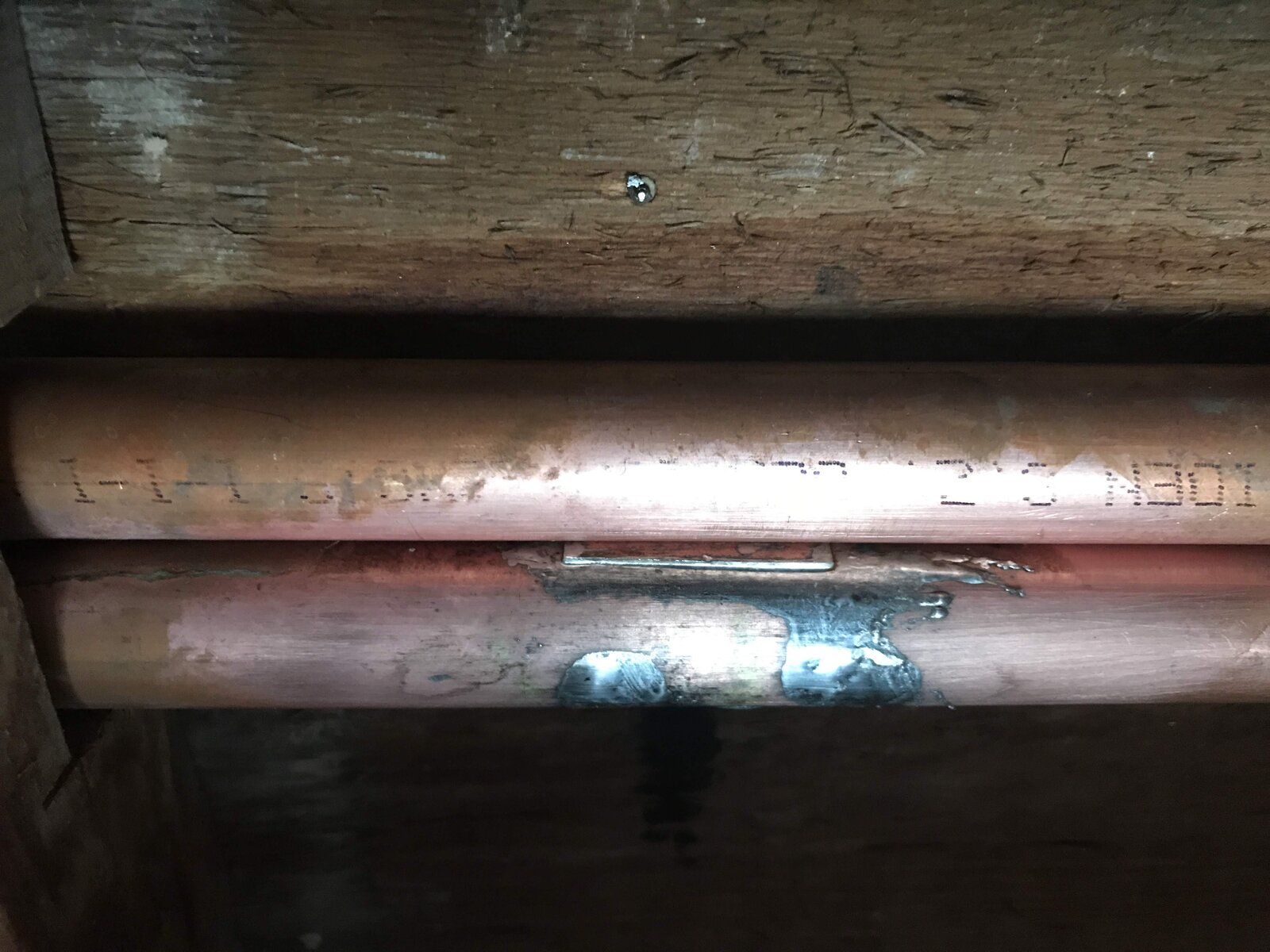

Provided A, it is not gas, B you did not go through the back too. This should get you out of trouble, check for nothing combustible in the hole before soldering! :giggle:
Flowflex Clickfix Copper Pipe Repair Patch 15mm (5962V)​
Screw fix sell them £5.49 part no
5962V​
