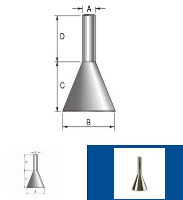

Over quite a few years I must have used routers from Stanley, Bosch (blue), Hitachi, Ryobi, Makita, Metabo, Elu, deWalt, Porter-Cable, Festool, etc and yet none of them have ever allowed me to just pop in a guide bush and for that guide bush to be absolutely concentric with the router collet. They always need to be centred, which is why many manufacturers and some tooling firms sell guide bush centring mandrels (sometimes called centring cones) such as this one.
