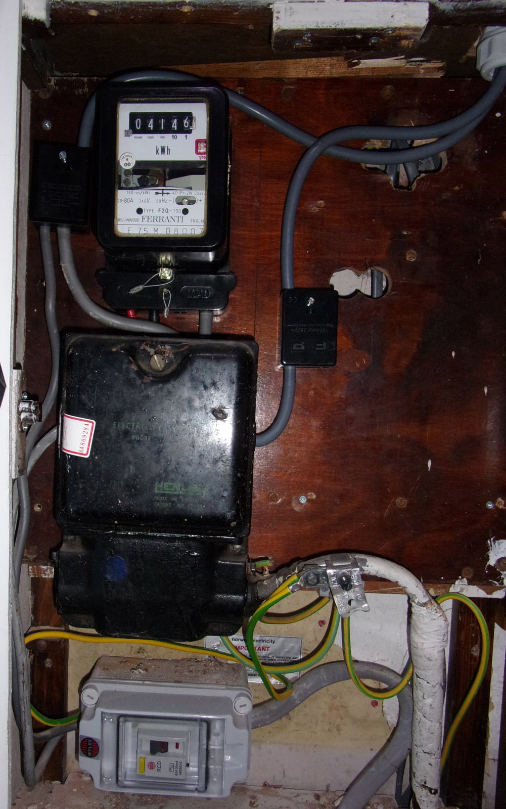

When I went to look at the house we now live in, this is what I found in the "meter cupboard". Naturally I was drawn to the lack of seal on the cutout, the multiple connections into the cutout, Henley floating around, and the general "untidiness" of it all. Oh yes, and that submain protected only by that "63A" RCD :whistle: Having heard to warnings about some of the old metal cutouts, I decided to not touch it.
In case it's not clear enough, here's a cropped down view of the tails etc.

Once we'd got suppliers sorted out, I booked for an isolator to be installed. When the contractor arrived I was able to see what had been done.
Before I spoil the fun (there will be mirth at some of the photos to come), anyone care to speculate on how things were connected ?
Looking at the rest of it, I would wager terribly. Some reversed polarity? If there’s more than one set of meter tails coming from the head, which there appears to be...then surely some stuff was unmetered? Or is that just the photo?

I was wondering whether all of those cables are coming out of the cutout, or whether, rather, some of them may be passing behind it?

Yea they may be passing behind it but can’t be fixed to the board very well then!
Love the bend on the PILC too!
How many things are right ? Not much! That earth clamp isn't right and the incomer isn't terminated right and that's before we get as far as the cutout

The RCD "protects" a submain to another CU in the new(ish) extension.
Yes the cutout is properly fixed in place, no there aren't cables going behind it.
The contractor fitting the isolator didn't comment on the earth clamp.
There didn't turn out to be any unmetered loads - I had wondered about that.
No reversed polarity.
And yes, inside looked no better than the outside - the contractor struggled to get some of the cables out.

Yes the cutout is properly fixed in place, no there aren't cables going behind it. ... There didn't turn out to be any unmetered loads - I had wondered about that.
So where do those 'additional' cables' from the cutout go?
