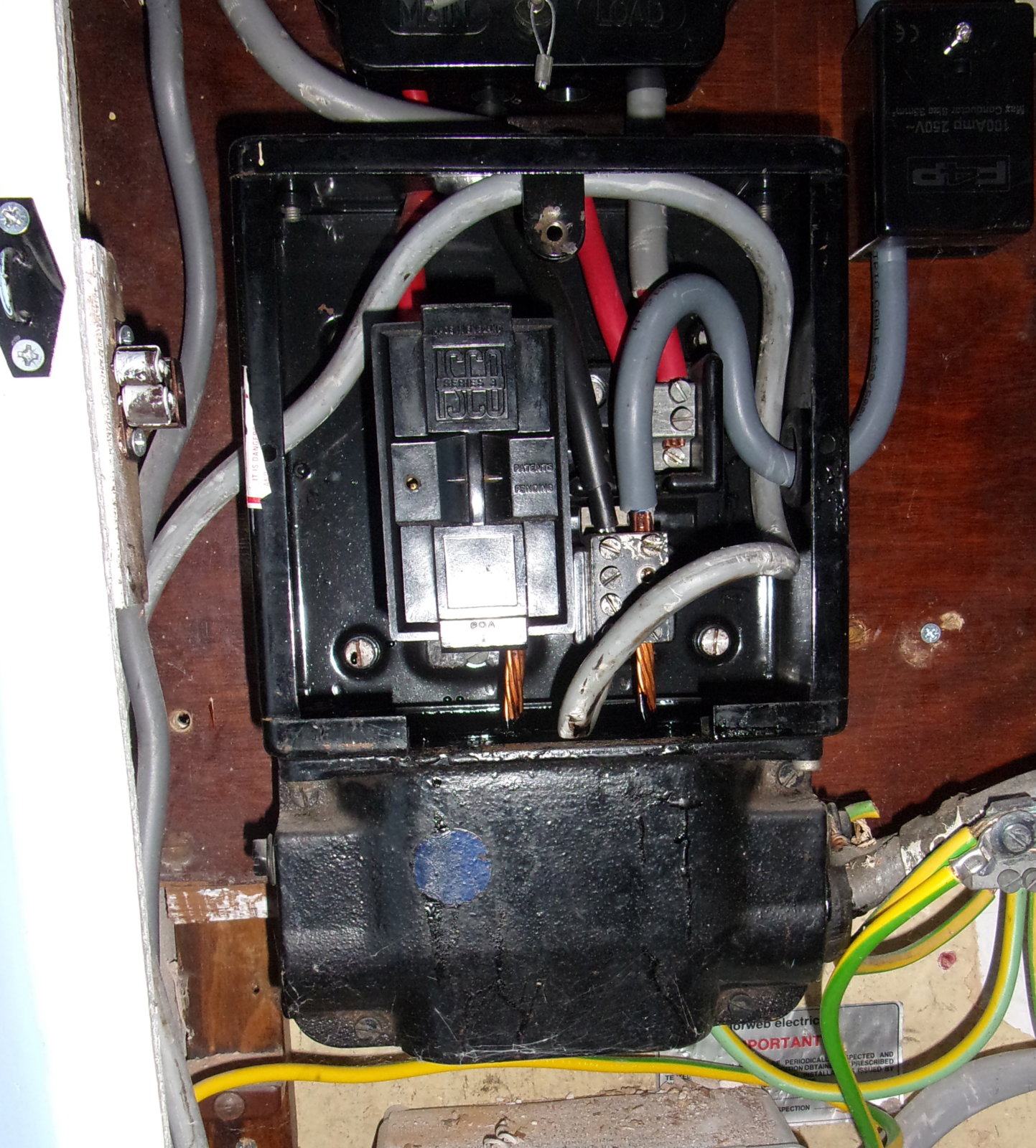

So what do I expect to find in this cutout & having an isolator fitted
I was waiting to see if any speculation happened over what connections might be in there - some people will be out earning a living :whistle: All I'll say is that it surprised me, a little.
Fair enough. I wait with bated breath :)
On the face of it, if those 'additional cables' actually are connected to something within the cutout, and if they 'go somewhere' (they clearly don't go to the meter), it's difficult to see how they cannot be carrying un-metered electricity (which you have said they aren't)

OK, so this is what was in the box :
So now we see that there's an extra terminal in there that the metered live has been taken to, and then from there to the Henley on the left where it's split for the two boards. The Neutral for the submain goes in on the left, loops right round the box, and is shoehorned into the bottom of the neutral terminal - the contractor had a bit of a fight getting it out !

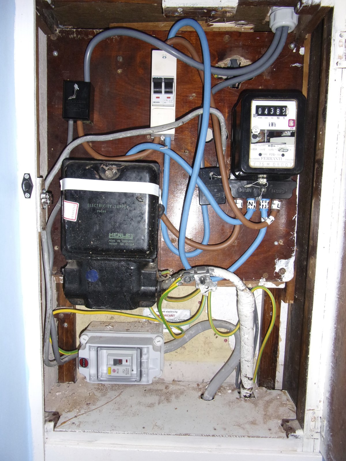

Anyway, after a while he was finished :
Ignore the grey cables, they're mine to sort out in due course. The blue and brown cables are his handywork :ROFLMAO: He said he couldn't get the live cable in the top of the box :unsure:
He did spend rather a lot of time with the seals - he said that he's required to seal everything he "touches", so has sealed the load side of the isolator and the Henleys. But after some time spent fiddling he could not get a wire through the hole on the cutout itself - so put on his notes "sealed with tape". Not that I would ever consider removing that tape :whistle:

Dear god.... The 'after' picture is worse!
I'm assuming it's safe enough but aesthetically it's pure hell. Has that been carried out "in a workmanlike manner"?? (Not that it applies to them....)
I'd be inclined to report the service head to your DNO. Clearly doesn't comply if the seal is a bit of peeling off tape. You might get a nice new head out of the deal.
And yea I'd be tidying that all up at the first opportunity.
I'd be inclined to report the service head to your DNO. Clearly doesn't comply if the seal is a bit of peeling off tape. You might get a nice new head out of the deal. And yea I'd be tidying that all up at the first opportunity.
I'm a bit confused. I rather presume that this 'contractor' who recently fitted the isolator (and created that aesthetic nightmare) was working on behalf of the 'supplier', but I was under the impression that no-one other than the DNO themselves were 'allowed' to touch a metal service head? Is that not the case?

I'm surprised they are prepared to do any work on a metal cutout with uninsulated and not isolable live parts with no IP rating when the cover is open.
Id have thought it'd be a two person team job and probably to replace it

Yea exactly. But because the suppliers fitter was unable to seal it, it doesn’t comply with 24(2) of the ESQCR so needs either sealing or replacing.
Technically the meter fitters report should get passed along to the DNO but in reality, that may not happen for weeks, if at all.
I’m not sure what that particular suppliers procedures are, but he’s worked on it considerably! Those ones don’t look as bad as the ISCO cut outs but I still wouldn’t fancy it
