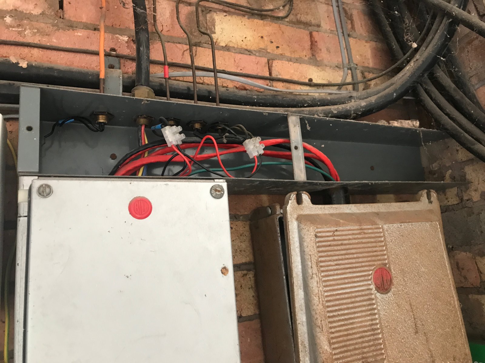

So what do I expect to find in this cutout & having an isolator fitted
Even the after picture is making my eyes bleed :eek:
Isn't it a work of abstract art :mrgreen: Of course I have no intention of moving the isolator and shortening the meter tails to it :whistle: Would have been better if he'd left the meter where it was.
That doesn't look so bad, just needs the trunking lids back on.
I rather presume that this 'contractor' ... was working on behalf of the 'supplier', but I was under the impression that no-one other than the DNO themselves were 'allowed' to touch a metal service head? Is that not the case?
TBH I have no idea who he was working for - supplier or DNO.
I'm surprised they are prepared to do any work on a metal cutout with uninsulated and not isolable live parts with no IP rating when the cover is open.
Id have thought it'd be a two person team job and probably to replace it
It's OK, he used all the safety gear :whistle: Yes, when he'd pulled the fuse out he put a red plastic plug in the live side to prevent inadvertent contact.
Technically the meter fitters report should get passed along to the DNO but in reality, that may not happen for weeks, if at all.
We shall see if anything happens.
One photo does not do it justice. You gotta look closely to fully appreciate it, but there's henley blocks throughout the trunking, no hint of grommet strip or paxolin anywhere, that isolator doesn't shut. Oh and of course there's no lid to put back on. We put a quote in to rectify it but you can imagine the response!

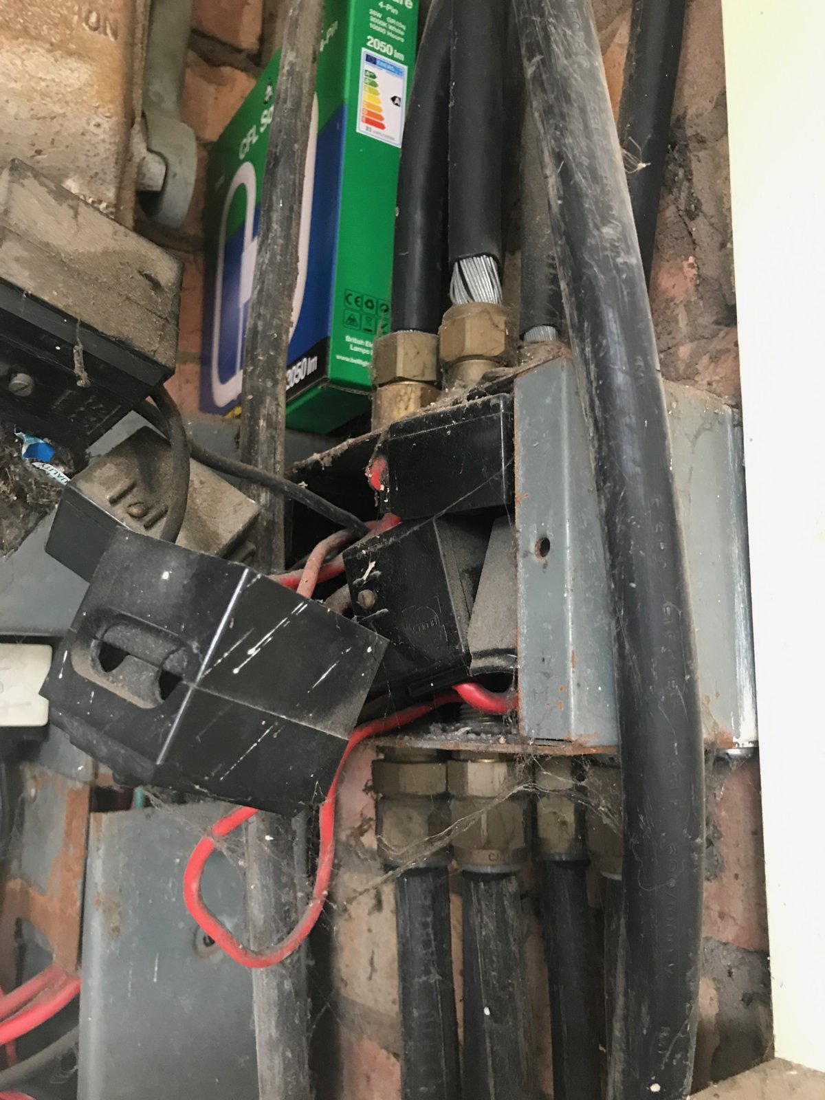

What did he do about the 30mm of bare copper showing underneath the fuse carrier from the PILC? The fuse carrier would be the least of my concern?
And where the hell did he even find that isolator? It's an MEM enclosure (or rip off of), with some other isolator in it. MEM haven't made that isolator for a long time. It's usually Wylex or Proteus now
Not poke his finger in the gap :ROFLMAO:
I had noticed the bare live copper there.
When I zoomed right in on the photo, I did notice a screw (I assume a "lost" terminal screw) lying around on top of the pitch. I just left it there.
I don't think I'd be remotely concerned about the tiny bit of copper showing in the fuseholder compared to that massive amount of cable.
Didn't notice this earlier. The isolator is EATON branded (EMS1001N), dunno about the enclosure but the whole thing came assembled in one box - and with a removable plate for access to the outgoing side terminals only (so I assume the enclosure is made specifically for that application).
Now that you've said it's eaton I can see that it is. They must just be using the same moulding as the old MEM one, which would make sense. It's a cheap as chips enclosure to make, all plastic (and tbh, a bit crap)
