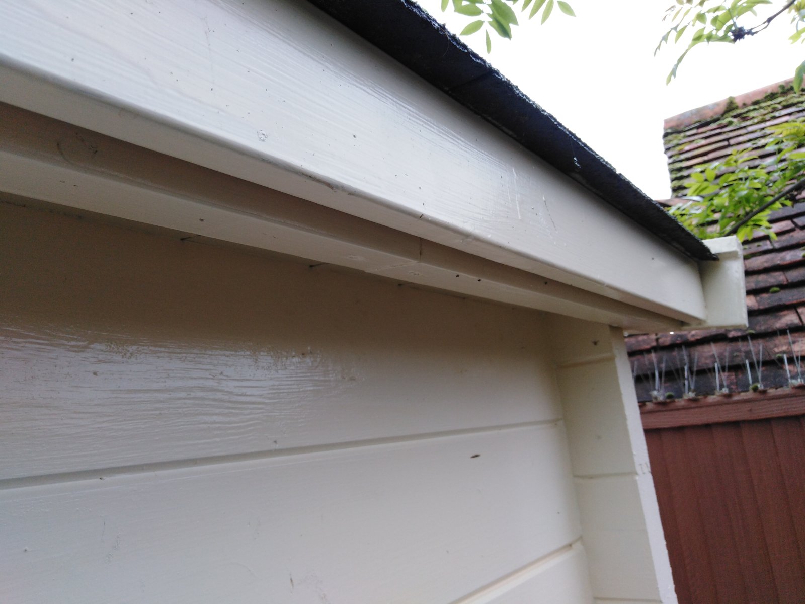

In terms of the other possible causes of the problem that you mention...
The overhang is as pictured, the felt comes approx 2cm off the wood, but there is also a bit of wood overhang between that ant the main wall.
I have recently re-painted it and ran some silicone into the joins on the corner.
The base was dug in to make it as close to ground level as possible, and as the land was slightly sloped some of it is actually below ground level. The sides are dug away though so its not in contact with anything.
What do you mean by base treatment? I don't think I applied any kind of treatment.
I don't suppose that there is anything I can do at this stage if there is something wrong with the base?
