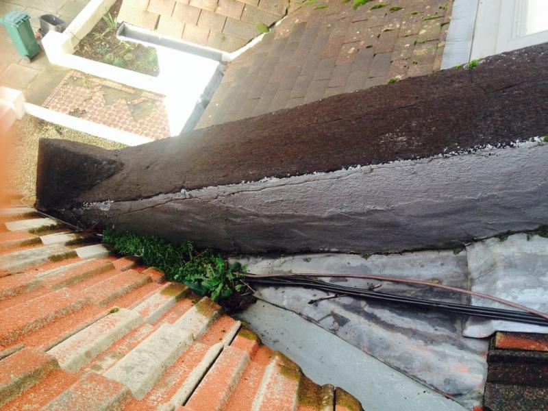

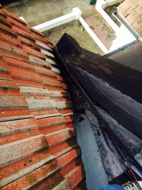

I see the picture now! Your roofs a crap design. Re_do the bottom half of the valley and bring the lead further up the parapet on the bottom
Certainly seems to be a crap design !!!
Basically a roofer told me this morning that soakers and new leadwork is needed alongside the parapet.
Are you saying that the soakers are already in there ?
When you say redo the valley ... can you be more specific ? Tiles / leadwork / lead along the walls / masonry / gutter / drain ?
When you say bring the flashings further up ... not sure what that means ? Does that mean that triangular section should be enlarged ?
One other builder told me that the tiles should go all the way down to the bottom of the triangle rather than stopping 2 feet up ?
Look at the pictures yourself! The tiles at the bottom of valley are pizzing the roof drainage in a vertical against the parapet. There is no soakers on a 49/ludlow plus! So disregard that idiot! Re-cut the valley leaving adequate drainage at the bottom where the roof meets parapet. Top tip.. Stop searching builders and get a roofer in.

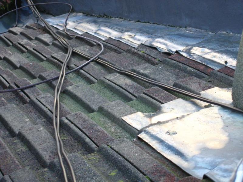

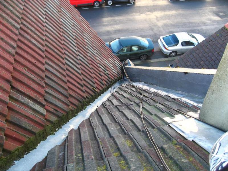

Have you had a look to see what's happening where the tiles are almost hitting the parapet wall (3rd pic, or 4th one where the greenery was) while the hosepipe is running- and ideally with a sprinkler bar to give you a reasonable flow across the roof.
My guess is that the exit for the water in that corner is too small so with any appreciable rainfall the water level will get high enough to overflow the fibreglass/lead valley and penetrate the wall. Plus the water spanking straight off the tiles onto the wall won't be helping.
The cover flashing on the tiles (Pic 1) also looks odd- there should be at least 4" of flashing up the wall and then an inch into the mortar beds as well as the 6" on top of the tiles. If your builder has rendered over the flashing then that's a very strange thing to do.....
And are there any coping stones on top of the parapet wall? Or slates or anything to keep the rain off?
Whoever said best bet= strip and redo is probably right but I reckon if you can improve the water flow through that nasty corner, sort the cover flashing on the tiles and (maybe) set some coping stones/slates on top of the parapet wall you'll solve most of your woes. Putting a 4" downpipe in won't help the water clear if its trying to get through a half inch wide channel from the valley so for me that's probably the critical one- depending on the rainwater simulation above though 'cos I might be completely wrong.....

If the lack of overlap on the tiles isn't causing any problems (if you can see the underside of the roof then again set the hose going and go have a look) then you could leave them be.
From the photos I suspect (might be wrong) that you get water backing up which means it gets above the level of the valley covering (quite likely if the valley is fibreglass- the ones I've seen are quite shallow). Have you tried a good hosing of the roof and see if water builds up in that corner yet? If you are getting water backing up then you HAVE to enlarge the exit route for it- yes a seamless channel is the idea but it has to drain freely.
Soakers- I'm happy to be corrected but I didn't think they worked all that well with profiled tiles. The cover flashing looks wide enough (to cover 2 tile ridges), where i'd be suspicious is if the flashing doesn't continue up the wall- if it doesn't then any water caught on the lead can soak into the masonry.
Coping stones- £4 each sounds cheap til you work out how many you need, bit like ridge tiles! Plus carrying them up to that position won't be fun. You'd probably want a hip iron at the end of the wall (to stop the things sliding off) as well. If its brick I'd be tempted with a mortar bed and some slates. Or go even more low-rent, get a length of fibreglass secret gutter and screw it to the top of the wall upside down- all you're trying to do is stop water ponding on the top and soaking in or running down the wall and soaking in- reduce the time water is in contact with the wall and you reduce how much can soak into it.
