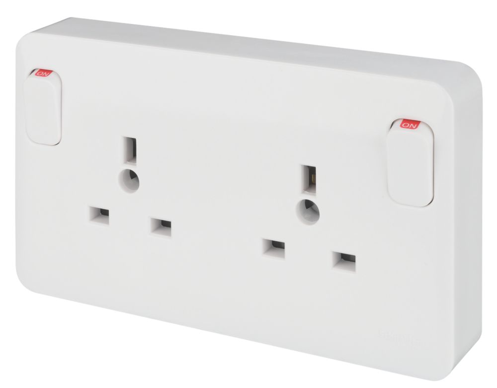

So I've seen these simple socket conversion boxes for a job I need, where I currently only have one socket free for a washing machine and fridge.
Obviously I want to avoid putting both on an extension but wondering if these are adequate? Seems like a glorified extension cable to me. Looks great though if it can simply do the job without the need to chase out and wire in a double. Interested if anyone's used these before?
Thanks,
Will
I wouldn't put two high power appliances on a double socket but I'd think one high power appliance and a fridge would be ok.
I can't see any reason why such a converter socket would be any worse than a regular double socket from the same brand.
The whole socket seems to be rated at 13 amps. Not sure how it adheres to that. Nevertheless, a washing machine and fridge are unlikely to exceed that rating.
It may, or may not be the case that your single socket is part of the ring- on the balance of probability, it may be a spur. Why not loosen the face plate and see if you have single cables or twin sets of cables.
Either way, and I am not an electrician... a single spur feeding a 2 gang socket is, as far as a I am aware, permissible.
