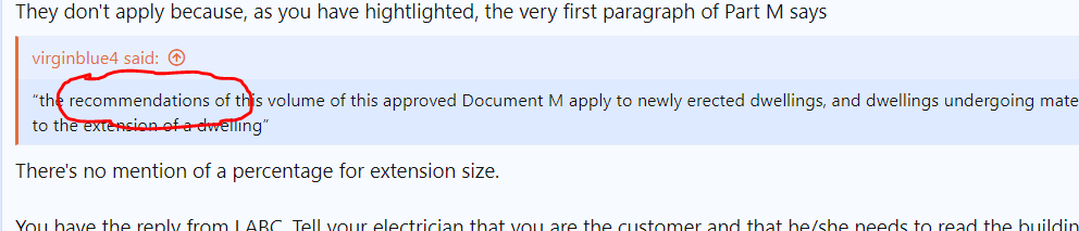

We have having a ground floor single storey extension and the electrician has just installed the sockets. They are around 450mm from the floor level. I queried this with him and he told me it’s the regulations. Having looked into it, I think Part M only applies to new build and not extensions.
This is from the approved Document M
“the recommendations of this volume of this approved Document M apply to newly erected dwellings, and dwellings undergoing material alteration only. They do not apply to the extension of a dwelling”
I emailed my building control officer to ask and his response is
“Technically the height of switches and sockets applies to all new building works, which includes new dwellings and extensions. However I have taken the view previously that if the extension is less than 25% of the floor area of the main dwelling I would accept the switches and sockets at the same height as the existing dwelling.”
Surely this contradicts what the approved document says? I would be happy to follow the guidance but they just look ridiculous!

Also, the socket height requirements are a tiny part of Part M. If the socket heights are a requirement for an extension, then all of the Part M regulations would have to be followed. Like ramps for wheelchair access, extra wide doors, ground floor WC, etc.
They don't apply because, as you have hightlighted, the very first paragraph of Part M says
There's no mention of a percentage for extension size.
You have the reply from LABC. Tell your electrician that you are the customer and that he/she needs to read the building regs.
