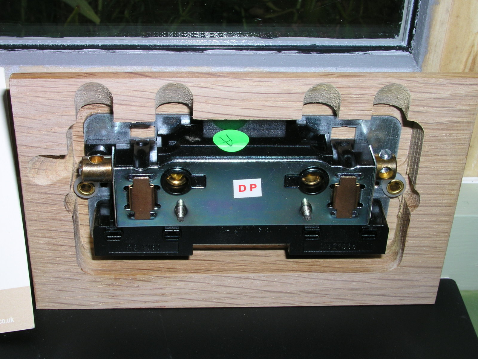

The but, is that the Wandsworth insert is so recessed into the oak fascia that it's impossible to get a screwdriver onto the titchy cable screws without angling it. I can just see burring the screw heads.

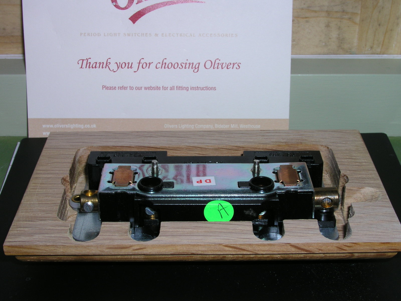

Access, the fascia is already routed out next to the screws, but the insert is so 'low profile' that it site too near the front. If there were a way of altering it, I agree with you, I surely would have done.

Couple of pics.
First one shows no L&N marking, and I looked very carefully for it.
Second shows the screws sunk into the cutaways.

Yes, but on any other socket the driver can be vertical, on this one it has to be at an angle.
Looks like the issue is that they buy something in and then fit it to a fascia that it's not designed for, but does it not have two additional connections on the side to get around the issue?
